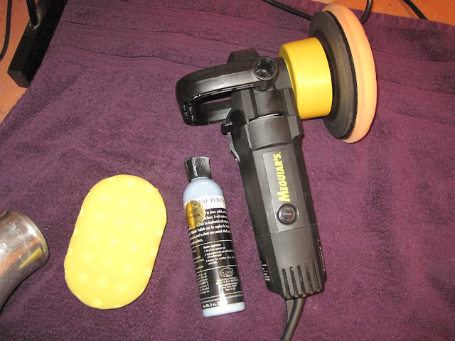

I planned on writing a review on a few different metal polishes and got side tracked with other projects, but I still have all the pictures saved. This thread reminded me of the review so I'll write it asap.
For that section of aluminum I used Optimum Metal Polish with an Orange CCS Pad on a Megs G110V2 and a Yellow CCS Eurofoam Pad by hand for the tight spots. Then I followed with a White CCS Eurofoam Pad with BlackFire Wet Diamond Aluminum Show Polish.
Here are some pics. I'll write the review one of these days. I actually ended up testing these products with a few different tools:
  • Original Formula Wenol (red)
  • Optimum Metal Polish
  • BLACKFIRE Heavy Cut Aluminum Compound
  • BLACKFIRE Fine Cut Aluminum Polish
  • BLACKFIRE Wet Diamond Aluminum Show Polish
  • Wolfgang MetallWerk™ Aluminum Compound
  • Wolfgang MetallWerk™ Fine Aluminum Polish
  • Wolfgang MetallWerk™ Concours Metal Sealant 8 oz.
  • Flitz Metal Polish, Fiberglass & Paint Restorer
Here's a relevant link of me using Wolfgang Metal Polishes on my exhaust: http://www.autogeekonline.net/forum...ol-ball-s100-corrosion-protectant-review.html
Original condition
Test spot with Optimum Metal Polish by hand with a Eurofoam CCS Pad
Via DA Polisher
By Hand
(Before) Here's a section I used with Wolfgang Compound + Polish
(After)

Ray that looks like stainless or chrome.Good job.Why Wolfgangs and not Blackfire (Or is it the same product, just with a different label)?
Thanks! I just use what falls off the truck ;) There are clear differences between all of the metal polishes I listed above. I've got a notebook at home with all of my personal feedback on all the products. I'll write the review asap. :buffing:
