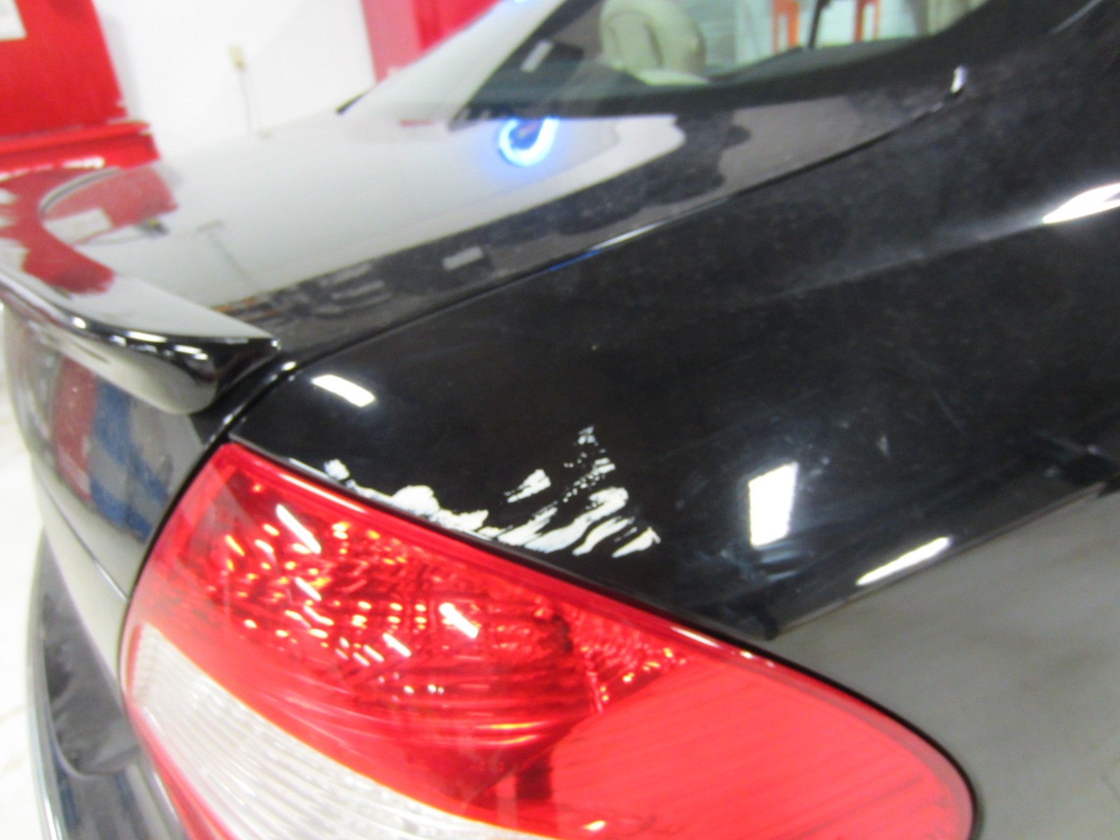

Either of the above will work. However, I must tell you...at some point you will learn to tape the trim and beyond it ever so slightly with tape being on the trim and at least a sixteenth of an inch onto the paint. Why? The gap isn't covered and compound/polish residue will find the gap. Maybe it's not so prevalent of a problem, but try using a rotary with wool a product like M105 while trying to compound paint that is horrible to the edge. The rotary will put that dust in places you didn't even know you had...on the car and on you...that is if the paint is truly horrific. It's less of an issue with foam and slower speeds.
One day, after using a product that dusts like your mother putting baby powder on your Thunderbird, and while perhaps washing your own car or worse yet having to re-wash a customer's car...you're going to start seeing water based compound/polish powder begin to come out and even possibly leave streaks of white all over the paint. It's frustrating as heck to see it, and moreso to remove it. It can continue to show up for months if you don't get the gap covered.
Cover those crevices...by taping the trim off and allowing some trim to stick onto the paint a minute amount to be determined by you. Explain what can happen to the customer and they should understand...or at least make the decision for you to polish all the way to the edge.
If if hasn't happened to you yet, it will...especially if you use certain brands that are known in the forum world to dust like your mother powdering your Thunderbird.
I like to work smart. Taping the gap is smart. Smart is better than lucky any day...unless you win the lottery.
