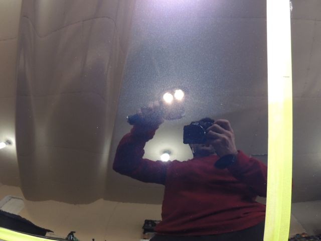

I use various lighting to evaluate... incandescent bulbs in my garage for correction work (not ideal, but it works ok for my personal vehicle) and sunlight for the final finish. After 20 hours of correction and polishing, the car looks good. Especially since it's 15 years old and I've only owned it for a little over a year. There are only a few marks that I know I can't remove along with a couple very small dings. It's a very clean '10 foot' vehicle. Which is what makes me want to try and get that final gleam from jeweling. So close, and yet so far!
Right now I have 3 coats of Pinnacle Souveran on it. I realize it's not the recommended wax for silver paint but I was hoping to get some good depth from it. It helped, but not as much as I wanted. I might strip it off in a week or two and try the jeweling method oldmodman uses. Basically, low and slow.
