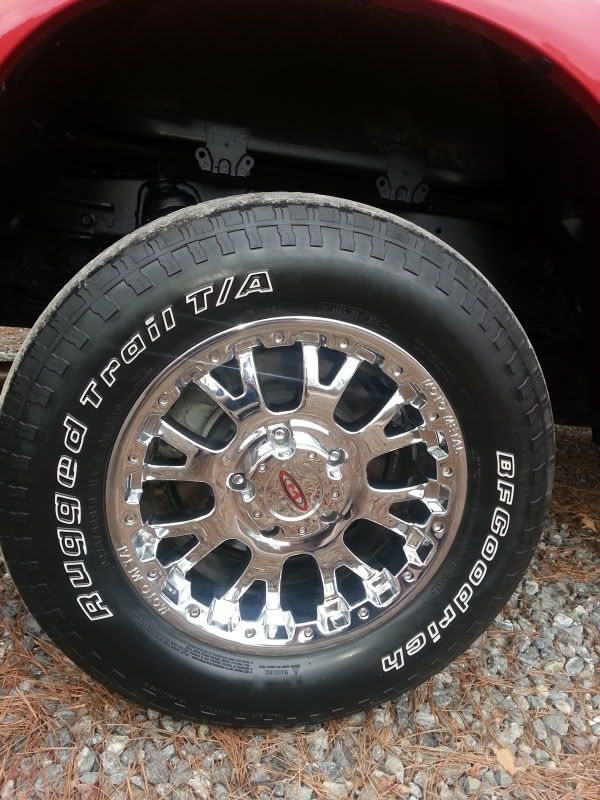

These are my wheels.
Now I am not trying to hijack your thread at all but I was considering the Flitz ball but wow it is like 30 or 40 bucks!?!
I am like you and hoping someone has some experience with these tools chimes in.
