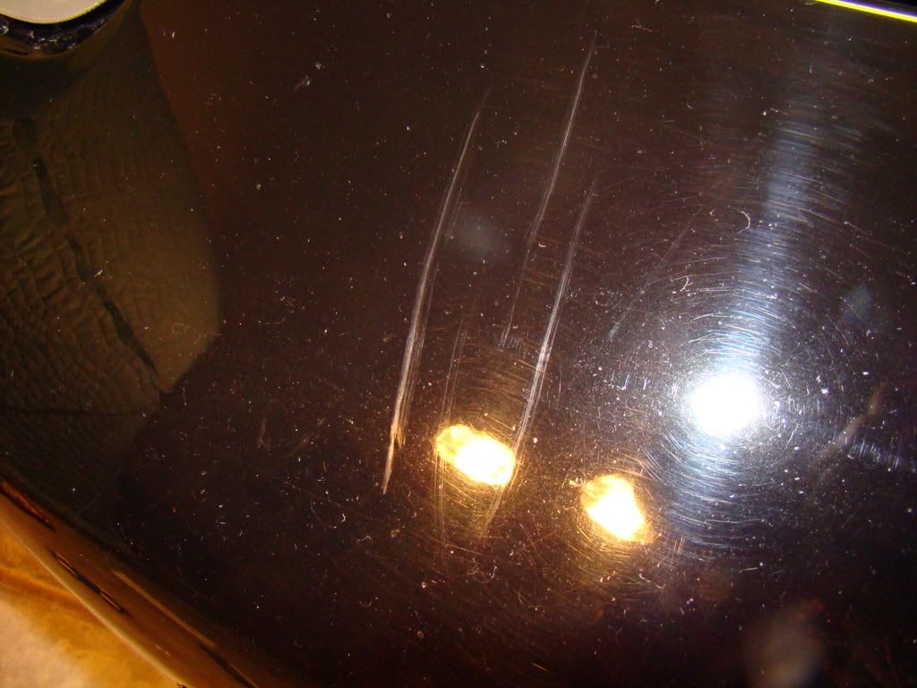

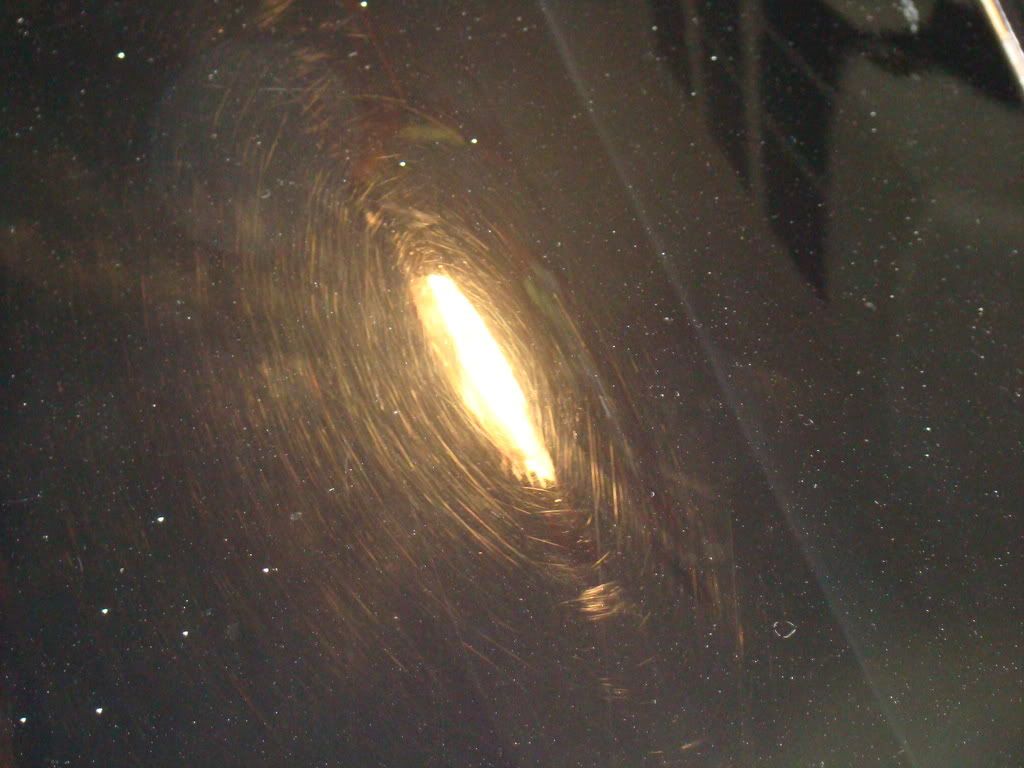

Scratch before
Scratch after

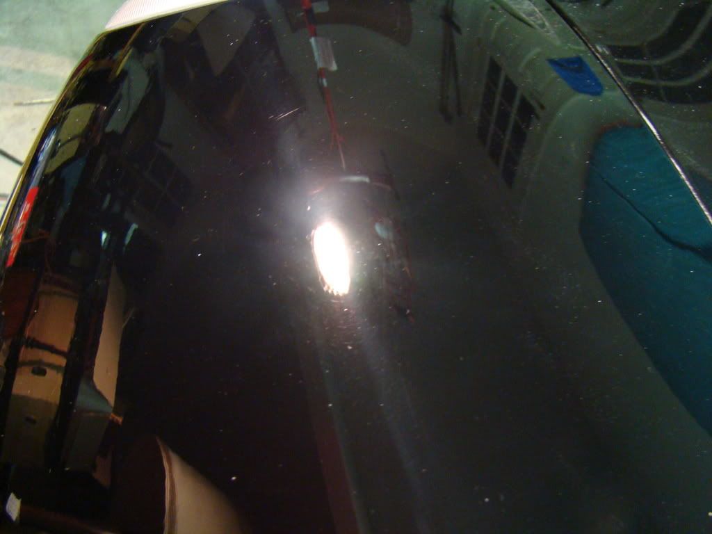

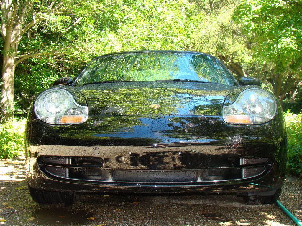

After shots

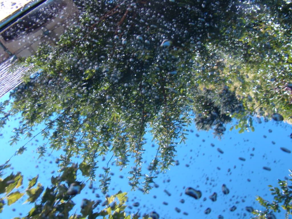

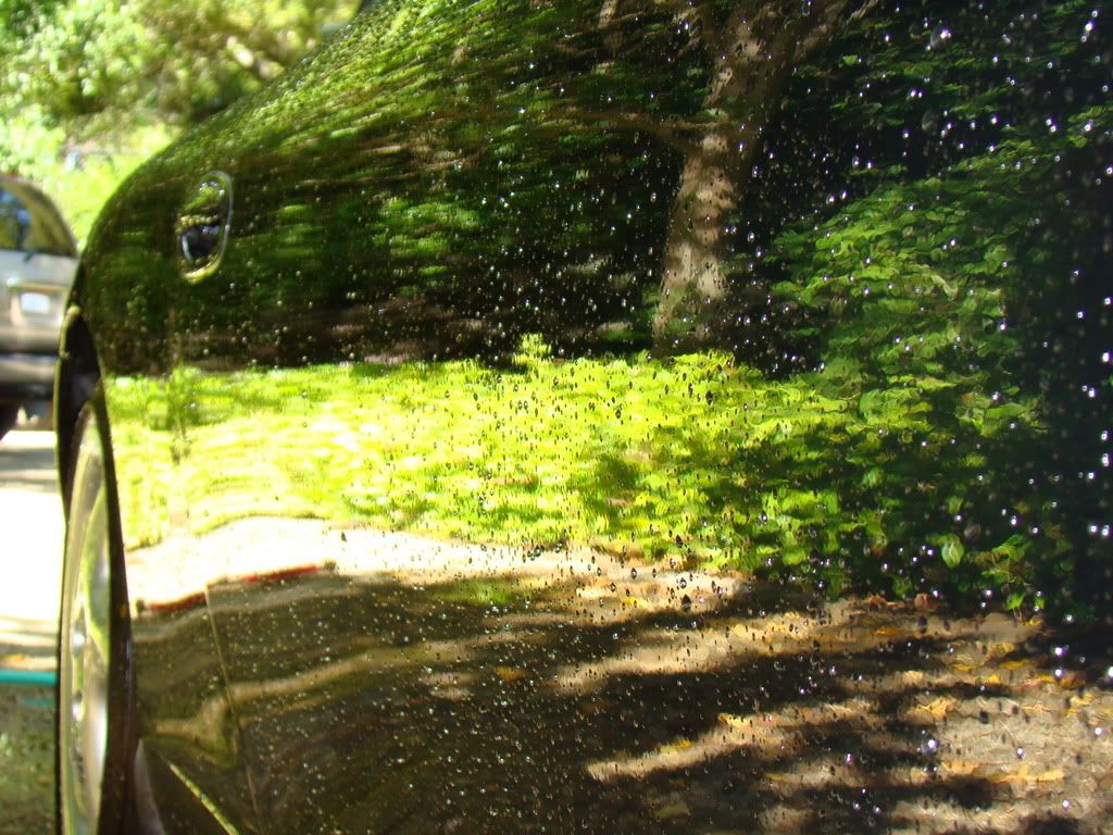

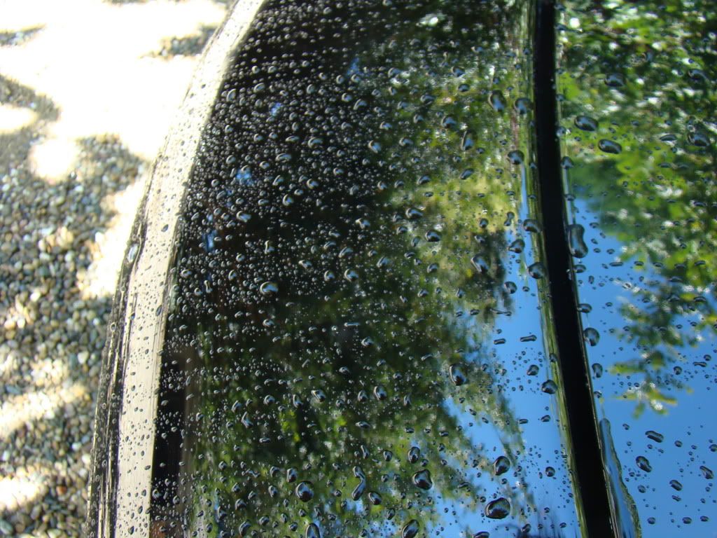

Beading
Beading 2
Beading 3

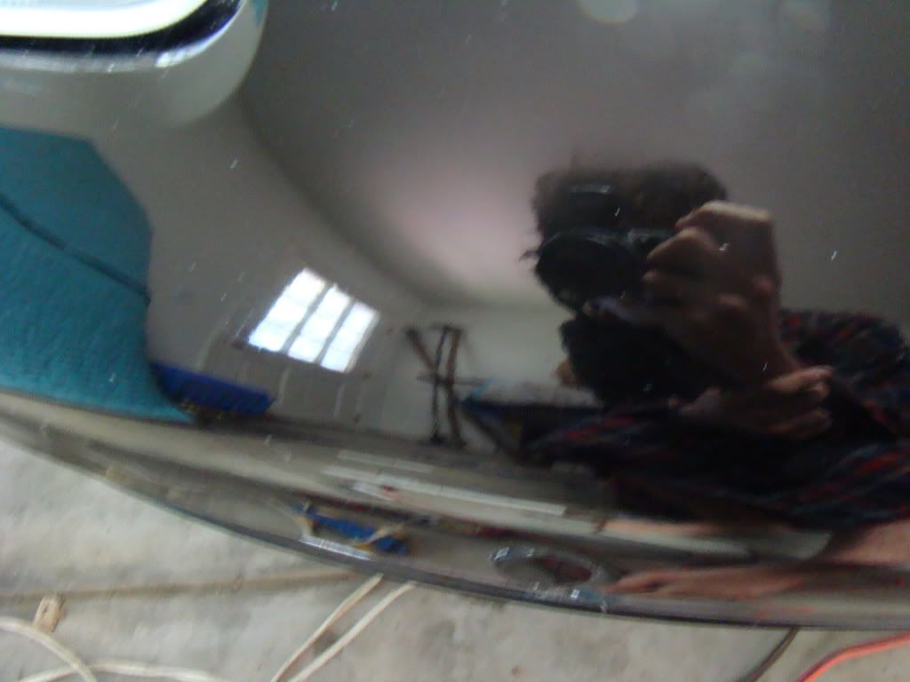

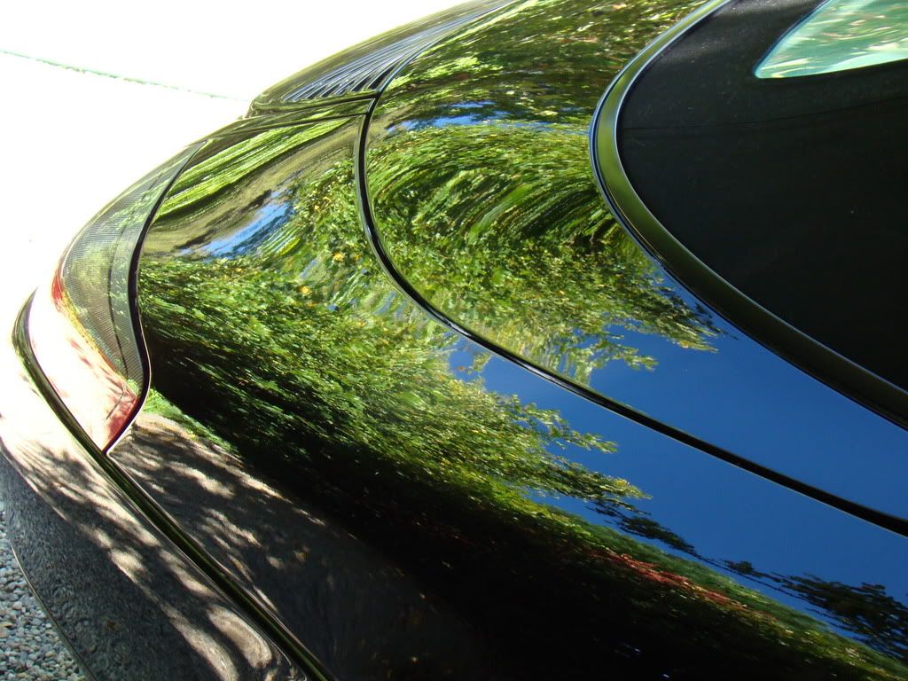

Reflection shots:

Conclusion: The car looked good in the shade but when brought in to the sun this vampire of a car showed many imperfections. I am not pleased with the out come of this car, there are still defects in the paint that did not come out or that were not hidden by the glaze or wax.

How long after the detail did you do take the beading shots? I think LS has some polymers (if I remember correctly) so it might affect the durability.

Correct, LS contains polymers, i waited about 12-14hrs before anything touched the paint. Yes i have heard that adding other polishes or glazes will extend the working time but i feel that it should be menzernas' job to make a polish that has a good working time not my job. Also the large particals in the nano make me think something is fishy.
