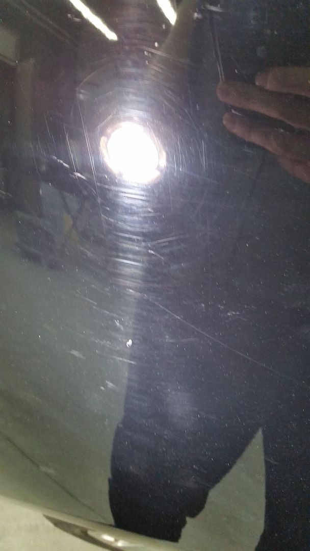

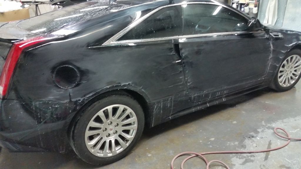

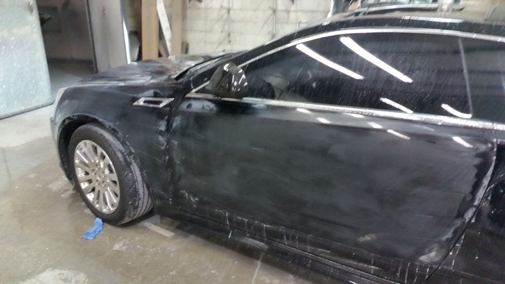

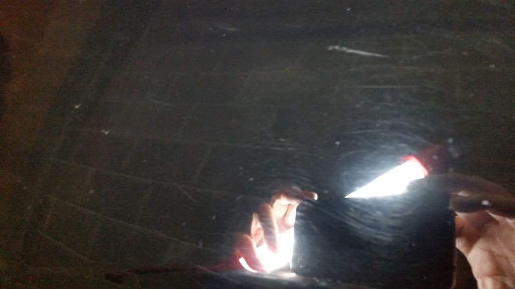

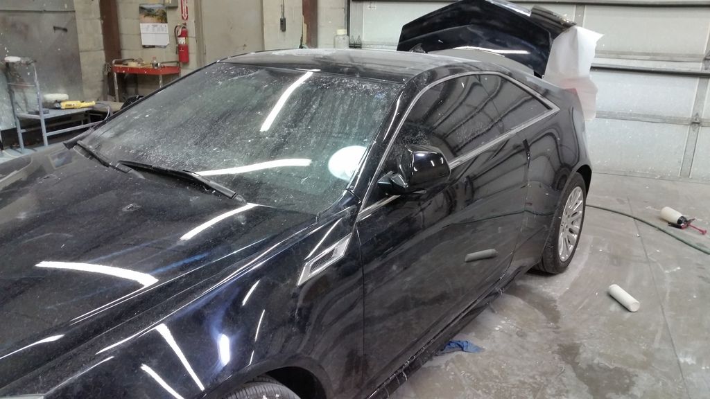

Well! I am about 80% done with my 80% detail (thank god)! Started around 8:30 this morning and left the shop around 3:15-3:30pm. Thursday and Friday I washed, clayed and Iron-X'd so I wouldn't have to waste time doing it today.
Started off with a quick wash and sanded every panel with 2000 grit paper. It seems as if the previous owner let rheir five year old touch up the vehicle so I blocked all of that down too. Followed 2000 with 3000 with a hard DA sander.
Buffed in 4 steps.
1. 3M Perfect-It Low Linting 9 Inch Wool Pad - 33279
2. 3M Perfect-It Plus Foam Compounding Pad 8 inches - 05737
3. 3M Perfect-It Plus Foam Polishing Pad 8 inches - 05738
4. 3M Perfect-It Plus Ultrafina Foam Polishing Pad 8 inches - 05733
1. 3M Perfect-It EX Rubbing Compound 32 oz. - 36060
2. 3M Perfect-It 3000 Rubbing Compound 16 oz. - 39060
3. 3M Perfect-It 3000 Machine Polish Swirl Mark Remover 16 oz. - 39061
4. 3M Perfect-It 3000 Ultrafine Machine Polish 16 oz. - 39062
Here's a cringe photo for every one who masks meticulously!
Came home and applied Wolfgang Perfekt Finish Paint Prep followed with Wolfgang Deep Gloss Paint Sealant. Currently waiting the 45 mins to buff! Damn my back hurts!:buffing:Im the MAN
After my over night Wolfgang Sealen cure if have to say it's definitely worth the money! Actually got to see the car in the sun today. That sealen really adds a nice wet look. Done untill spring!
