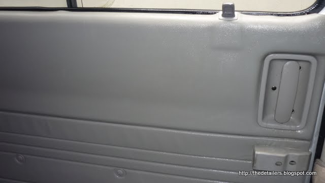

interior - sliding door before
after MPC...& brushing
dash board before.... slimmy ...... slippery..most of all oily...suspecting from local consumer grade dash board dressing board ...aka tyre shine...long white sleeves would had some stains from it
