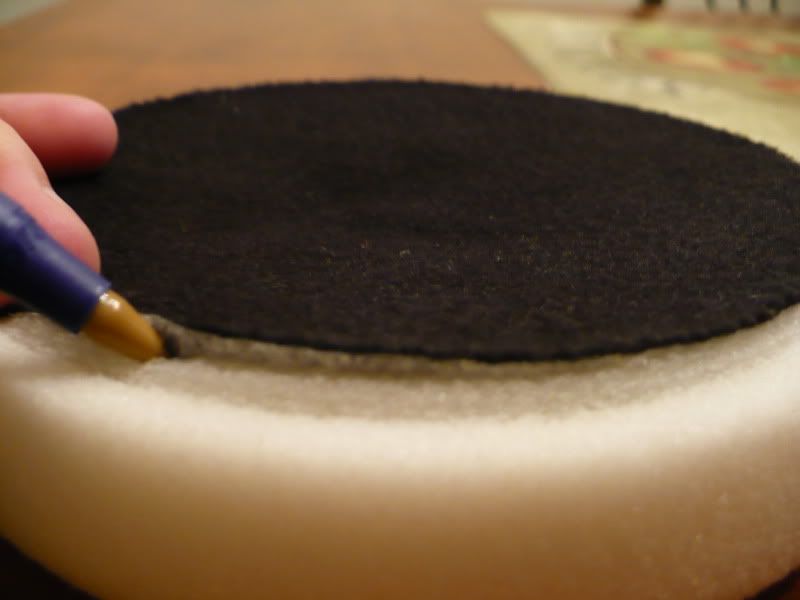

Hi,
I wanted to know if my pad is still good.look of center of pad is hollow and it is soft a bit.I think I waited too long to change the pad was saturated with wax?
What do you think?
If the velcro is still glued to the foam, the foam is not torn, shredded, or is missing chunks, I wouldn't trip. Keep running it, (after you wash it first that is).

The surface is not broken it just hollow Of The center and has little soft compared to the rest of pad.the Velcro is broken just a place a little.
That's called wear-n-tear... it's normal, pads don't stay looking like they are brand new after you use them.
Normally your wax pads shouldn't become saturated with wax unless you're using a one-step cleaner wax over an entire car.
If you're applying a finishing wax then cut down on the amount of wax you're using.
What speed are you running the polisher?
I do as you suggested me, I did a One Step / cleaner with M06 and a polishing pad.I running my PC has 6 speed and I make 4 passes by section with a very light pressure. I think I too Waited Before changing pad to a fresh clean pad.

I've seen this happen to others and even myself on one occasion. Over saturation and excess heat seem to be the root cause. I'd suggest changing you pads more often to avoid this from happening. The foam in the center seems to break down from the heat and IMO the pads are shot at this point. I will typically use 4 pads per product step on an average sized car. ;)

The pad I have which caved in like yours is no longer flat when placed on the paint, so at that point I do not feel it should be used any longer. Not sure if you will see any negative effect from using it or not, but I would imagine that any polish that moved towards the center of the pad would break down at a slower rate then the polish at the outer edge of the pads....better safe than sorry IMO. ;)
I would think it would be just fine for applying wax. I wouldn't use it for polishing though.
looks like you just used it too long in that session or are using too much pressure with the buffer - heat transfers directly from the drivetrain to the backing plate to the pad and will disintegrate the foam right under the center of the velcro, making it cave in and feel soft like that. if you cut that pad open it'll issue a ton of little foam confetti bits. DO NOT EAT THEM!

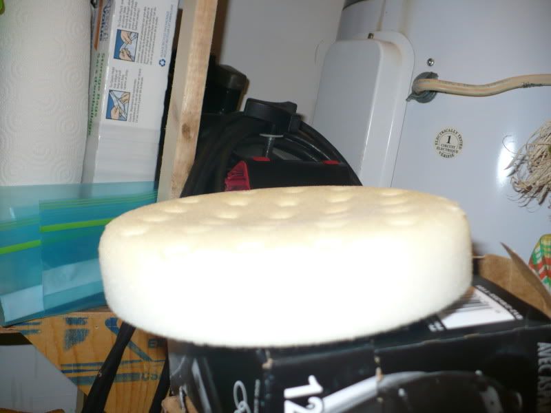

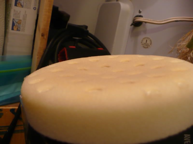

Mike, it was a brand new pad. Used it once and that's how it turned out.
