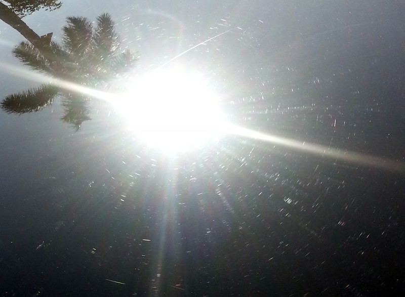

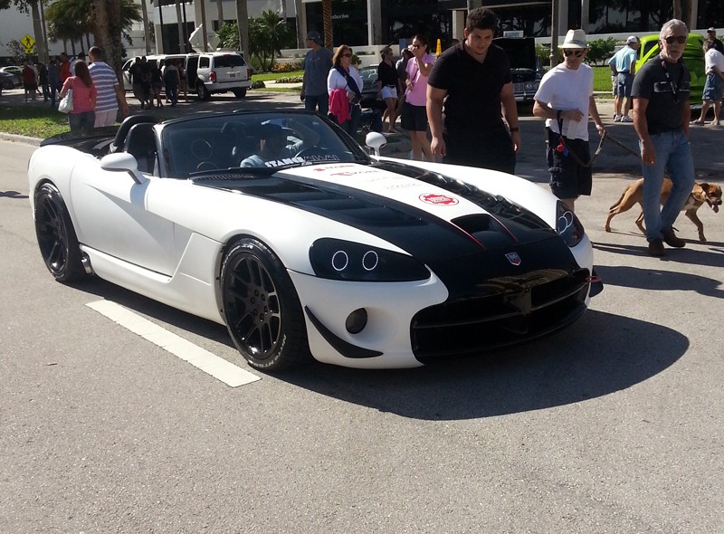

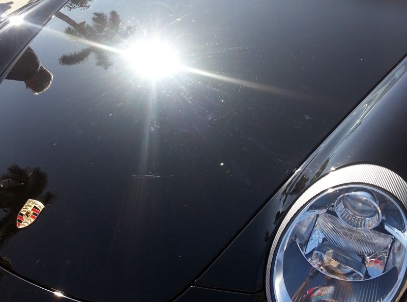

I apply all my waxes and sealants by machine. I use my Rupes Mini with a 3.5 inch pad so I can get into the smaller spaces, it generally takes me about 20 minutes to do a medium sized vehicle. The benefit of the machine is you get a nice thin even coverage and you don't use a lot of product. I use a mini butter spatula to "butter" the pad when using nubas. You can do this on 5" pad or large etc. too.
I have all the Dodo Dodo waxes, they are high quality and excellent products.
Here's an example using a sealant.

Looks great. Really shines. I also usually use my 3 inch pads for waxing as well.

Boy, I love it when you post those pics. Delicious white.
