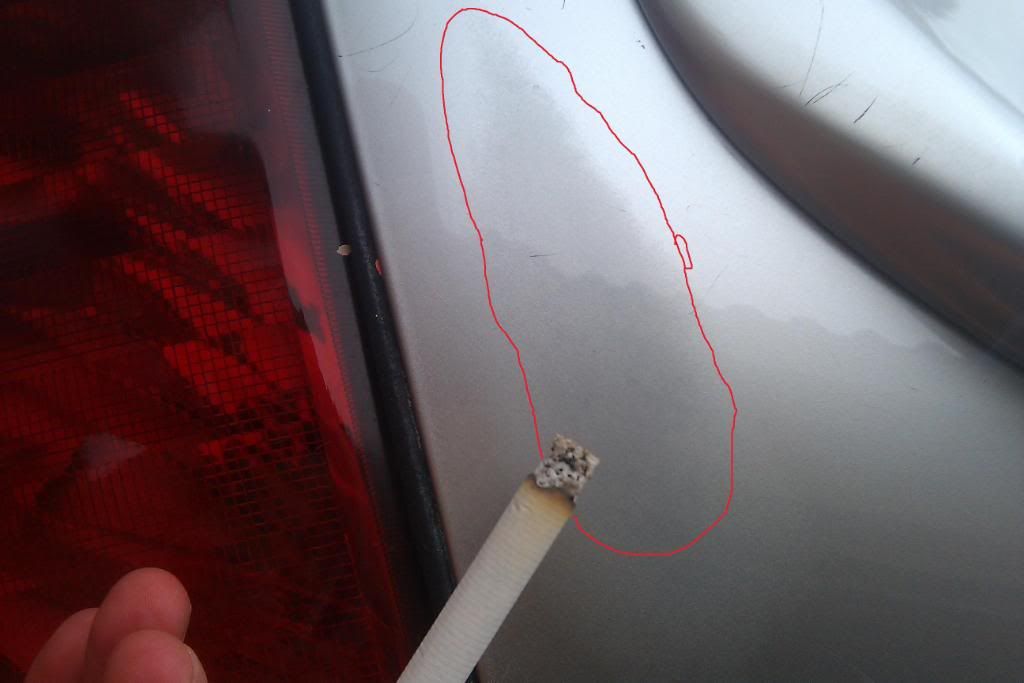

Seems like he burned this part of the clear where the cig is pointing at. This car has a tinted clear coat.

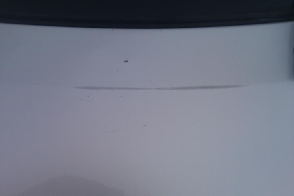

heres a raised body line on the rear hatch of the car apparently he was trying to get some scratches out of there which were still left behind and he burned the paint. The client ASKED me what it meant when someone burns through the paint, my response was A NEW PAINT JOB!

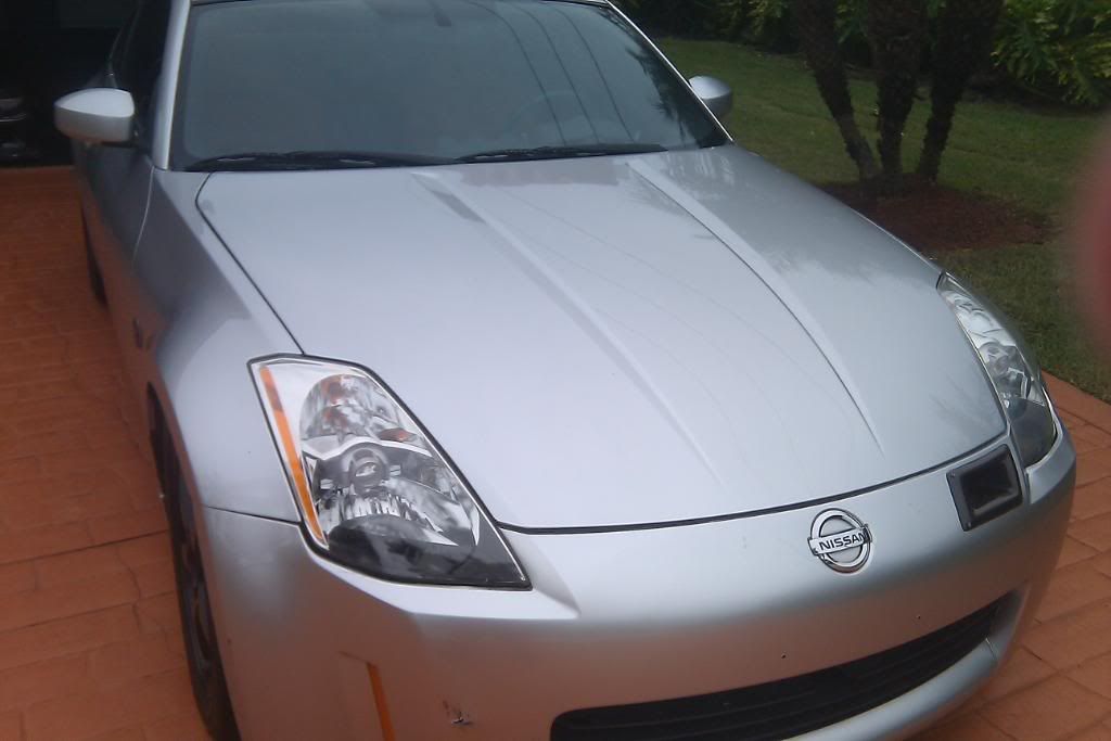

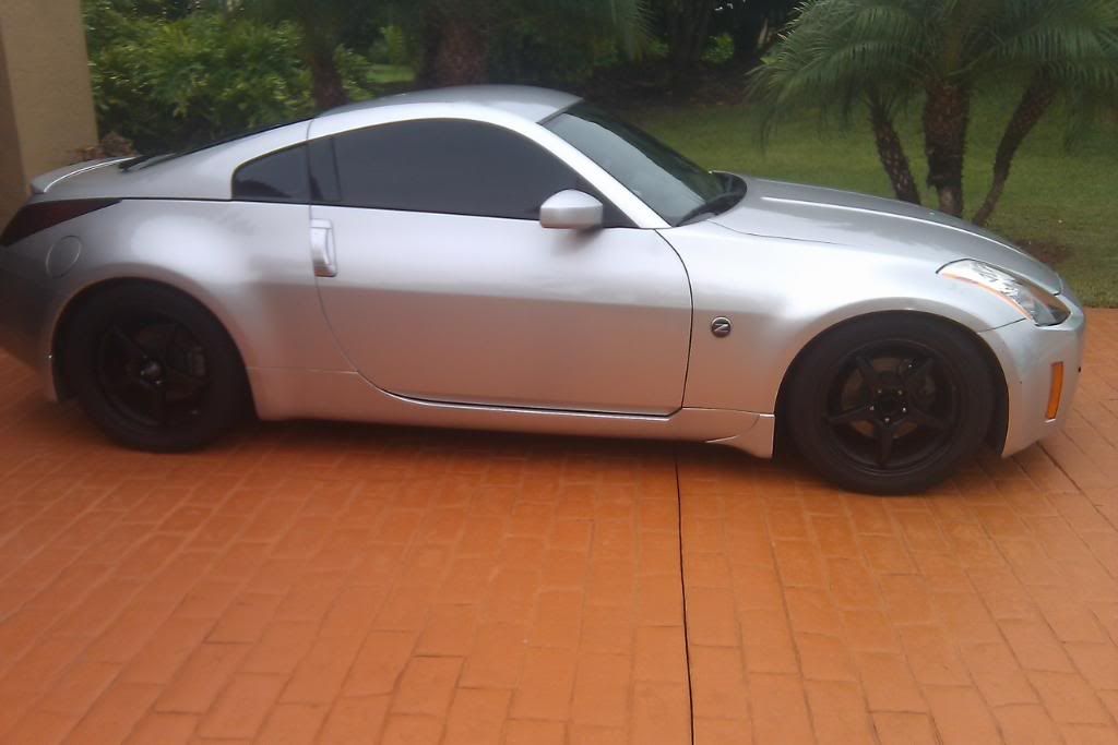

heres the car finished no tire shine. I washed it, clayed certain areas though the entire car needed it, removed that orange colored writing that said for sale PITA, wet sanded the entire hood ,compound, polish and wetsanded only one head light thats all he wanted as well with some spot sanding on the rear hatch which I had to mention to him that its already screwed up on the raised body line and im not going to go over that. WHICH IS WHY I TOOK A PICTURE WITH HIS PHONE AND EMAILED IT TO MYSELF . He was selling the car and all the buyer wanted was a new hood, and a front bumper. The bumper was in a accident and it was cracked everywhere so he was going to buy a new front bumper anyways so i didnt touch it.
