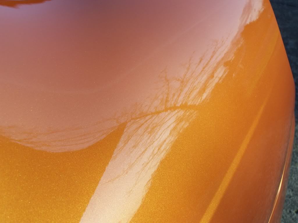

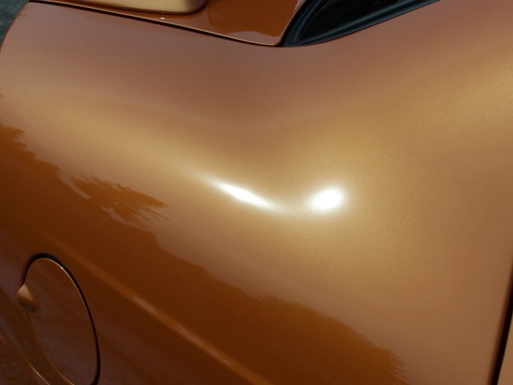

Hello all, I have been searching over old threads that contain "pearl" in the title. The only threads I could find contained black, blue, and white pearl coats. Can anyone give me a suggestion on what to lay down on Dodge's Orange Blast Pearl paint? I am looking for something that will make a deep wet look, and also help with the color shift that the paint does in sunlight. My camera doesnt pick it up real well, but the paint has a subtle light sparkle in it. Another question I have.....does anyone have experience with this color? Is this paint considered a hard or soft paint?
Sparkle with color shift
sun shot
shade shot with sparkle in paint

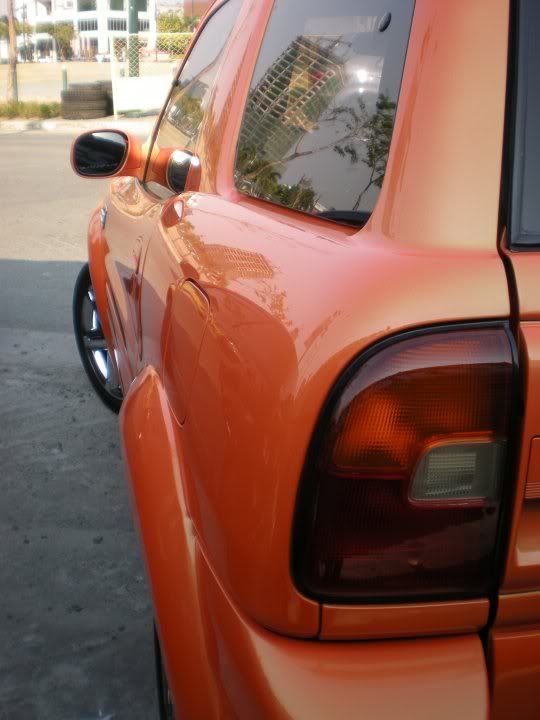

This one picks up the color change a little bit. The corner of the bumper appears to be a brighter color.

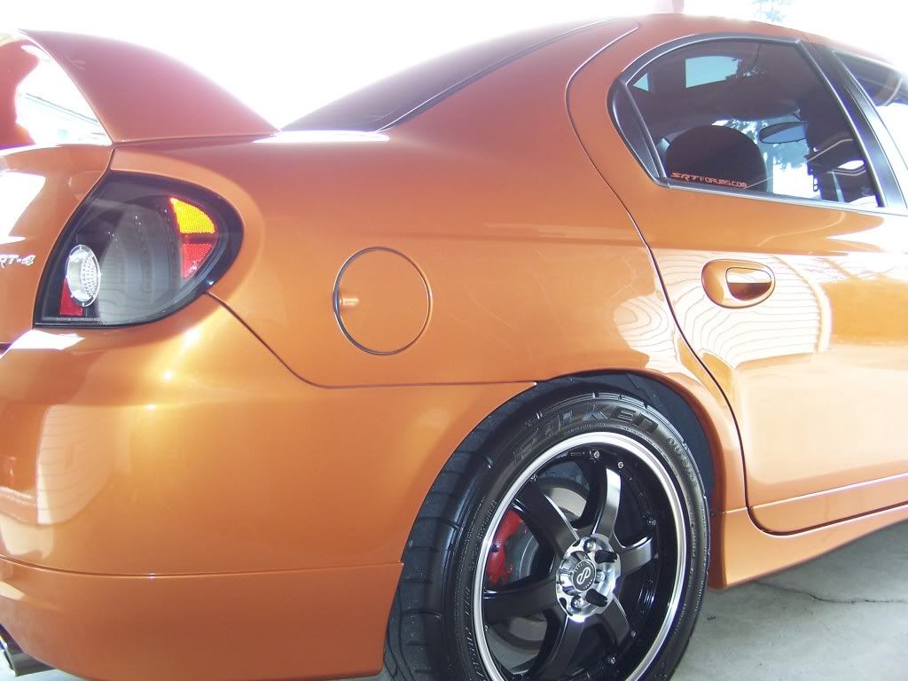

thanks for the reply. I already have the Pinnacle twins, I will have to try out the M105/205 combo to see if it gets those swirls out easier than the pinnacle. As for the deepness of his paint, I think mine might already appear to be a little deeper. its hard to tell when looking at pictures though. I will find a shade pic to compare.
After looking again, the shots of his hood look really deap from what I have seen of this color. this is what I am after.. Will Pinnacle SS-II acheive results like this?
