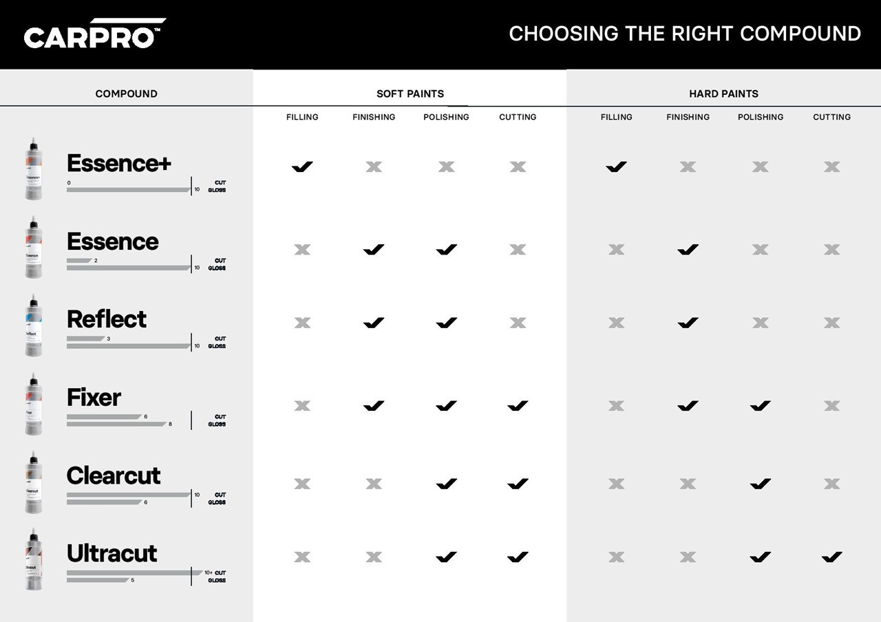

Reflect vs Essence -
Carpro Reflect and Essence share the same abrasive package, which means a rapidly diminishing formula for mild correction and high gloss finishes. Where Reflect is a pure polish, Essence contains an Si02 additive. In days of old, Essence would have been called an all-in-one, they now call it a “primer” polish.
The Si02 content in Essence helps provide mild filling properties, which in theory means you don’t have to chase each and every scratch. Essence will also prime the surface prior to the application of a coating to apparently improve bonding. In that regard, Carpro suggest Essence can be used prior to all of their coatings and spray sealants such as Reload and Hydr02. You can also use Essence as a standalone protectant, just don’t expect miracles in terms of durability.
While there are differences, both Reflect and Essence are the stupid-easy to play with, be that during the working phase, the easy wipe off or the complete lack of dusting. I’ve also found them useful in cleaning up that scratch prone gloss black trim that has become so popular. So, which you choose will ultimately depend on what you want or need to achieve. In my case, if I’m going to apply something ceramic, I’ll finish with Essence. If I’m doing an old-fashioned wax or synthetic sealant, then I’d go with Reflect.
