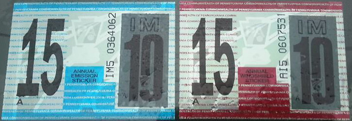

The state of Pennsylvania has inspection stickers required to be placed on the inside of the windshields. After some research I bought a plastic razor blade/scraper combo and am having a very hard time getting the sticker off. I soaked the sticker back with a damp towel, but it did not help much. The sticker appears to be a combination of plastic, foil, and a strong adhesive with a paper backing and much of the paper backing has come off and the plastic blade is not catching on the remains of the the sticker. Here is a picture from google images of the same stickers I have on my car.
Are there any products or processes you recommend to safely remove the sticker?? Any help or direction is greatly appreciated. Thanks.

Since you're working with glass, forget the plastic razors and go with real razor blades. You can get a mounting holder for the razor blade that will make it easy to work with like a scraper.
Gingerly (don't go willy nilly) apply goo be gone to the sticker. Let it dwell for a few minutes then start working it with the razor blade. Repeat as necessary.
Remember to keep the towel or plastic on the dash as to avoid getting the goo be gone on the dash to prevent any discoloration.
Windex will work as well, but Goo Be Gone or goo gone will work better.

I've always had great success using Stoner Xenit on stubborn stickers. This citrus-based aerosol degreaser will remove just about anything. Saturate the stickers with this product and let it dwell for 10-15 minutes, then scrape off using a metal razor blade. Be careful.
As a precautionary step I would place a few microfiber towels on the dash to protect from over spray.

Thank you for the quick replies. Just to be sure, a metal razor blade is safe to use on the inside of the windshield?
Just worried about scratching the glass with the edge of the blade. The glass curves and is not flat under the sticker.

Unless the glass is tinted, then yes a steel razor is perfectly safe if used properly. If you feel more comfortable with a plastic razor blade that's fine too, it will just take longer.

Those aren't stickers,there like a combination of paper and foil.good advice on the product.
I was a New York State auto inspector. I allways used a metal razor blade on a long handled holder and 2 swipes of the sticker and your done . I must have removed at least a 1000 of them that way and never had an issue. It took maybe 5 seconds to remove and 0 chemicals!
I live in PA, and to be honest the stickers are terrible, give it 3 weeks and it will be peeling off on its own. Mine never last a full year without having to press the corners back down
