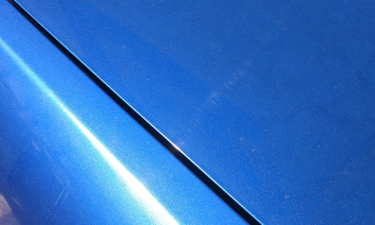

Before I buy the material, just wanted to show what I am trying to fix. (Apologies for the delay in getting the pictures)

The BLACKFIRE One Step and the 3D Speed are the same type of product, so pick one. Both work great. In most cases, both must be ordred online.
The only one-step cleaner/wax that I know of at a retail store that can be used "effectively" by hand would be maybe ColorX by Meguiar's but I don't know if they even make this. My recent experience is the BF One Step and the 3D Speed are currently still the top performing one-steps on the market.
If working by hand - you need EVERYTHING working for you. So pick one and go with it.
As for the Klasse products? If you use either the BF One Step or the 3D Speed you won't need the Klasse AIO. These three products are the same type of product it's just the BF One Step and the 3D Speed will actually remove swirls whereas the Klasse AIO will not. It would be redundant to use Klasse AIO after either of the other two products.
After using either of the two one-steps, then you could apply the Klasse Sealant Glaze. I would either skip this step and just reapply whichever cleaner/wax you choose to the horizontal surfaces on a regular basis, like 2-3 times a year. (each time you do this by hand you will remove the swirls and improve the paint), or get the BLACKFIRE BlackIce Sealant to top the BF One Step or the 3D Poxy to top the 3D Speed.
