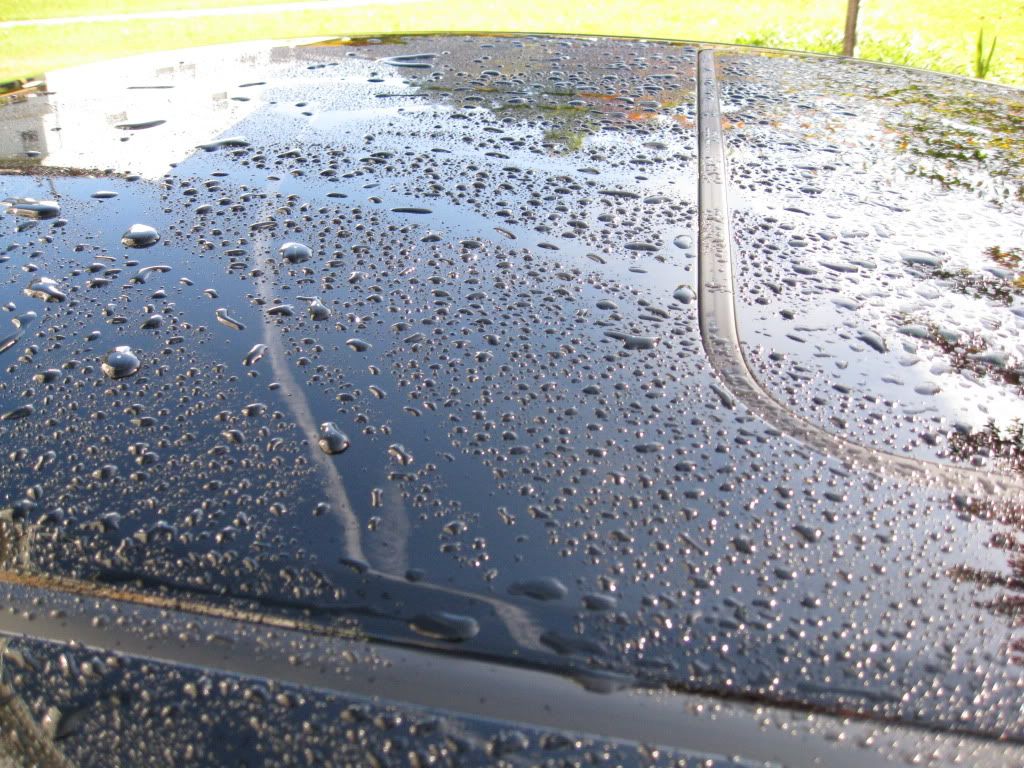

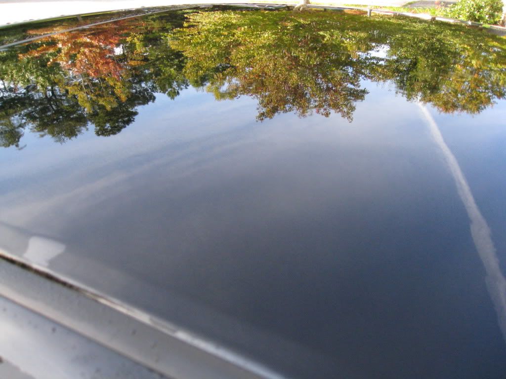

I am getting ready to write a review on the Griot's Garage Paint Prep. I had a previous LSP of Swissvax Concorso and claying and washing in a dawn/meg's gold class mix did NOT remove all of the LSP. The Griot's Garage did! Here's a pic...
After claying and dawn/meg's wash, before paint prep:
After paint prep and rinse with pressure washer:

You are correct. The Pre-wax cleanser is for removing the polishing oils and fillers left behind from polishing, allowing for a true paint surface that is ready for an LSP. The paint prep, as you can see, works great. I will get this stuff each and every time I go to do "the big one" on my car-meaning machine polish and wax. Its cheap too...a bottle will last you. I had alot left over.
Thanks Alex. I have been wondering the same thing. Since I followed the same process you did to strip, with the same results, looked like I had waxed it the day before! I just added both the Paint Prep and Pre-Wax cleaner to my cart!
