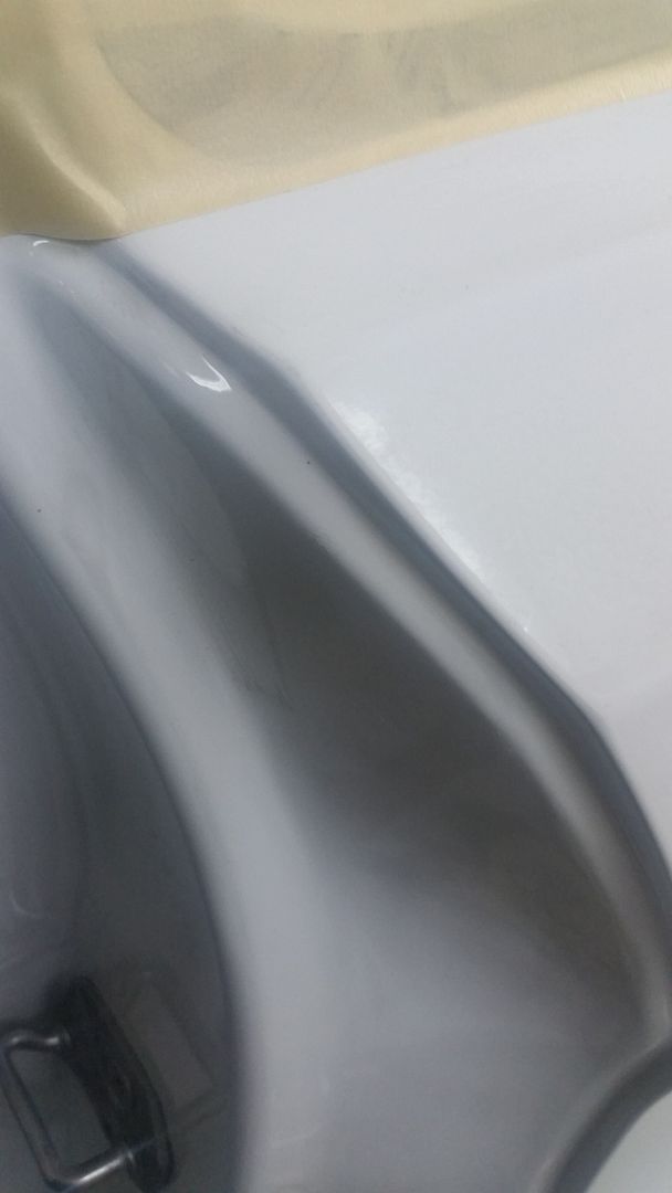

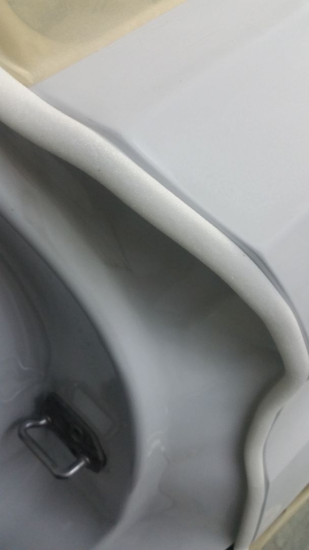

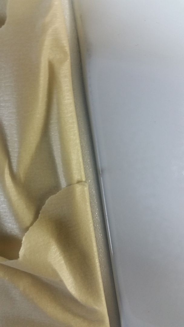

Most cars have a 1/4" to 1/2" bodyline inside of the door jamb to allow the inner shell and outer skin of the door to sit flush with the 1/4 panel. Most quality body shops will use a "foam" tape along this inner body line to reduce overspray from leaving a hard tape line in the jamb. In your particular case the repair to your vehicle will only have color in the pillar and clear only on the rest of the 1/4. Being only clear, this tape will most likely not leave a paint line. Also, if you do notice a faint tape line, the painter can go back and re-clear just that bodyline by wet sanding, "back taping" and clearing that small portion of the jamb. I do this multiple times a week with fantastic results. Just as a disclaimer I would like to say keeping your oem finish is always the best possible route if the defect is something you can live with.

I think I get what you mean about the 1/4" to 1/2" bodyline inside the door jam. Seems like that rubber trim above the driver window will leave a shop cut-off line though. At the base of the door, there is more of a gap for the clear coat to enter and lay down more gradually. I don't understand how they partially reclear that bodyline in the door jam with the door shut against the A-pillar. Such a nightmare.
The last picture shows the door closed and the gap between the foam tape and the 1/4. I will try and remember to get a finished photo tomorrow.
Wow, that is awesome. Thanks for posting the pics 7PaintGuns! Does that work similarly for front doors? That seal above the driver's window that goes against the painted door pillar looks like too sharp of a cut-off to do something like that.
