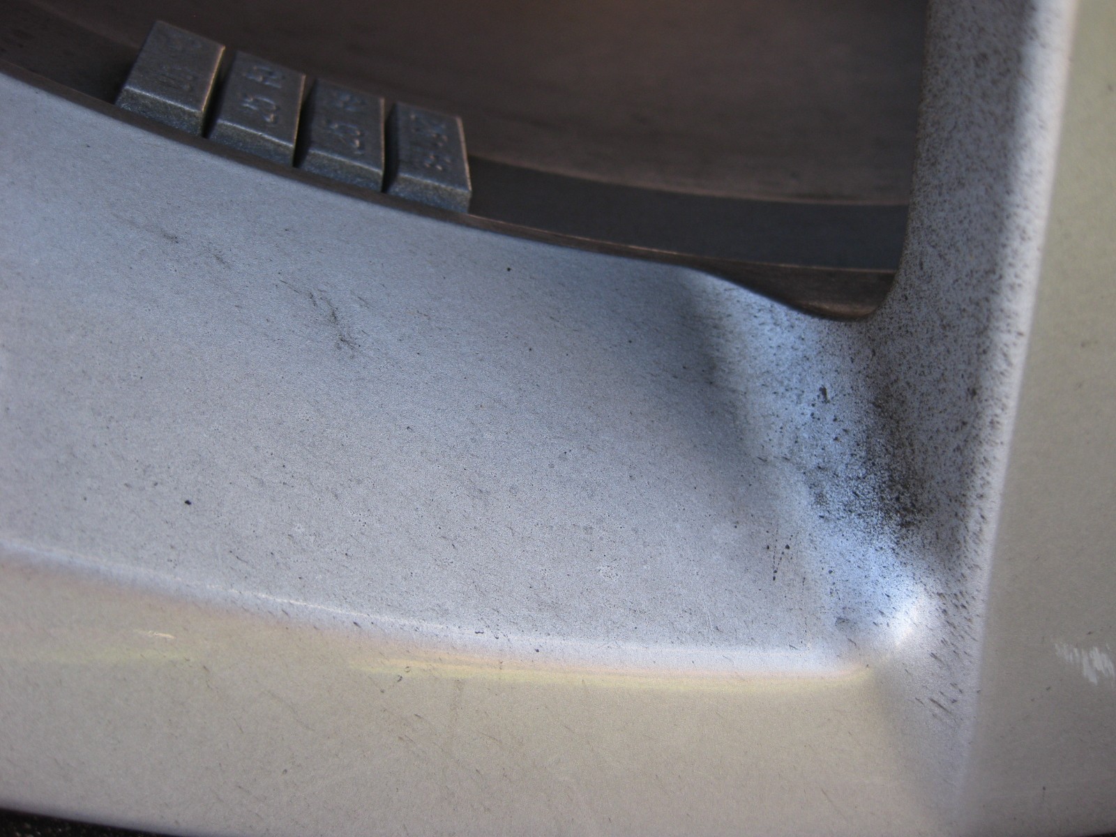

The car I did in the photo I did not clay the hole car only parts that were not bad
