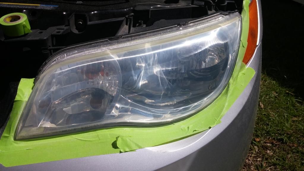

Step 1 is to tape up the surrounding surfaces. The kit comes with 25ft of tape, plenty to do 2-3 layers. Also clean off the headlamp of any dirt/debris.
Before after taping up:

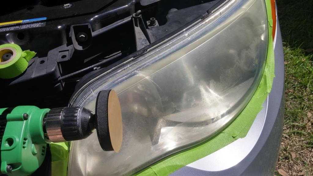

Step 2 is to begin sanding the headlights. Attach the backing plate to the drill and use the ‘yellow’ discs (P500 grit sandpaper). Using slow, steady, and light pressure I sanded the headlight. I used two discs per headlamp and cleaned the sandpaper often during the process.

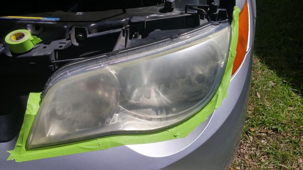

Step 3 is to sand more, this time with the white discs (P800 grit sandpaper). The same process was followed as in step 2. Again during this step I used two discs per headlamp.
After sanding with P800

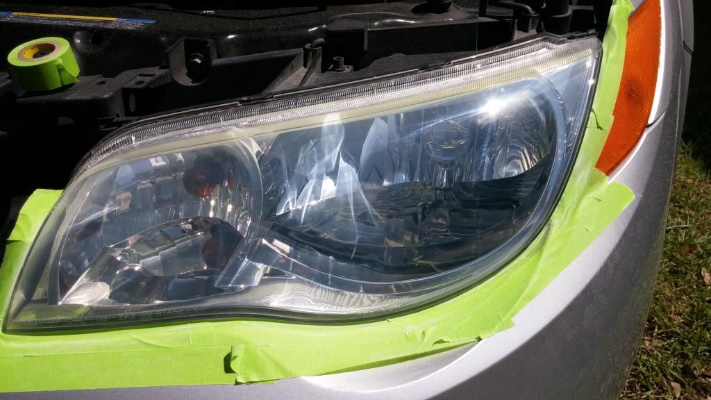

Step 5 is to use the orange foam compounding pad with the included Headlight lens polish. During this step you apply a dime sized amount of product to the pad. Using the pad spread the polish on the lens BEFORE turning on the drill. Once you have spread out the product have fun polishing. You will see the difference almost immediately!
After polishing!
After polishing!
