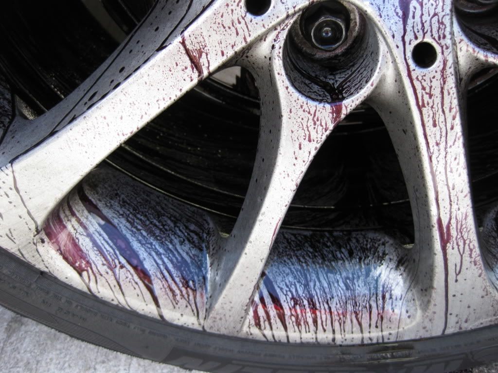

After a good shake of the bottle I sprayed it directly on one of the filthy wheels. Remember when applying TRIX to shake the bottle very often if not after every spray. I allowed the product to dwell about 5 minutes.
Next I agitated with a combination of my SV brush, wheel woolies from PPL, and my Daytona Brush for the hard to reach areas and rinsed the surface clean while agitating.
The Front wheels followed a similar routine
After
Without TRIX:
On the final wheel I decided to clean it first without TRIX using only wheel cleaner for comparison. The surface mess was better but baked in brake dust was left at the corners of each spoke as well as a lot of iron and tar in the barrels.
I followed with TRIX as shown here
After TRIX almost all of the tar and iron the wheel cleaner had left behind was removed. Only one spoke corner still had visible baked on brake dust. Here I applied IX paste and allowed it to do it's job while I moved on.
Observations:
The bleeding that is so familiar with IX becomes apparent within about 30 seconds of spraying TRIX onto the surface. However, with TRIX it moves a little differently as it runs off. I assume that's due to the solvents from the tar remover portion of TRIX. The runoff is also a bit different in color depending on the contamination. When used on a wheel that had a lot of grease TRIX dissolved the grease, which joined the runoff creating a darker runoff fluid.
