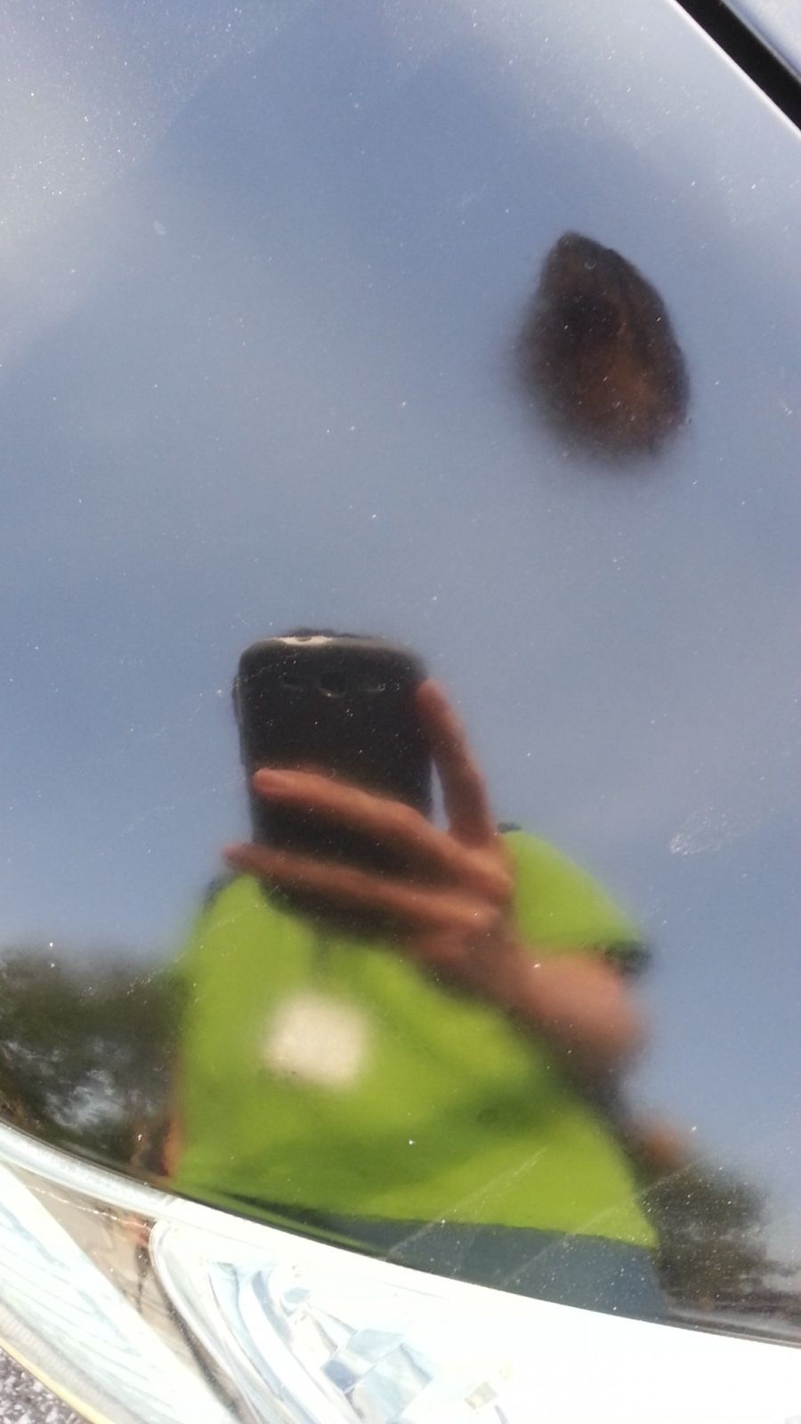

I just bought a clean 97 dodge cummins, but it has many chips on the front that are rusting. Is Dr Color Chip a good way to approach my DD repair, and why doesn't dr color chip list my "light driftwood satin glow" Paint Code PFA? Is this touch up color going to be difficult to find, and am I better off having someone paint the hood and fenders? Is the paint even available and what are the options? This truck is a keeper, but Im going to be DD and I expect more chips and what not.. I wish it was white..
Thanks!
Might be, but first you'd need to remove the rust using an "iron" remover. If you don't, then any paint applied to the surface over it will peel off in a short time.
A repaint could have several advantages over a touch up, but it's also more expensive, and if the paint is heavily degraded and/or the body shop can not adjust/match the color properly, you might end up with a panel that has a noticeably different color tone than the original, making the repaint obvious. Personally I'd try to touch up smaller defects, and only do a repaint if the results are not acceptable, or if the are already defects that are just too big to be touched up properly.
Get the color code first. Then you can see whether it's available at Dr. Colorchip. The latter is actually not necessary for a touch up, as you can also use regular automotive (touch up) paint for that, which will be definitely available somewhere. However, regular paint has no real blending capability, so you'll have to be more careful how you apply it, and also most likely have to wet sand the surface (and then of course compound and polish it) to get acceptable results.
Btw. it looks like your headlights will need to be replaced too. The yellowing and fogging up of the front "lens" could be fixed by means of polishing, but I also see that the bottom of the reflector surface inside of the headlight is also oxidized - and there's no real fix for that. Also, this is not only a cosmetic problem, but also adversely affects the light output of the headlight, which in turn affects drive safety.

The paint code is PFA, but Dr Color Chip doesn't list PFA as a 1997 truck color.. I haven't asked a dodge dealer yet, but as a daily driver I would much prefer touch up paint because I'm alright with imperfections as long as its not rusting..
Do you know of step by step instructions for rusty chip repair? Youtube video or sticky thread?
What I'm worried most about, is not completely neutralizing the rust pits and it returning again, not so much perfectly matching the touch up paint.. I'm tempted to use rustoleum again because I had great luck rolling it on a white truck, but I don't want any adhesion problems if I repaint with automotive paint later.

Not really. Ospho converts rust to an inert substance, but does not remove it, which will cause a lot of trouble down the road. The ideal solution is - whenever possible - to remove the rust completely, and you do that with "iron removers". These do not actually remove iron, but iron-oxide (and that's why I put "iron remover" in quotation marks), but that's what essentially rust is. I'm talking here about products like CarPro Iron X, but really any similar product is also good, as long as it's capable of dissolving iron-oxide, and is formulated to try to not damage the paint.
Well, then click "my car isn't on the list", and then you can enter any color code. That said, try to talking to them over the phone first on how to proceed in this case.
Not really. But once you've removed the rust, you're at a point where most chip repair videos will apply to your situation.
Well, the iron remover should take care of the problem, because it literally removes (dissolves, and carries away) the rust. I suggest you use a cotton swab to agitate the iron remover and to help with thre removal process. And you might need to spend up to (or in some cases even beyond) a minute on each chip (depending on the amount of rust that's in them), but in the end you should be able to expose the bare, uncorroded metal under the rust. At which point, if you clean it properly and apply the touch up paint to it, you should be able to stop the corrosion at that point for the remaining life of the car/paint.

Converting rust to an inert sealing layer is the way to go, if the rust is not directly accessible or removable, and you don't plan other means to seal the surface and prevent corrosion. Because a fluid can obviously penetrate even small crevices that are not accessible by hand or tools, and because the formed inert substance (if fully covering and perfectly sealing the surface of the metal) prevents oxygen and water reaching the metal, and thus further corrosion.
However, a rock chip fits neither of these criterias, because it's directly accessible, the rust is easily removeable from it, and when touching up with the paint, the paint will also seal it off and prevent further corrosion. Also, the paint will not be able to bind properly to rust, which will cause the paint to peel off, if applied to it anyway. Also, even if paint could bind somehow to rust, or to the surface of rust which has been converted by ospho, the deeper layers of rust still present could still break and get dislodged any time, which in turn would again mean, that the paint will peel off. That's why you need to remove rust in the first place.
Also, as already explained, rust takes up more space than the raw metal, and any conversion process will most likely just add even more to that already bigger volume. So, if you do that, even if it would be perfect for the purposes of preventing corrosion and for the paint to bind to, it would still most likely mean it would create a bump in the chip, which would or could hinder you in creating a perfectly flat surface with the touch up paint.
That's why using ospho doesn't seem to make any sense to me when touching up rock chips. That said, because you seem to be pretty determined to use it, just do it, and let us know about the results.

I cut short pieces of 1/8" wooden dowel and superglued 220 disks to the ends. Its easily controllable and seems to work great to sand a chip. I will make some 400 grit "sanding dowels" next. Then clean it with Iron X paste after sanding.
As far as cold temperatures, my garage is 45 degrees while its 20 degrees outside.. I'm going to assume I need to heat my garage with my 220v heater and maintain 60 degrees to apply the primer, base coat, and maybe the clear?

Wow I really underestimated how much effort this repair will take!
1/8" disks are to big to sand many of my chips.
Feels like I'm fighting a loosing battle and should have temporarily sealed off and slowed the rust with fluid film before having it professionally painted. Ouch!$
Or can I apply primer/paint without sanding, or light 1000 grit area sanding if I use Iron X paste and Ospho? I'm still waiting on the Ospho, but Ive read it can damage paint.
Thanks!
You need to sand _after_ you've applied the touch up paint to the cleaned surface. If you do not sand the touched up area flat, then the touch up paint blob will drop a shadow, and the defect will be even more obvious that in was before you touched it up. If you do sand the area, use at least 2000 grit sandpaper (but 4000 or 5000 will be even better), because otherwise you won't be able to remove the scratch marks with a compound, and you'll likely burn through the clear coat in just a few strokes anyway.
Of course if you have a very fine and tiny artistic paint brush, you can try to just barely coat the bottom of the chip with the touch up paint (obviously after you've cleaned it, and removed all rust), which will save you having to sand down the blob. But if you do this the defects will still be very visible even from a couple of feet away, as they won't be flush/level with the rest of the paint now, and the paint will only sit at the bottom of the "pit" that's your chip. It's just that those chip craters won't "poke" right into your eye anymore, because now they will have (about) the same color as the rest of the still in tact, original paint.
I personally wouldn't opt for the latter, as it barely provides any improvement over the original state, and will still take at least half the time as would the one with the sanding part which - if done correctly - leads to pretty decent results.
Other than these your only option is a full repaint of the panel in a body shop. Which however also might have its own set of problems, like with color match, especially in different lighting conditions. Theoretically you could also try to do a repaint yourself with some canned paint, but that most likely will not lead to decent results on a hood, which will show any and all imperfections 10x more than for ex a curved bumper.
