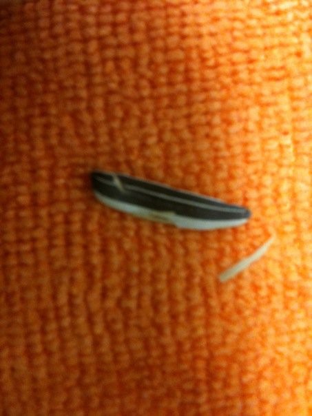

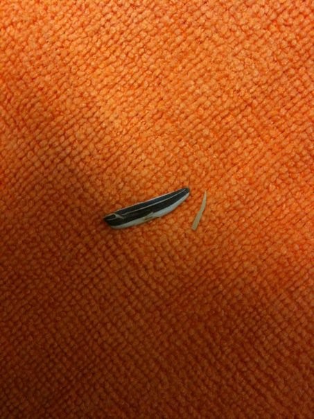

The self leveling concrete is not so level in my garage and some of the high spots did not etch all that great and those are the spots were a couple small spots have lifted.
I love it though. Looks great 4 years later and cleans up very easy. I also like that when I ONR a car in it and I can just run around with a couple of beach towels and clean the floor at the same time. Awesome !!
