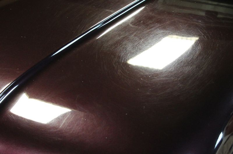

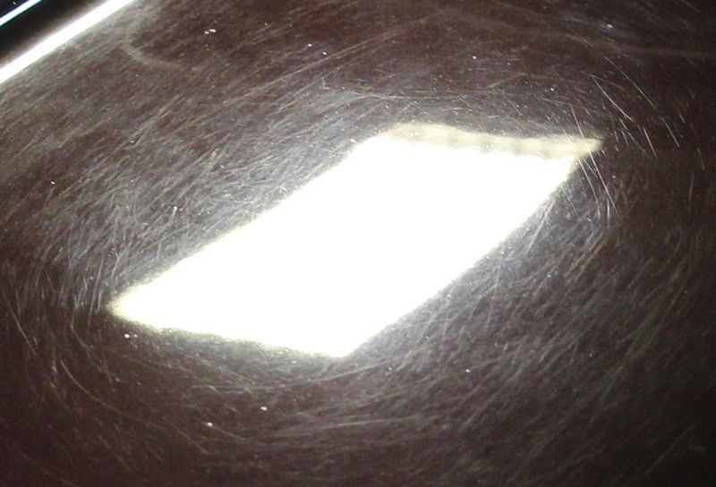

Ok, visited the car again today and the rain has removed the mud, but there's bigger problems. Before I edited the opening post I was talking all sorts of crap about my cousin and when you see these photos you'll understand why. How do I go about removing all this? It's baked on grime, dirt, sap, etc, etc. It's everywhere except the car doors, it's even on the windows and mirror glass. I'm worried I'll need new paint.
Some of that grime may be so imbedded in the paint it may have to be clayed and polished out. A good wash, serious quality time with a clay bad, and a good polishing will do wonders. The plastic lenses might require the same level of attention, but with different products designed for headlight restoral. My thoughts. I'm sure the pro's will have better advice.
What about Hyper-Wash in a high concentration heavily foamed? I really wonder how a soap like HW would compare to a RW or Surface Foam Prep being everything I read suggests that they only remove light contaminants.
I think it would help a great deal, but if that grime has been on the paint for a long time, there is only so much you can do with detergents on the surface. It is embedded in the clear coat at this point.
A few years ago we bought my youngest daughter a 6~7 year old car. Mechanically it was in great shape, but you could tell the previous owner rarely washed it. I thought the car was a light gray, but it turned out to be a bright metallic silver. After giving it a good wash, the car was clayed heavily and the clay bar showed a lot of contamination. From there I started polishing. Even with a light polish and a medium polishing pad I was STILL pulling contaminates out of the paint even while polishing. My white pads turned black with all the grime I pulled out of the paint.
Mike Phillips has a couple good posts here showing older vehicles being polished and the grime coming out on the pads. The end result is the vehicle color changing noticeably and not all of that is because the paint is polished out. His pads turning a dingy gray/black are good signs of all the gunk the polisher pulled up.
