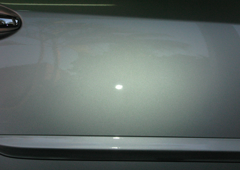

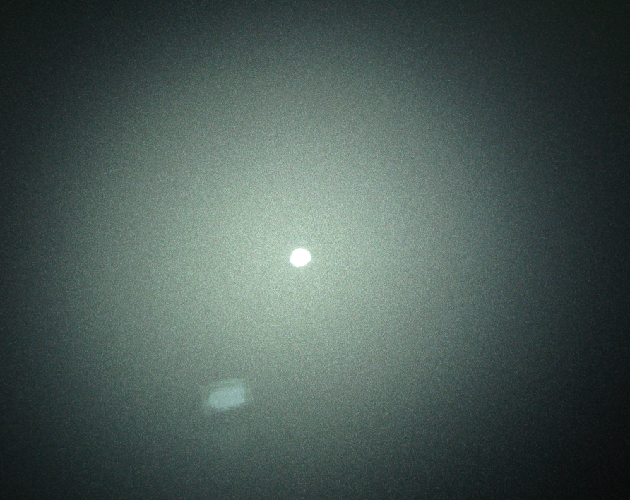

When we purchased our son's first car, a 2004 Chevy Malibu Classic, the windows were not great. He got home from work one evening and informed me the glare was terrible during the evening and the sand etching was very bad. I purchased CarPro Ceriglass and Pinnacle polish kit. I also purchased a backing pad and 5" pad for my Flex 3401 to do the bulk of the work. You can use the product straight or I misted water on the windows as well which helps keep the product moving. After I was done I treated with Pinnacle Glass Coat.
Glass Repair Kit
It's not going to pull out deep scratches, but for finer scratching and sand etching it worked very well. For something as severe as deep etching, or scratches, it would have to be a full-on wet sand and machine correction which I would have a professional facility that specializes in that do.
I dug back in some picture archives and found these two shots of the glass after I was finished with it. It's a slow process because you are polishing glass, but it worked. My friend commented "A hammer and a call to Safelite would have been faster." LMAO
View attachment 69788View attachment 69789
