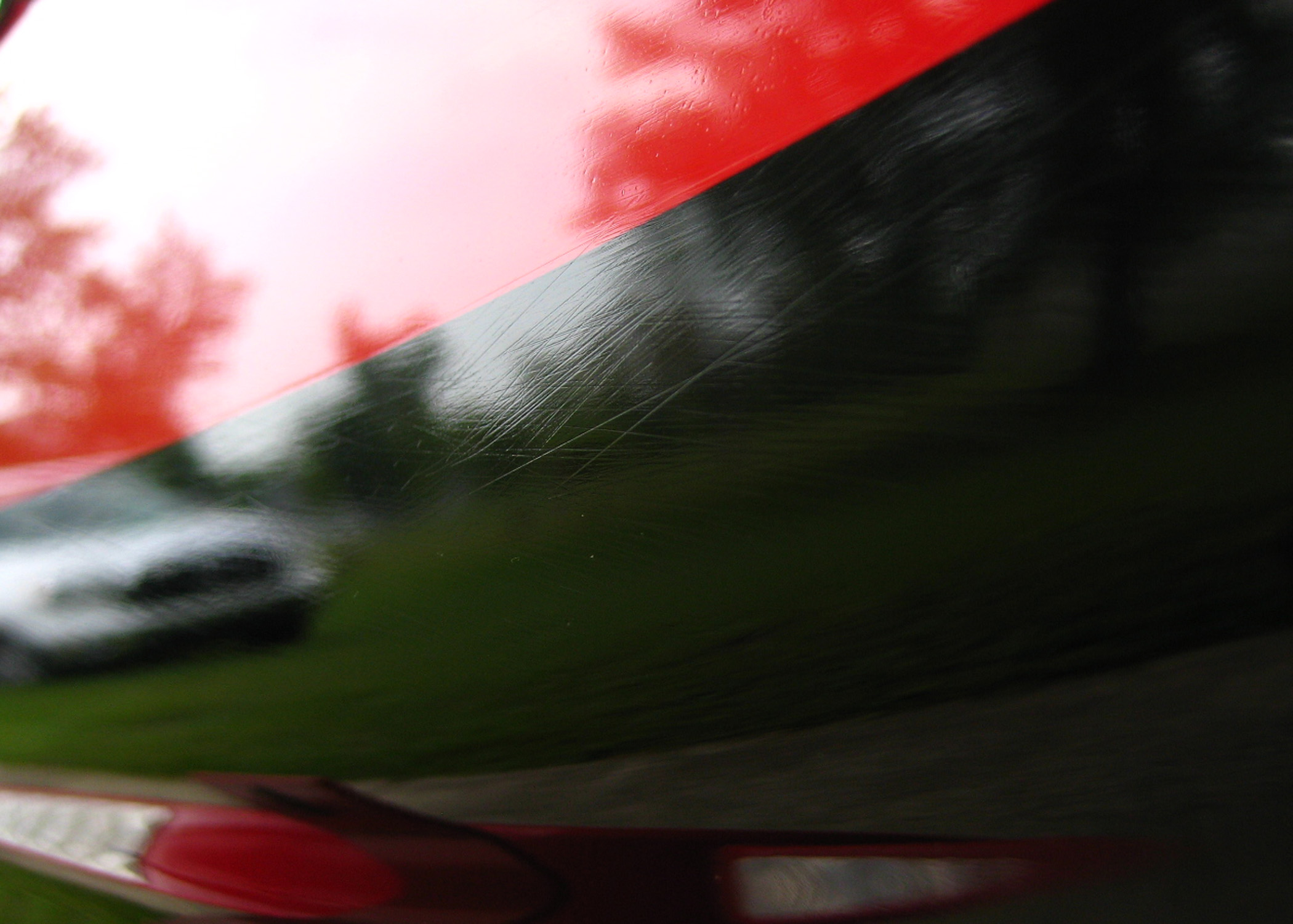

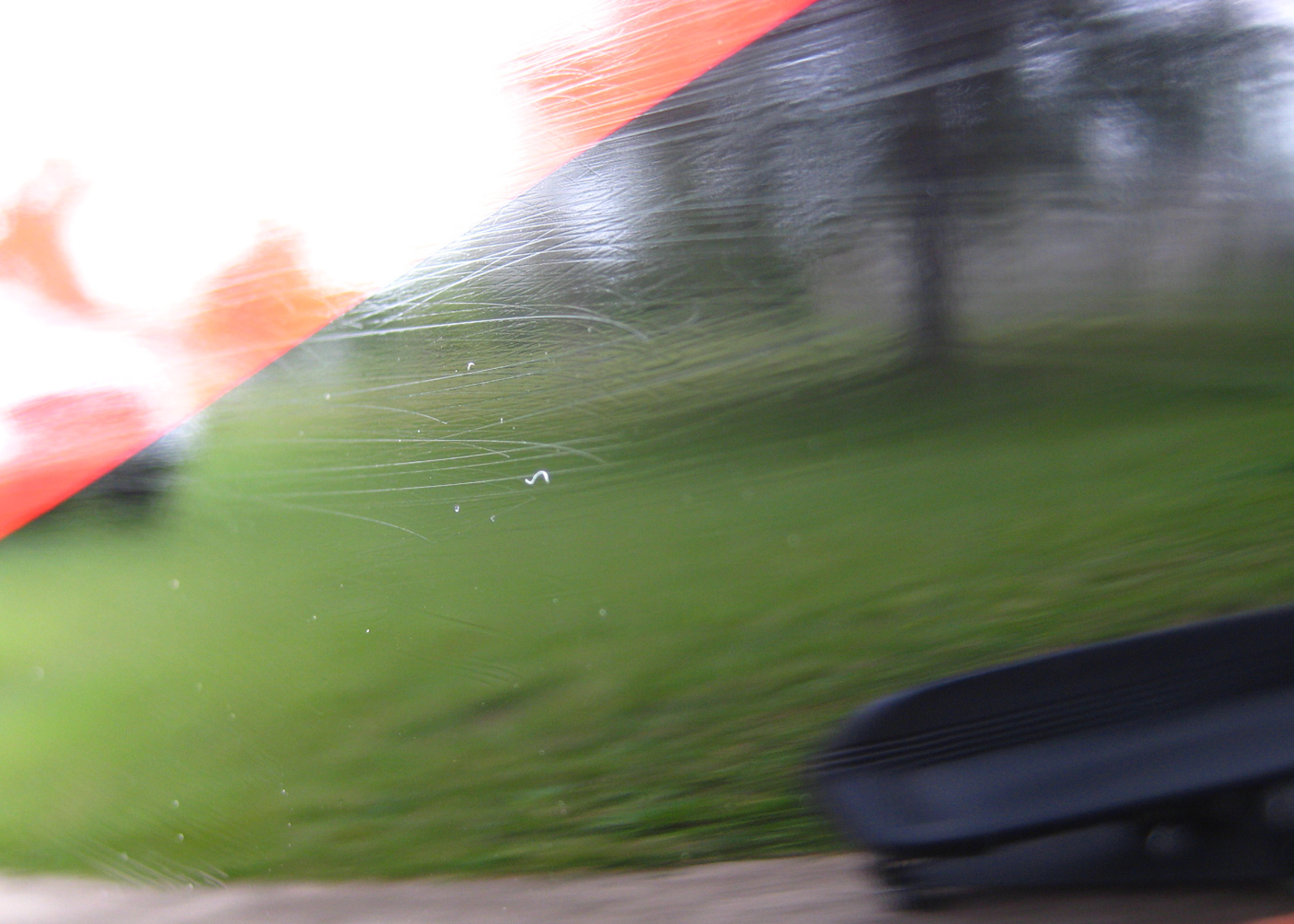

I'm not having any luck removing the unfelt scratches in my gel coat. I'm using (aggressively) the 7424XP, an orange pad and Meguiar's 105 compound.
Does anyone else have a suggestion on what to try next?
This is a 2012 boat and I've noticed these scratches since day 1. What is the possibility of the scratches being underneath the gel coat? In other words, a bad fiberglass job that has been gel coated??
Again, I cannot feel these scratches, but they are a painful eyesore in just the right light and angle.
Here are some links for your review of the scratches.
http://www.cs2photography.com/s1.jpg
http://www.cs2photography.com/s2.jpg
http://www.cs2photography.com/s3.jpg
http://www.cs2photography.com/s4.jpg

From the looks of the scratches in the pictures, they were in the mold or in the prep work when the boat was painted.
I'm logging off for the day, my eyes are bugging out, but see this article, same kind of idea...
Here's what Dieback or Shrinkback looks like in fresh paint
I don't think you can fix this unless the coating you're working on is thick. I do troubleshooting by placing a tape-line on an affected section and then buffing on only one side of the tape-line. Real quick you can see if you're "affecting" the surface and removing the defect or not.

Contact the dealer and ask if the color is "IN" the gel coat or if it is painted.
I had a 2000 Baja 232, same as the model Mike Philips buffed out here. That color was in the gel coat. The gel coat is thick. Wet sand it...you will be amazed how fast it goes.
Typically, the manufacturer will use a black gel coat behind the color. I would suggest wet sanding a section that is white until you get the correction you seek; without seeing the slight gray tint that means you are running out of white gel coat.
I wet sanded by hand and then finished with M105 on an orange pad with an old Porter Cable 7424. The PC is very slow going, but the results are worth it!

These scratches are BAD!
Here's what I would do...
I would find someone important where you bought the boat and send them the link to this thread, specifically this page with these pictures.
And ask them at what point in their boat manufacturing process are prep scratches like these instilled into the hull.
Then ask them what they recommend to remove them?
Someone at the place that built the boat, not sold it but built it, should be able to look at these pictures and give you some information.
Besides the above approach, if it were mine, I would try wetsanding a small section with some #2000 by hand or #3000 by machine and then compound out my scratches and inspect.

As for this picture below, try using some kind of flat pad so you have more pad in contact with the surface. The issue with convoluted pads is the only time you have "close to" 100% contact of pad with surface is if you apply a lot of pressure to squish the high points flat. If you have to do this you might as well get a flat pad.
UPDATE - this was a VERY EXPENSIVE trip to the dealership. Good news!! The owner of the dealership did not like the scratches he saw and needed professional advise from a local 'glass' guy. The owner's thoughts and fears were that this came from the factory this way. Once the 'glass' guy showed up and had a look, he confirmed this. The 'glass' guy said that sometimes these imperfections won't present themselves after a year or two in the sun, then they becom very apparent.
Anyway, the dealership, the glass guy and the manufacturer were more than understanding and admitting a flaw in their prep work.
The reason this was an expensive trip is because they offered huge money on our 2012 boat and gave us 2013 pricing on a 2014 boat. So, at the end of the day, we've traded in the boat for a 2014 - boating season is officially over.
