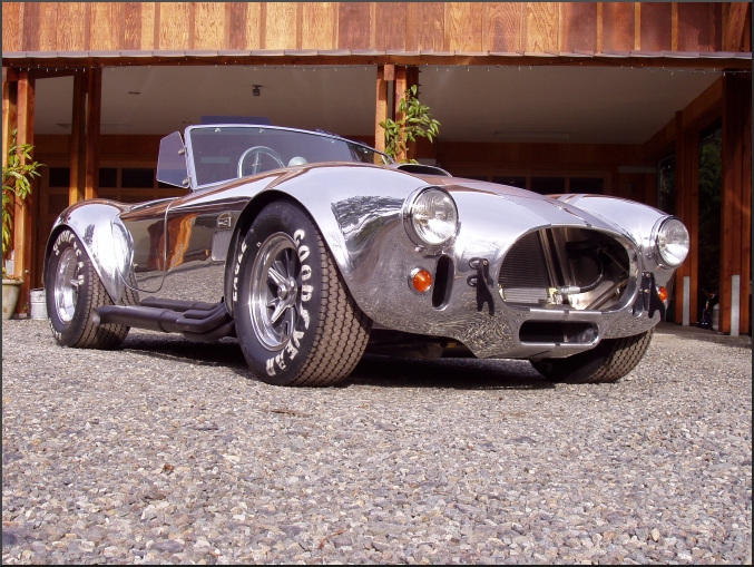

This is a Kirkham Motorsports Cobra replica in bare polished aluminum. The manufacturer and many owners of these car have tried many kinds of "sealants" with little or no luck. There is no such thing as a sealant for bare aluminum.
There is an aircraft aluminum clear coating on the market, but it changes the look of the metal. I've been using Meguiar's Metal Polysh on my Halibrand replica wheels with excellent results. It leaves a protective coating that resists oxidation. I polish then apply Meguiar's M21 paint sealant. I keep the wheels clean with car wash soap and re apply the M21 once every two months. I polish annually.
Polish your wheels, keep them waxed, keep them clean and you should be good for a year.
The product has been discontinued, but Auto Geek still has it in stock. Neguiar's also makes a metal polish in their Marine Line with similar or greater protective qualties. That's my new choice
