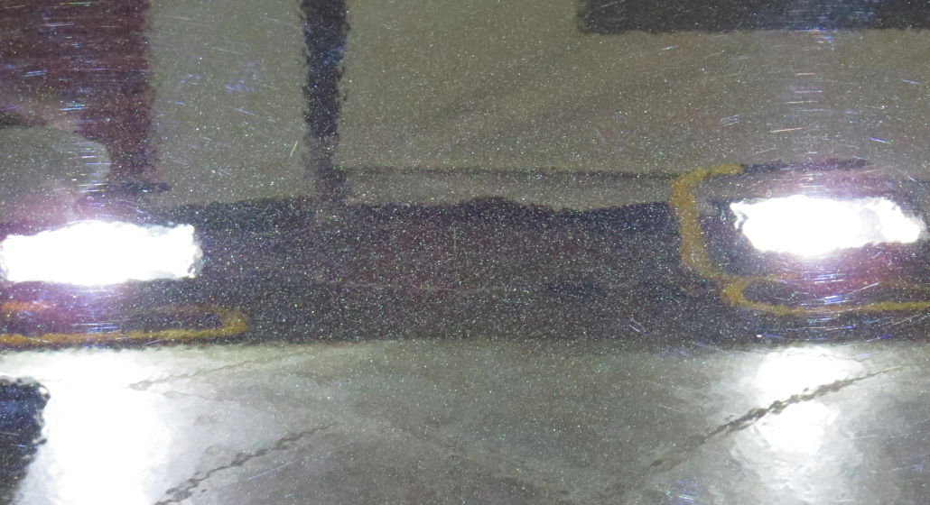

Hi guys, the OP here.
Nothing suggested really worked, the silicone was so stubborn and glued to the paint.
So the answer is elbow grease and some serious time working with plastic scraper, and some compounding when all was removed.
Ta-da !
Ta-da !

Oh yes, plenty of marring, but the Ultimate Compound took good care of it. :D
