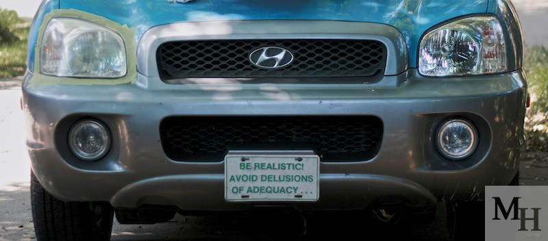

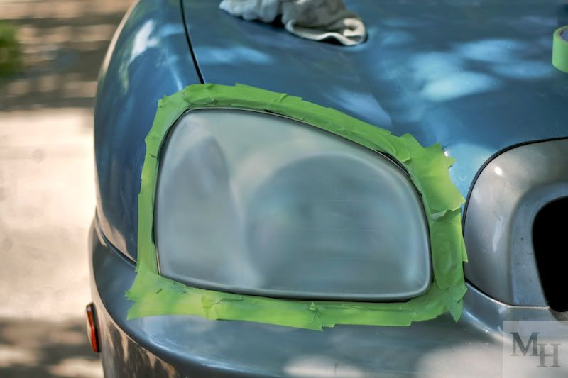

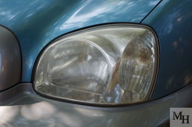

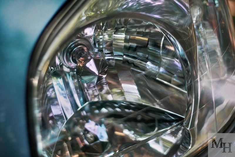

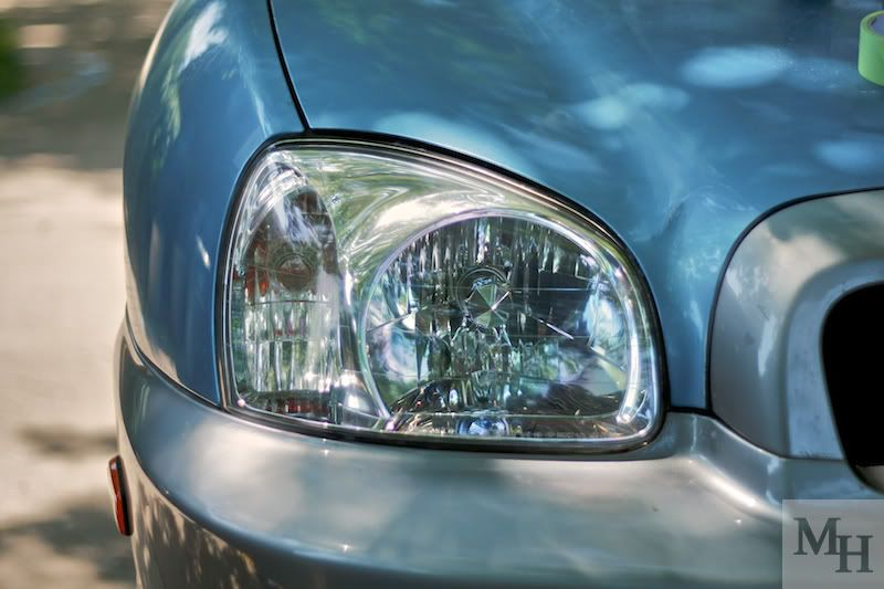

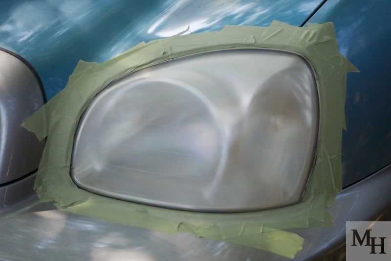

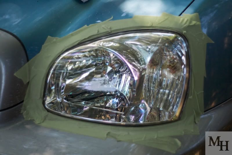

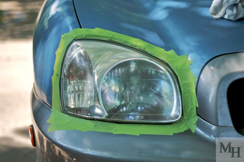

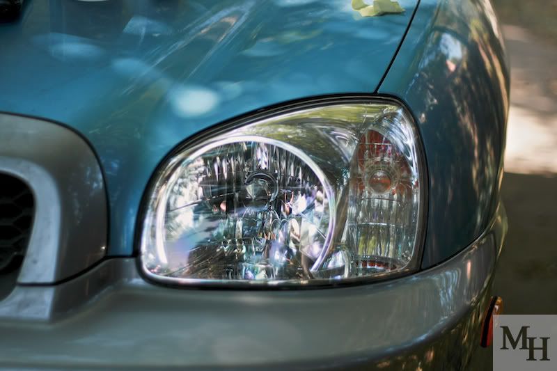

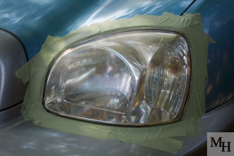

This is my wife's best friend's 2003 Hyundai Santa Fe.
Sanded with 500, then 800, then with a 3000 Trizact pad. Polished with Meguiar's ScratchX mixed with a bit of Mother's Power Plastic headlight restorer, and coated with Meguiar's Headlight Protectant.
Driver's side completed, about to start passenger's side.
