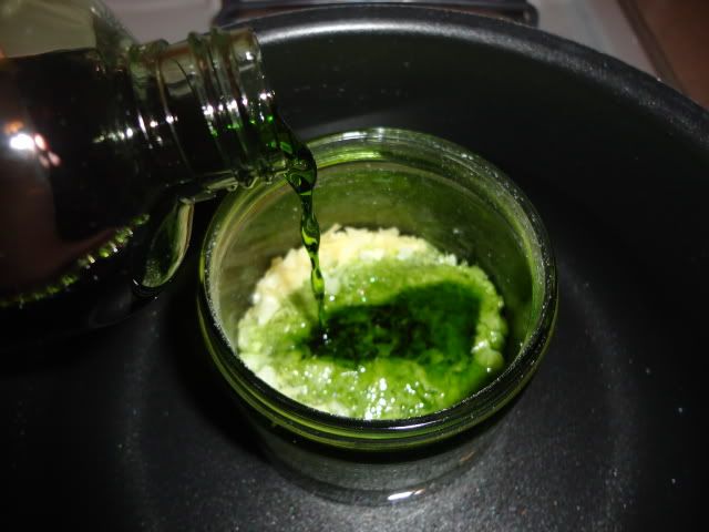

Then you pour your solvent into the jar of wax:
Once the solvent is emptied into the dry wax container,the contents level will fill to almost the brim of the jar:

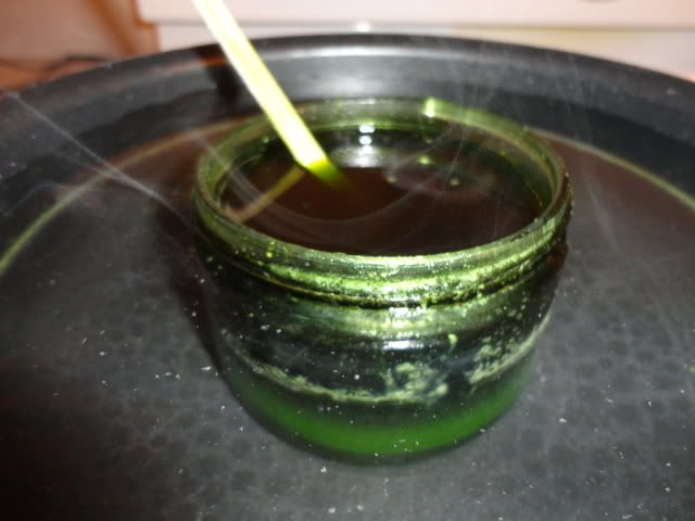

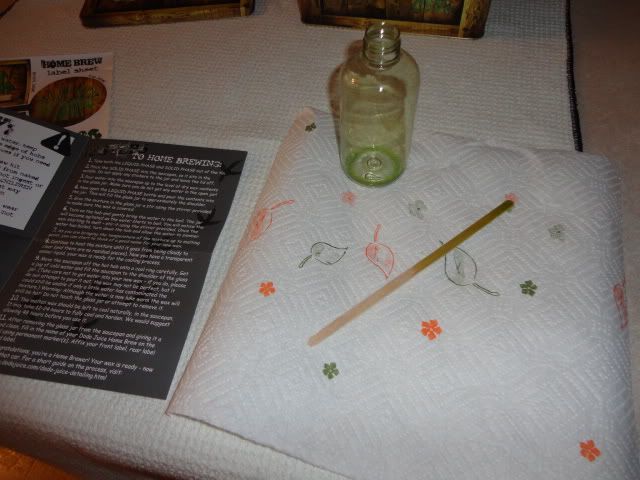

Use the supplied wooden stick to mix the wax and solvent together:
Putting empty solvent jar and stick to the side.I use this stick again,and do not toss away(garbage):

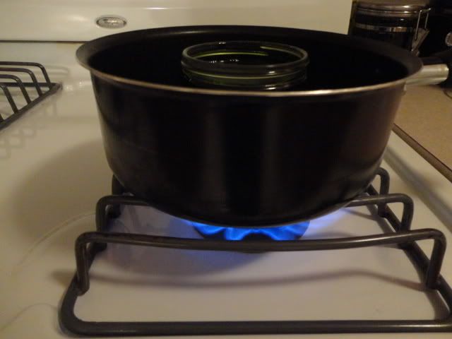

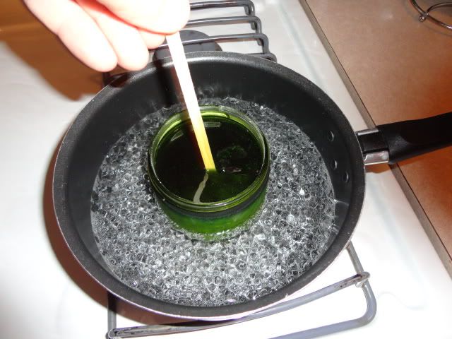

Put the flame of your burner to almost high,to get the water to boil:
Waiting for water to boil(:work:):

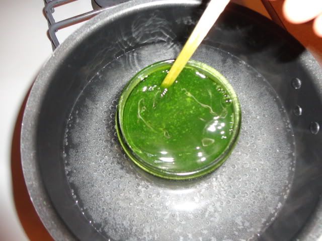

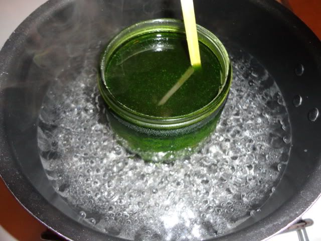

Ya,Water is boiling.Take your wooden stick and give another good stir.Don't stir too aggressively because you will have wax in your pan when everything cools/dries.Ask me how I know ;):
Reduce your heat/boil,to a low heat/simmer:
Back to a simmer,and another good stir:

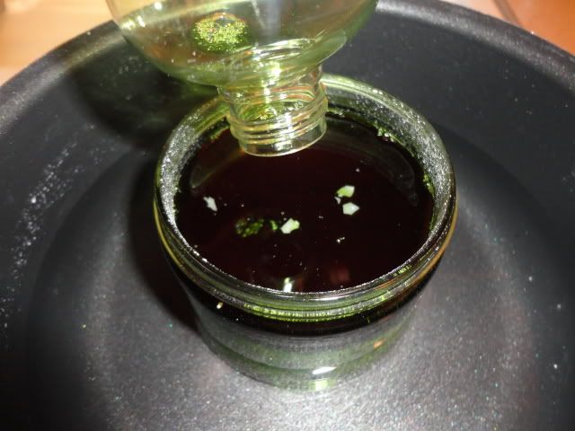

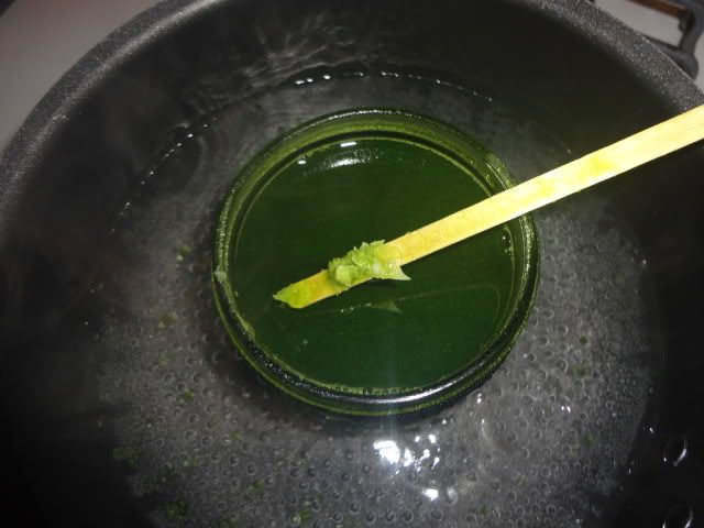

As you can see,there are still carnauba flakes present.Keep the simmer going:
A few minutes later(still simmering)and there are still nuba flakes present on the bottom:

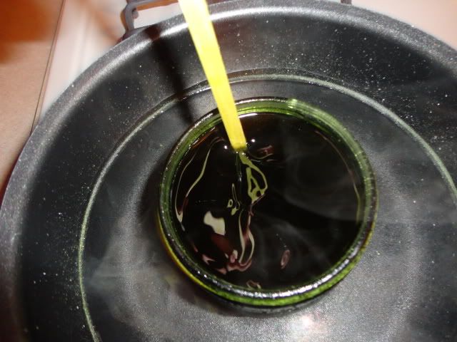

Give it time and eventually,ALL the flakes will have melted.This is where you can turn off the flame:
NO nuba flakes present:

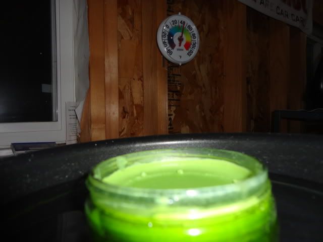

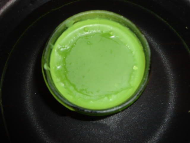

This is after an hour or so after letting everything cool down on the stove:
The insrtuctions say to let cool/harden for 12-24 hrs and should be ready to use at the latest 48hrs.After the jar was ambient tempature-I moved it to the garage to finish curing/hardening where it was 44deg F.:
