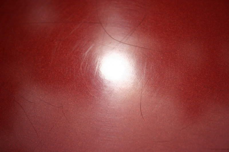

It has been a little while since I last used a rotary but it came back. No hop, jerking, etc.. Was cruising along great. Ill try to get some pictures up for you. Do you have an IM ?
I will look at the pics, can't promise anything thou.
uploading to the bucket now.
Thats the entire car.
It is supposed to be a bright red metallic color.
Ryan, the paint is prob just really hard. You will most likely have to hit the area's with multiple passes to get the desired effect. You can certainly go with wool if you have it. Either way work the hyper compound until its sufficiently broken down and then reapply some more and more if necessary etc until you get the result you are happy with. That is why Hard Clears are such a pain, they take alot longer to correct than softer clears. Keep at it! Good Luck!
Thanks, I appreciate it. It really is a beautiful color, I definately will do my best to finish it. I just always get on edge. I am new to hyper compound to I will work with it longer. The stuff just doesnt stop working! Thanks again Conan. That may have been where I was faltering. I was scared to keep working it too long.
You are going to have to get rid of all that dead paint, then start working on the fresh stuff that you get to. With the rotary you should go to wool if you need a pad any stronger than orange. Get a wool pad and work the paint with some 105, you still may need to make several passes though. 105 is going to be your best bet, if you have some power gloss that will work also but it will dust alot. Your optimum just doesn't have what it takes that the other two I mentioned have. Also use a little more heat and that will speed up the process. I have IM but so many people have blown it up I really don't use it anymore.
Thanks Dana. I will send a couple pm's then. I don't want to add to the IM blowup.
