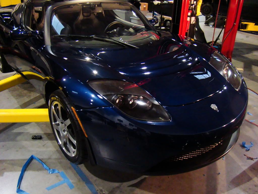

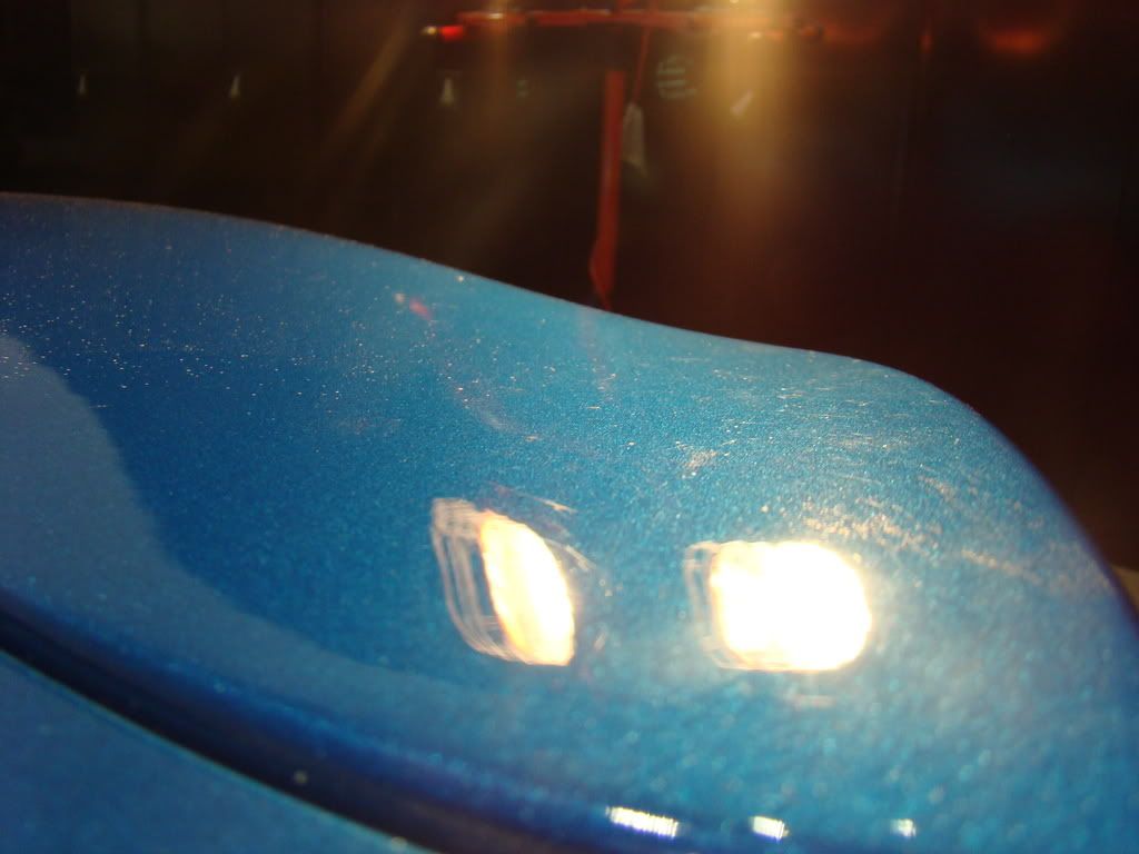

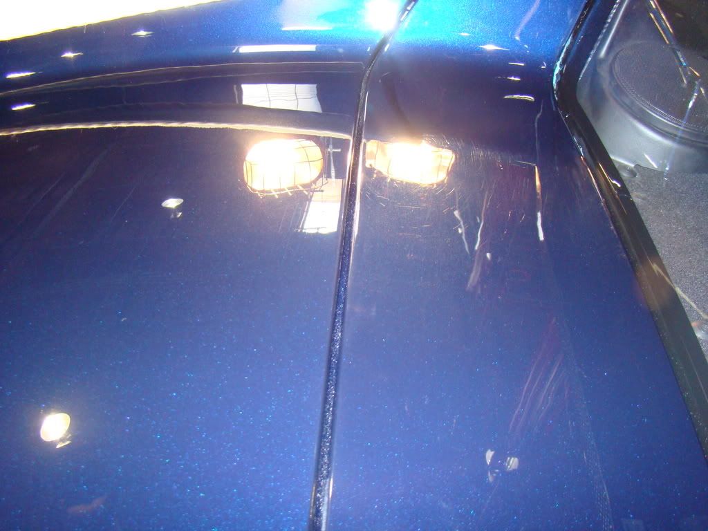

The cars started off in horrible condition, truly devastated clear coat. The dark blue car was used to test the affects of extreme weather. It was given salt baths and left to dry, every possible weather condition was thrown at it. Needless to say, it was i need of some serious work.
half/half:

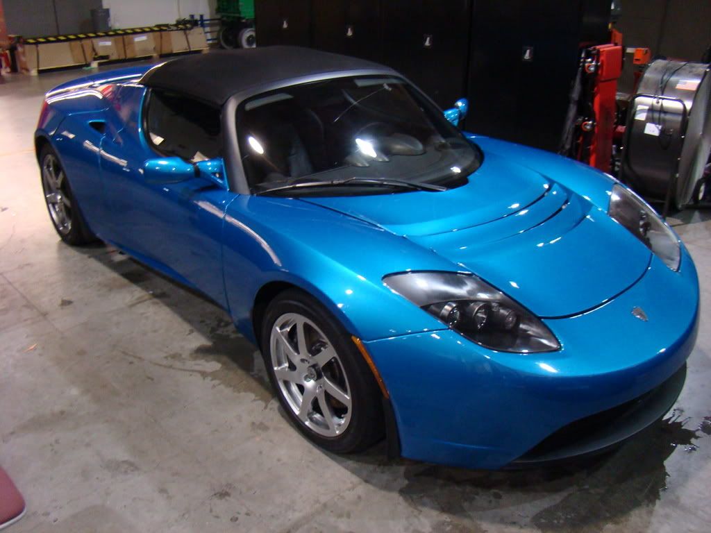

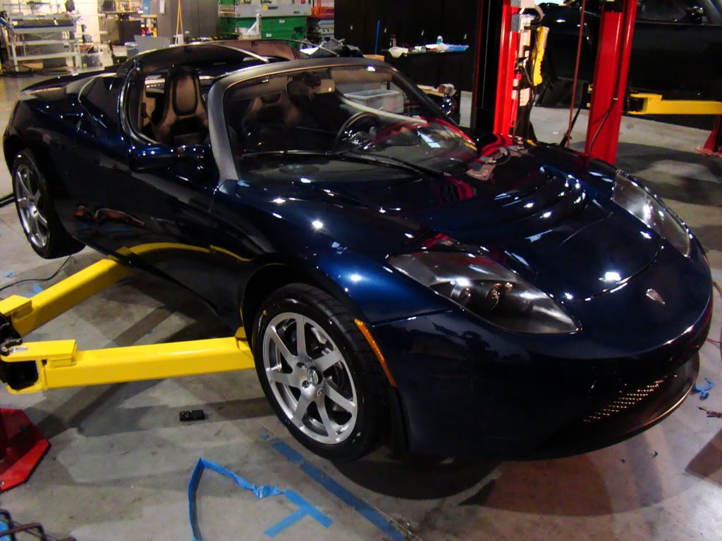

Next cars

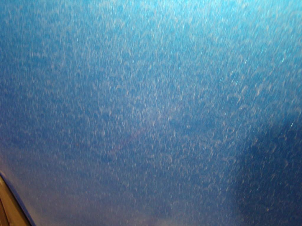

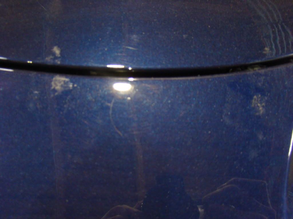

in this photo you see severe water marks and calcified deposited from when the car was taken in the nevada desert and traction control testing was preformed.

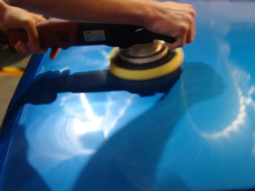

Hard at work

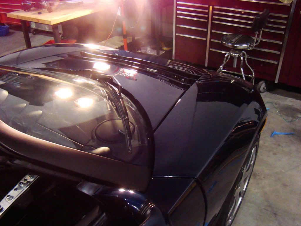

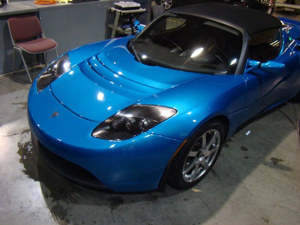

ALL DONE!!!!!!!!!!!!!!!
I was very pressed on time with all these cars and had to work a 20 hr work shift to finish one of the cars, which im sure as you probably can imagine is very hard.
If any one is interested i could go more in depth about steps used etc. BTW the light blue car and silver car will be on the cover of 4 major automotive magazines with in the next coming months. The dark blue car was featured at the LA auto show, among other shows.

At the request of a few members i will post up the steps used to correct the paint.
Steps used: Menzerna IP with a med cutting pad, followed by Menzerna Nano with a finishing pad. One one of the cars I used OPT poli seal after Nano with a finishing pad. I topped it all off with Pinnacle SSII. All via the Flex DA wich did a fantastic job, i love this machine runs very smooth and doesn't vibrate too much.
