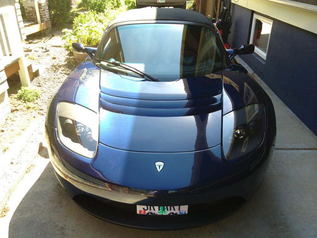

As delivered:
As you can seen the vehicle is kept very clean; however, the paint had seen better days...
The entire front clip was covered in Tesla's "paint armor" (paint protection film), which required careful polishing to repair damage...
