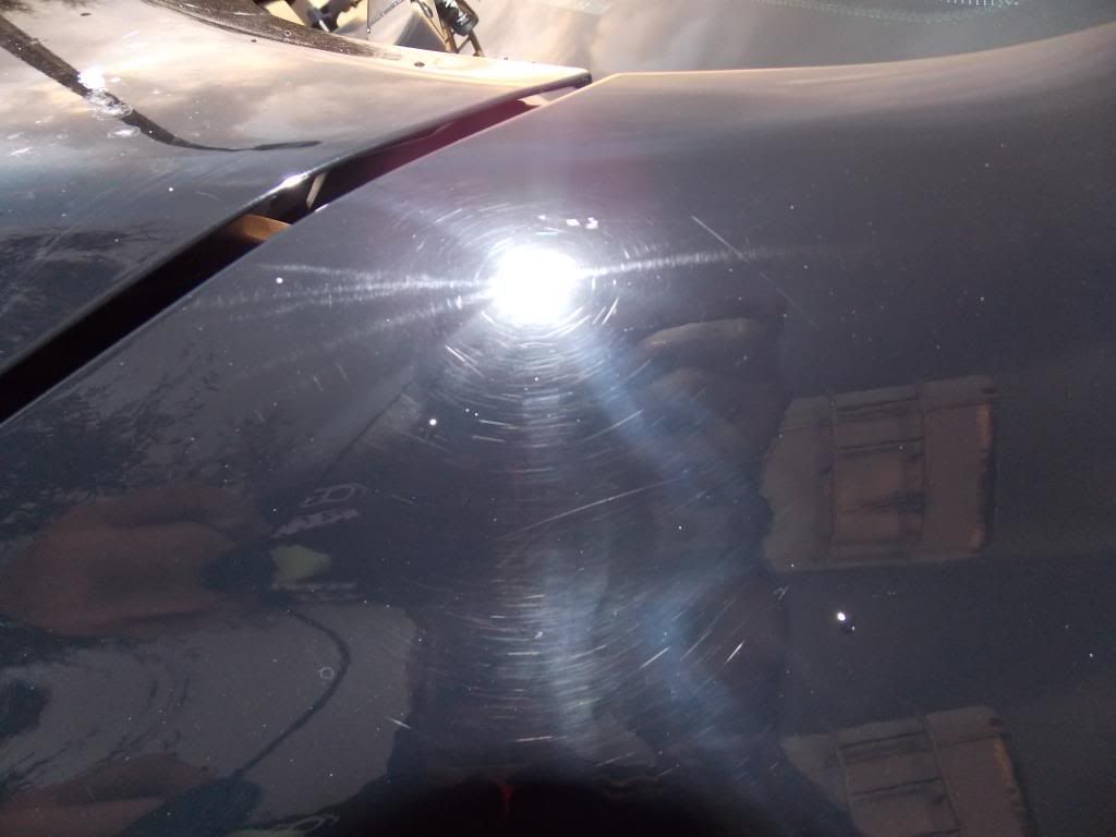

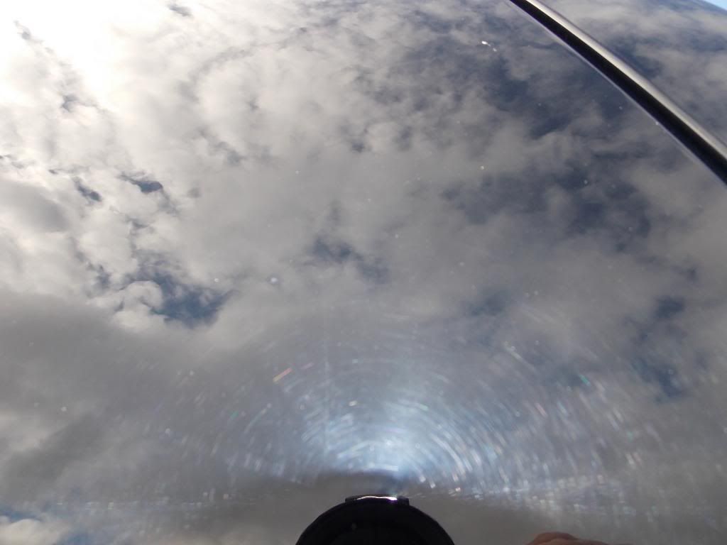

here is a pic of what I am dealing with
Best piece of advice is just work one thing at a time and learn it well. I was way overwhelmed about 2 years ago and went nuts. My results were ....sub par. Then I concentrated on one thing and got it down pat. Start with washing your vehicle properly. What sounds like an easy assignment will actually be one of the most important to learn properly. It's the base for everything to come! Everyone here is so full of information that some days I wish we were all like Neo in "The Matrix" where they could just hook us up to a machine and download all the knowledge that everyone here has! Welcome to the best detailing website around! (Last piece of advice is take TONS of pictures....these guys like LOVE pictures)
