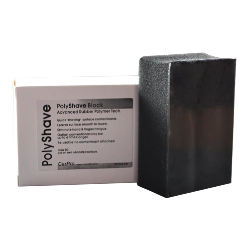

I think I saw DFB using a small clay sponge that looks like the CarPro PolyShave. Saw a review recently that the CarPro 6” synthetic clay pad was much better than the Nanoskin version in performance as well as price. Comments @DFB?

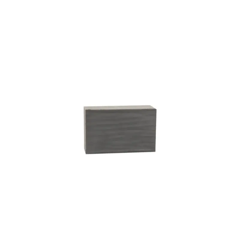

I can see it now. The local distributor of CarPro in Australia also has a small line of product sold under their own branding. The Carpro version is $6.50 more.
CarPro Polyshave Block -
The home brand one -
I really like this style of claying, much easier to use. That said, I don't think these clay products completely replace a traditional clay bar, there will be times when the extra grunt of a clay bar will be needed.

I always forget that I have the CarPro poly shave block. I'll have to remember it when the next vehicle that needs it comes in.
