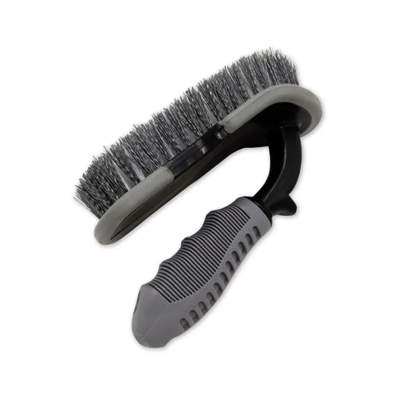

Brushes -
In any case, you will be teaming your chosen tire cleaner with a medium to stiff bristled brush. These come in many shapes and sizes, meaning you can choose one that suits the tires you intend to clean, while also putting thought into user specific ergonomic considerations.
If the brush is too soft, it won’t be very effective or efficient, likewise if the bristles are too stiff. The happy medium for me is the Detail Factory Tire Scrub Brush, which I really like how it can conform the shape of the sidewall to give a thorough, efficient cleaning action. Others to consider would be the Tuff Shine/Maxshine Tire Brush (pictured on the right above) something like the below images, which would suit larger sidewalls.
I just keep coming back to the DF and Tuff Shine brushes, they are so simple and effective.
NOTE - the general rule of thumb with tire cleaning is to continue to scrub/rinse/scrub/rinse until the cleaning chemical no longer turns brown during agitation. The brownness is actually a combination of dirt, old dressing and the anti-ozone agents that surface and then react to oxygen. The technical term for this is called “Blooming”. By all means, repeat the cleaning process a couple of times for thoroughness, but I would stop at two or three passes. Any more than that and you end up removing too much of those anti-ozone agents and risk premature weathering of the rubber.

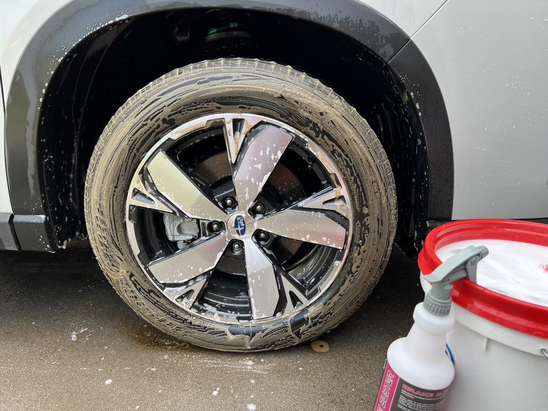

Shine Supply Wise Guy - this is the proverbial sledge hammer and MUST be diluted. Originally a dedicated tire cleaner, it has since been reclassified as a wheel and tire cleaner. I would probably restrict it to tires though.
Wise Guy is pretty aggressive, a product I grab for ultra dirty tires or when I want to strip tires right down to the bare rubber. I have also found it to be rough on sprayers, having killed a couple of Kwazar spray heads as well as Tolco and Canyon chemical resistant sprayers. I’m now running it out of a Marolex pump action sprayer.

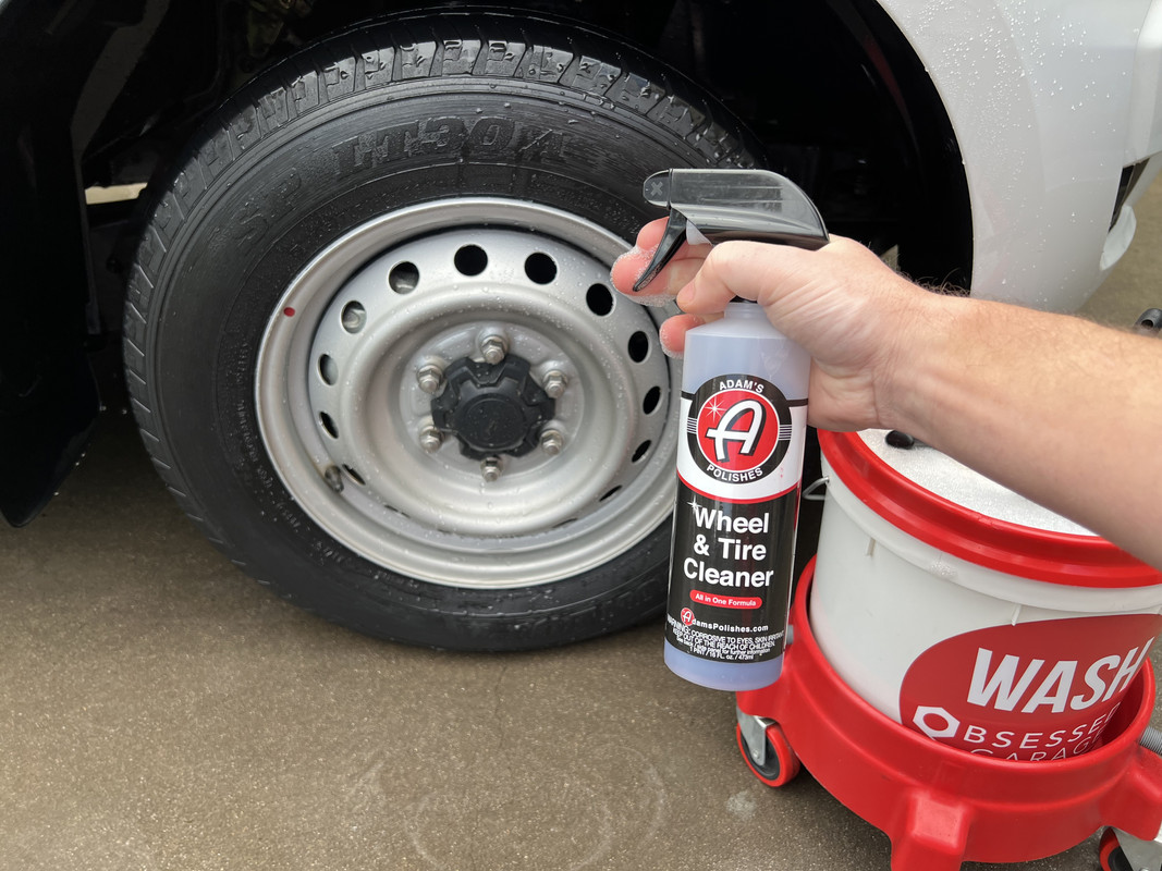

Adam’s Wheel & Tire Cleaner –this is Adam’s version of Brake Buster, in that it’s a combined wheel and tire cleaner. It shares the non-acid alkaline formula but doesn’t quite have the same level of foaming ability though. Or ultimate cleaning ability.
Some have mentioned that this product is a brilliant tire cleaner, but I only found it mildly effective. To me, Brake Buster is more efficient, and cheaper too. It’s a good wheel cleaner though.
NOTE - In Australia, the two Adam's products presented in this thread are priced at a considerable premium. For example, a gallon of either of the Adam's product sits at $149.95! Brake Buster for the same gallon is $49.95, and Undressed sits at $38.95 per gallon. For Australian readers, I would only recommend buying these Adam's products if on sale.

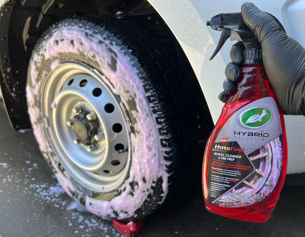

Turtle Wax Hybrid Solutions Hyper Foam Wheel Cleaner & Tire Prep – yet another ridiculously named product from Turtle Wax. They must be smoking crack when they have the naming strategy sessions in the boardroom over there. It’s been said that this is a company that has absolutely no idea about detailing, a confusing line of products sold by people who have no passion for what they are selling other than it making them money.
Harsh words aside, this is actually a very good tire cleaner. Like Carpro ReTyre, this is a foaming product that goes on thickly and agitates up to strip tires bare. Unlike ReTyre, this product can also be used on wheels. I wouldn’t. However, this is probably one of the most aggressive tire cleaners I have tried.
I’m not being a brand snob here, but I just can’t use this product. While none of these tire cleaners have a scent, or are what I would call pleasing, but this Turtle Wax product reeks. Certainly not like the Sulphur-like odor of an iron remover, but not far behind. I will say, I'm pretty sensitive to scents and odors, so you may not find it as egregious, but this is not a product I will be buying again for the aroma alone.
