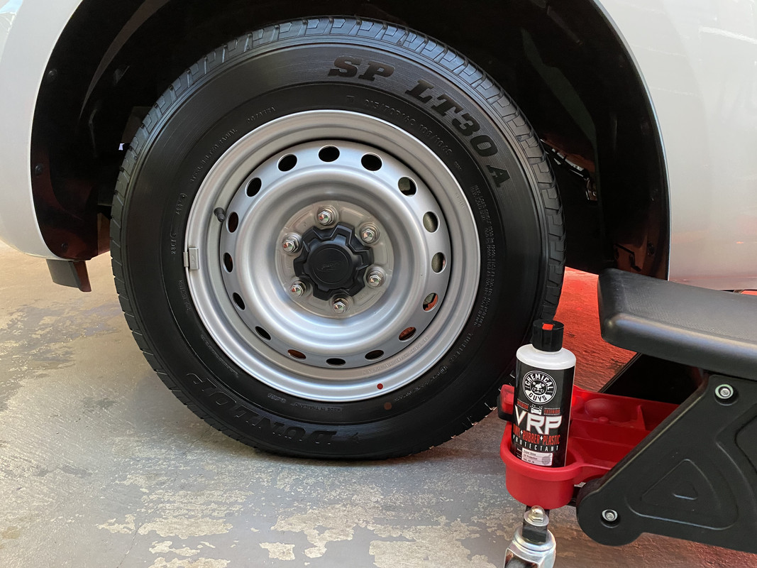

Chemical Guys VRP - a water-based dressing, VRP is the brands best product. But it’s certainly not worth the better part of $40 they ask for it in Australia! Chemical Guys suggest that VRP will make rubber and plastic “shine like new” and can be used on interior and exterior surfaces. Frankly, due to the claim of “super shine”, I wouldn’t be using this on interior plastics unless you want to make your dashboard look like an oil slick.
The big plus for VRP is the ease of use, the application is super smooth and offers great coverage. The scent is pleasing too. But the achilleas heal, like ALL Chemical Guys products, is the complete lack of longevity. For the price, there are soooo many better options out there.
Dilution – Pre-diluted
Type/Formulation – Water based dressing
Scent – Caramel
Consistency – Lotion-like
Best Application Tool – Foam applicator
Ease of Application – Easy
Appearance – Gloss
Longevity (Claimed) – Not stated other than “Long Lasting Protection”
Longevity (Observed) – A few days at best
DFB Score – 4/10
