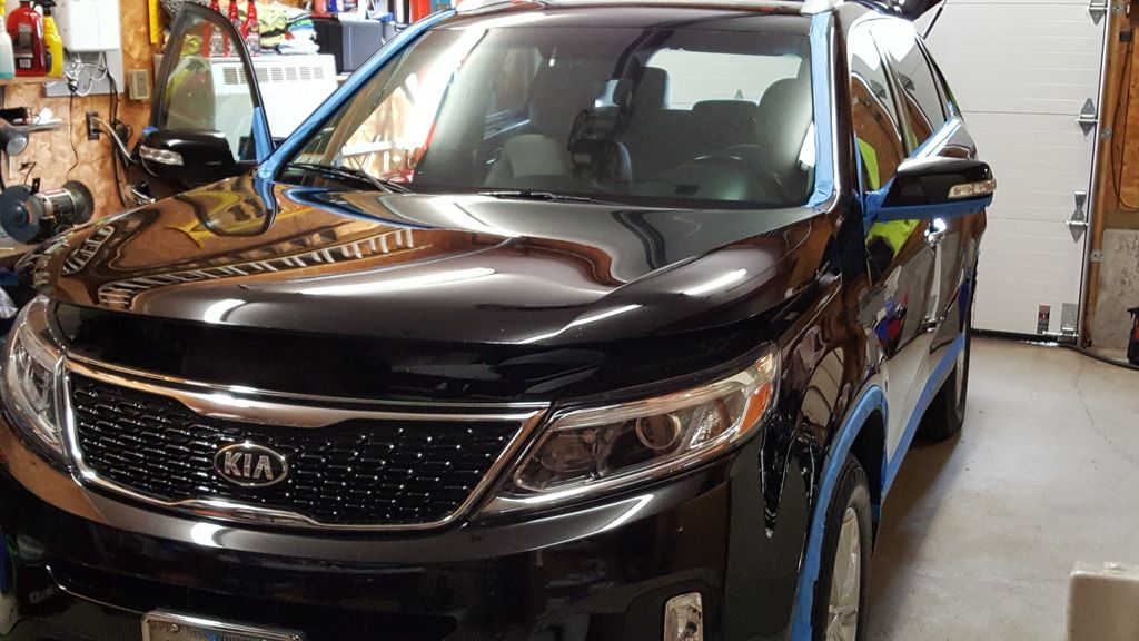

So heres what my car looked like after my last detail.

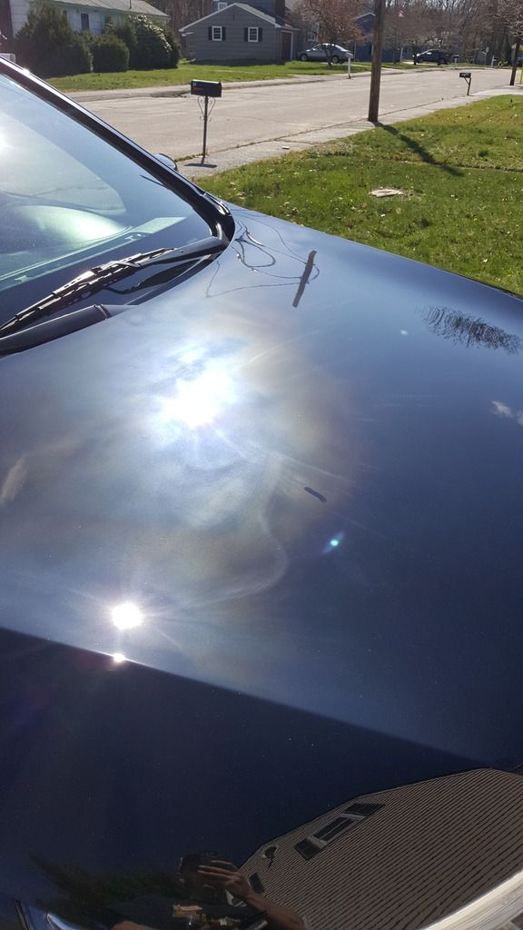

only problem is I used wet mirror finish on it before applying the synergy. Plus i never removed the polishing oils. I buffed off the synergy per usual. I even sprayed it down with n914 after the synergy cured to make sure i got asll the residue. It looked great in the garage but look what happened after I brought the car out into the sun and it sit for a while.

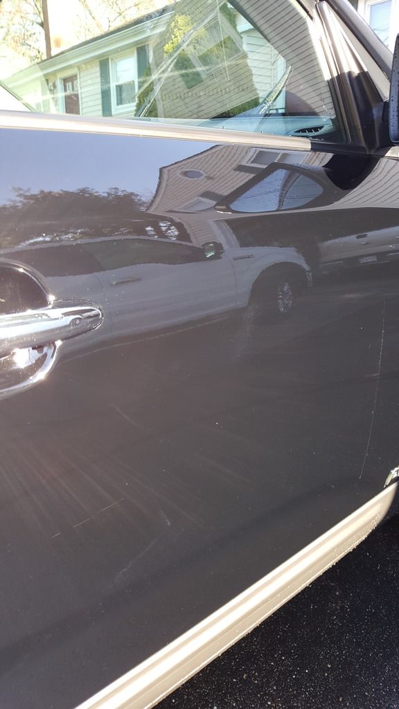

Ok so this has happened before but never this bad. I think the polishing oils and acrylic glaze stopped the synergy from bonding. I gave it a waterless wash right away. That didnt get it off and neither did a hand wash. It's hard to see but it still has this hazy, blue, oily, film on it.

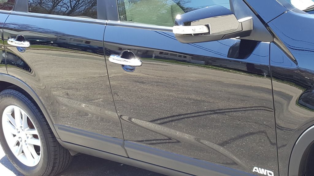

Ok so I finially decided to give it a hard wash with p21s total auto wash plus a hand washing with it. That worked and here is the car back ito normal after the p21s wash
same panel
diffrent panel

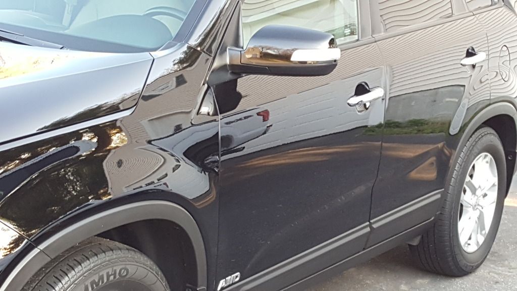

And here it is after the whole experience back to normal

Car looks great! I think the problem you had was "sweating" of the wax; we don't seem to have any good threads about that here and I searched on Autopia also--maybe I'll be able to find something later.
