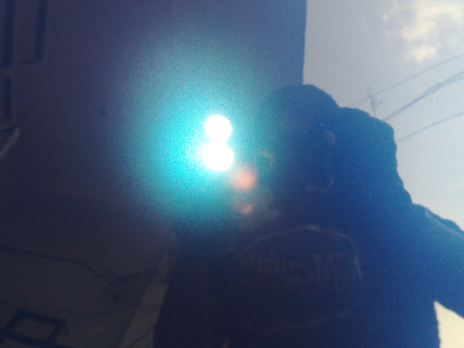

It's a 2014 Ruby Red Ford Focus. Using a 3401 and a HT tangerine pad with Wolfgang I got almost no transfer but wasn't correcting completely. So I moved to an orange pad (everything else the same). Then finished with a finishing pad and Wolfgang Finishing Glaze.
Anyone know what type of clear this car has? I know it's tinted and it's harder than the clear in my Mini Cooper was. Do all new cars have Ceramiclear?
View attachment 23665 It came out nice too my the way. This forum and Mikes videos have been a tremendous asset over the years. I'm just an enthusiast.
