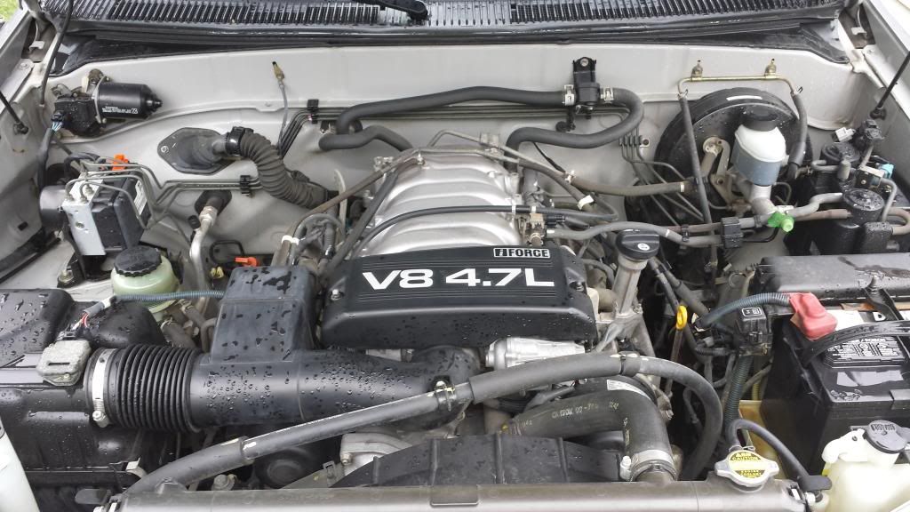

That looks like a Sequoia/Tundra engine.
Did you cover anything prior to cleaning?
i took a look around. most of everything in the bay is still very pliable, so i doubt i was going to find cracked electrical connections exposing anything underneath.
the spark plugs are covered by sealed and bolted down coils so no need to cover those up.
as long as you are sprayed over the top with low pressure the fuse boxes are fine, the way those boxes are designed is specific to being able to spray down an engine bay.
this engine is more than safe to spray with low pressure water for a rinse without hurting anything. i would be worried if things were cracked and old, but at 200k miles. mine is fine. and had no issues with it afterwards, no places for water to build up either.
its an 01 tundra btw. i also have an 01 sequoia as well.

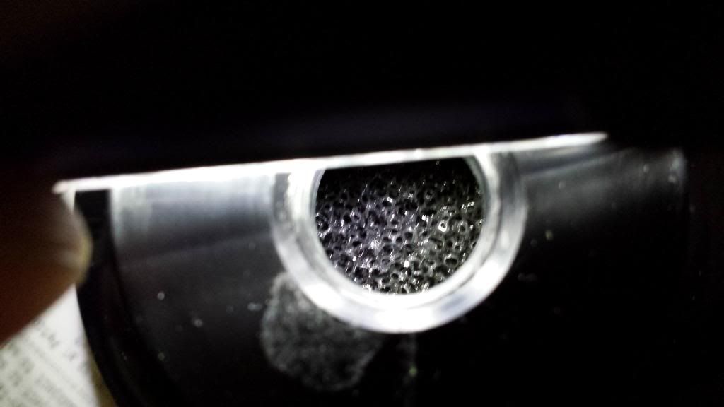

this is what is inside the foam guns unit. its a sealed unit, couldn't open it up and i dont want to damage it because if i decide to sell later i dont want it to be rigged back up.

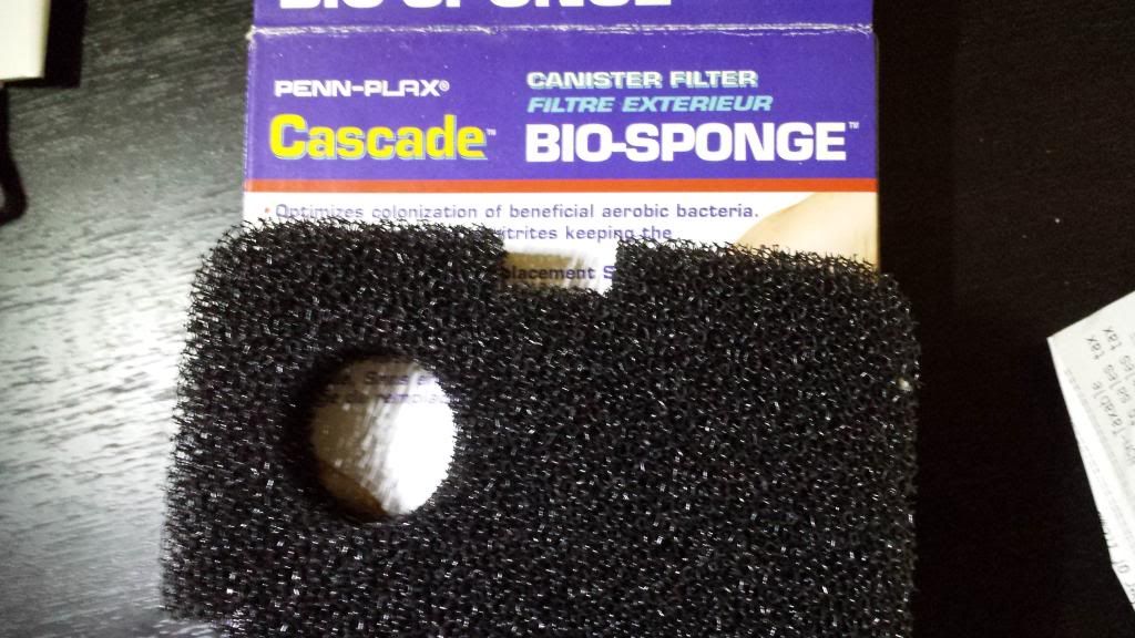

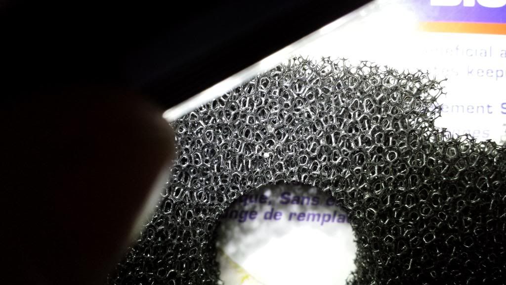

and this is what i'll be using in mine.
and what is it you ask? why simple fish tank filter media. it's exactly what they used, same texture and everything, 5-10 bucks at any pet store.

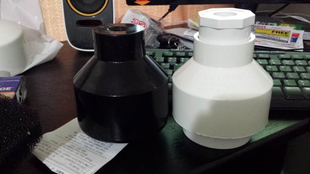

and this is the original vs the home made, eerily similar isnt it.... mine will be slightly larger by the end unless i do some cosmetic chopping though, becuase the pvc they used was specially made with the right size fittings on it and everything, i have to use reducers with threaded ends to get what i need.... but when done i would be able to spin mine onto the original gun as well.
