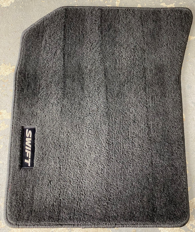

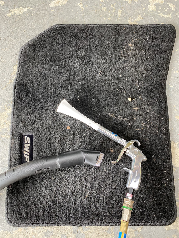

Got a chance to play with my new toy, ooops I mean tool, today. :D
My Tornador is driven by a 2.5hp compressor with 7.98 CFM.
It made short work of those mats and also helped with the drivers foot-well carpet. I also used it on the engine bay to spread some 303 into tight spaces.
Really glad I bought it and looking forward to using it more.
