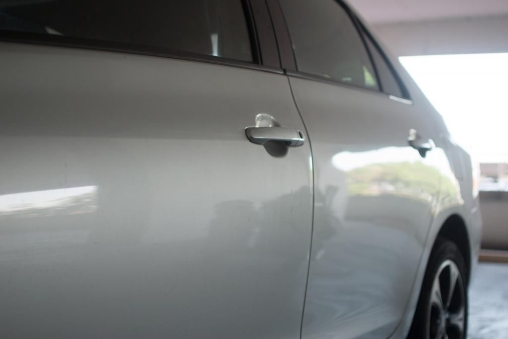

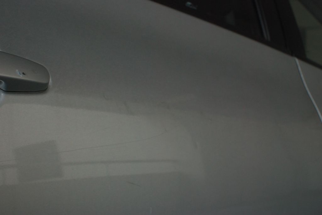

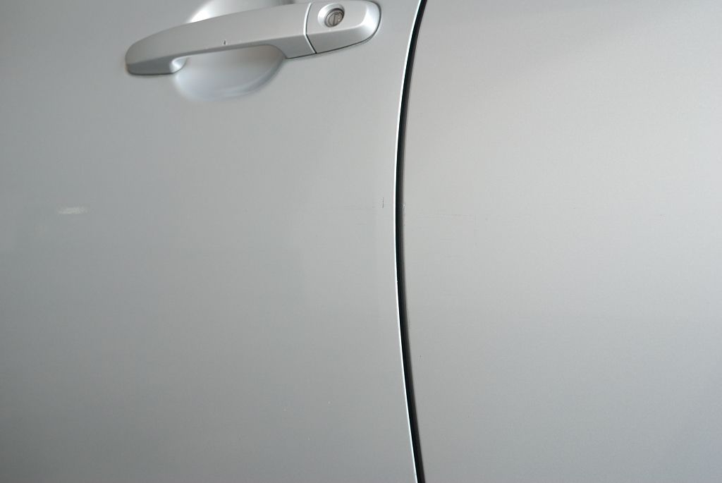

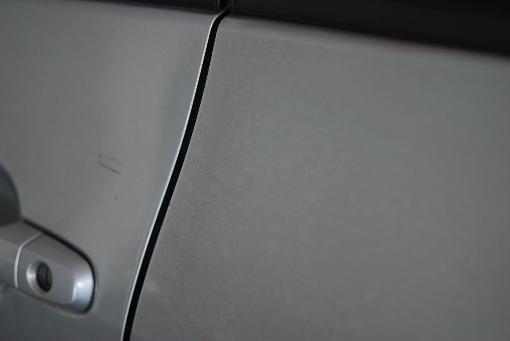

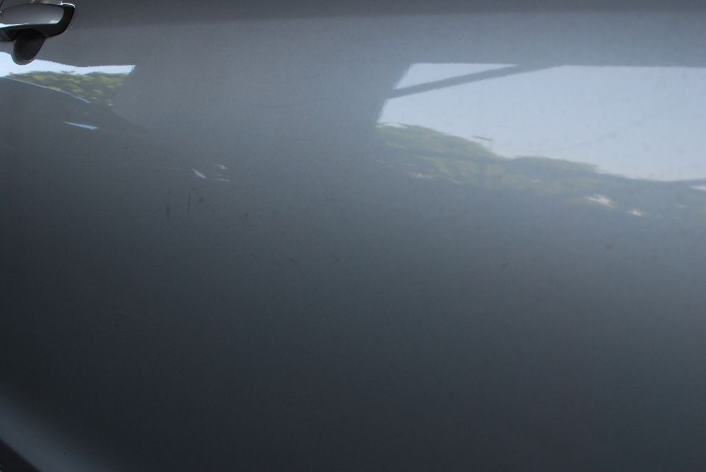

It was a nice lady with a very neglected car. 2yrs old car with a paintwork that is not in any way maintained, always park outdoors, no proper washing, etc... I could just go on, but let the pictures speak for themselves.

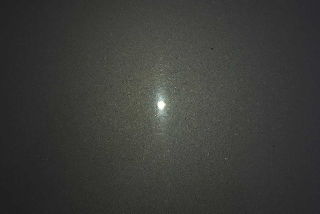

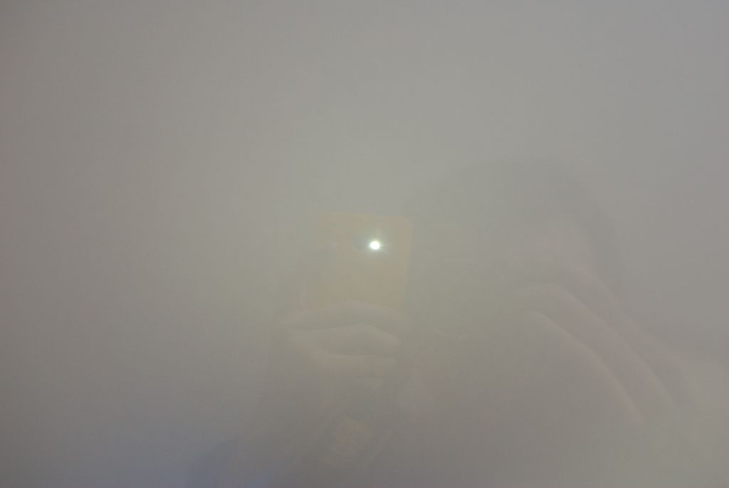

Swirled up like crazy! lost the nice gloss and the paint wasnt vibrant in any way.

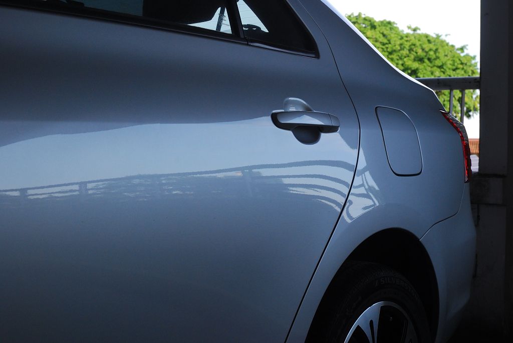

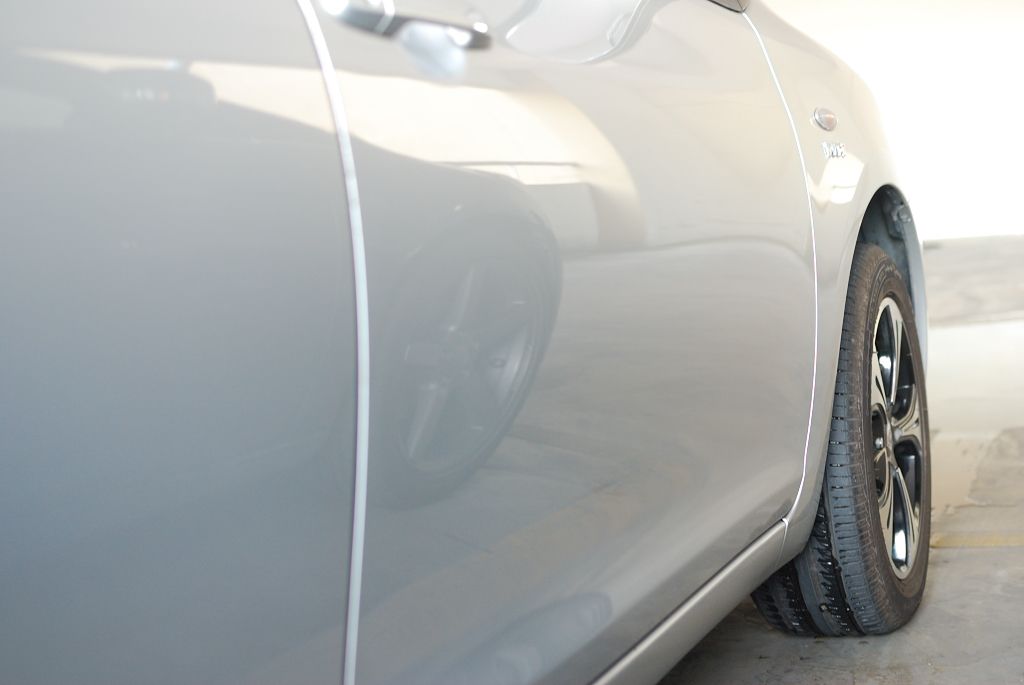

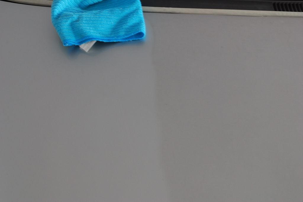

here we go! compounding 50/50

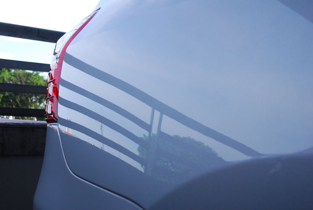

the end result of everything...

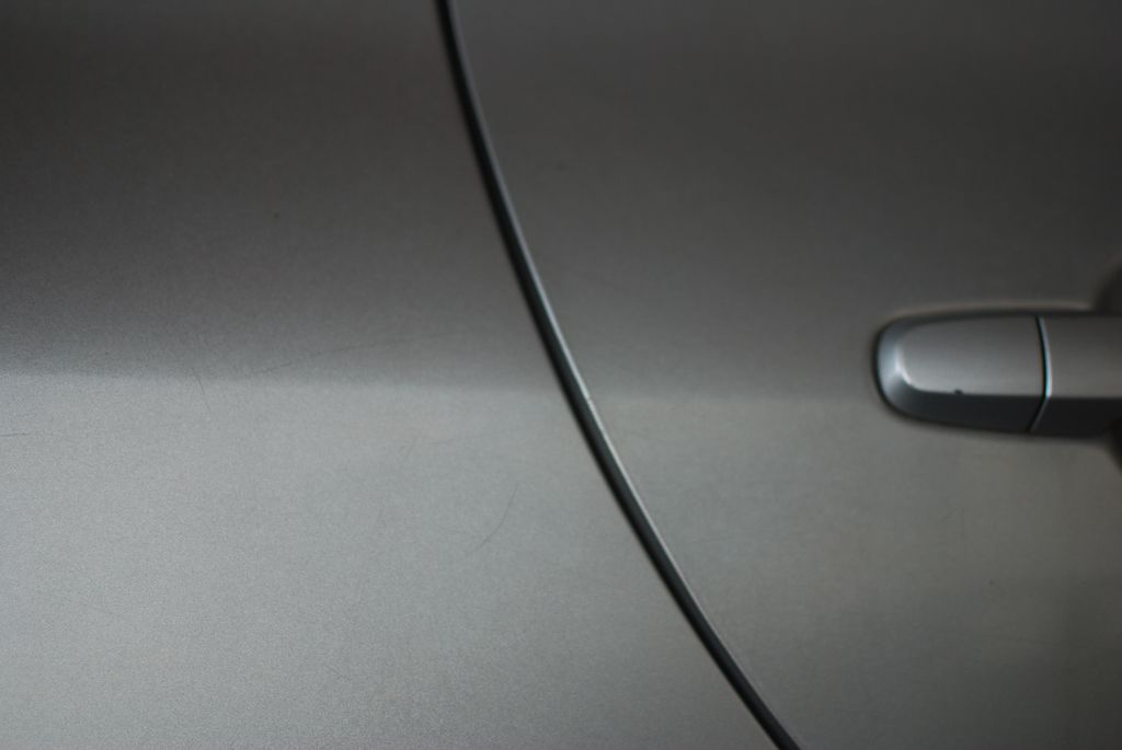

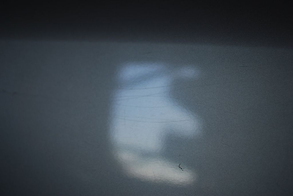

some RIDS that cant be removed. Looks like its under the primer passing thru the base coat.

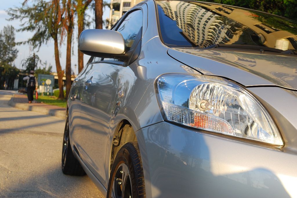

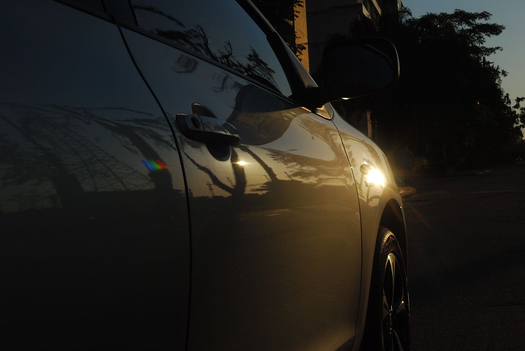

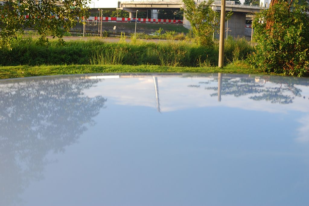

doesnt this makes every detailer happy?

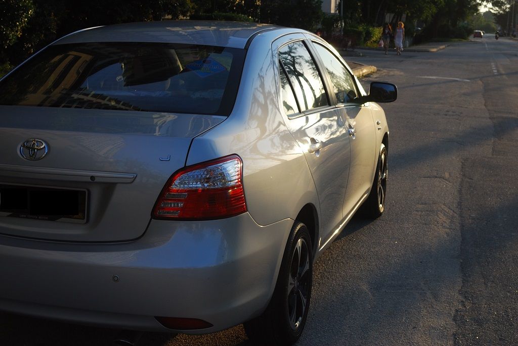

great sunset outdoor shot to end it all...
