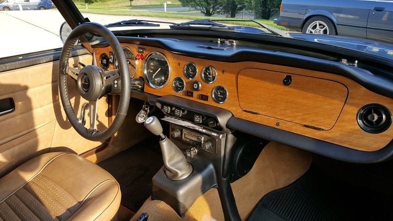

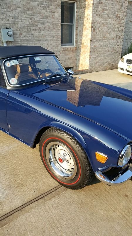

Another British car? I know. The British car club loves me, lol.
here's the breakdown:
Wheels: Sonax wheel cleaner plus, Iron X, Mothers chrome polish
Tires and Wells: Meg's APC, super degreaser, Dressed with optima ttgp
Paint: 2 bucket wash, car pro Aussie lambs wool mitt, Chem Guys Citrus Wash, Iron X w/ blue sponge
Polishing: Rupes 21, UHS system, 6 and 5 inch, finished perfect and didn't need to be refined any more.
Protection: Two coats of Opti-seal, one coat of Dodo Juice Supernatural
Interior: Megs APC on mats, Leatherique on leather bits.

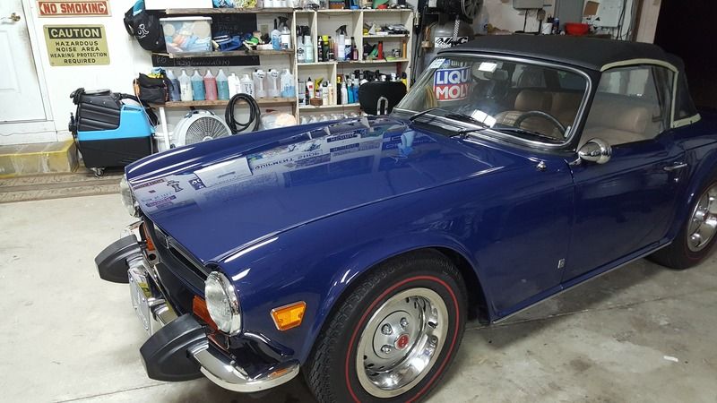

Before, looks pretty awesome already right?
Not so much

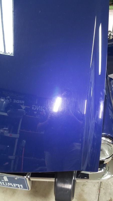

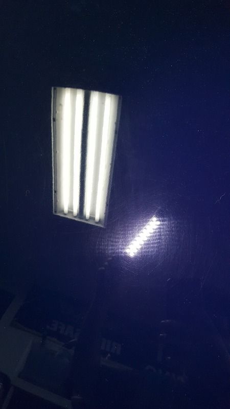

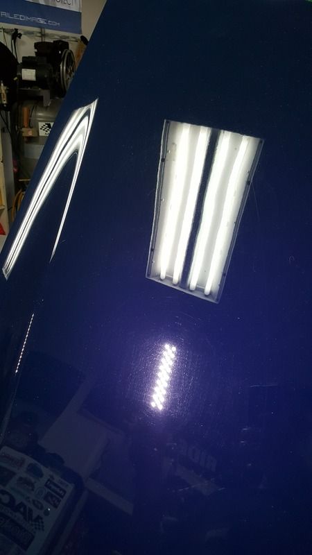

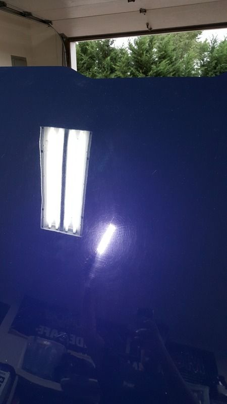

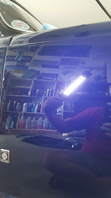

50/50

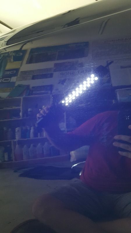

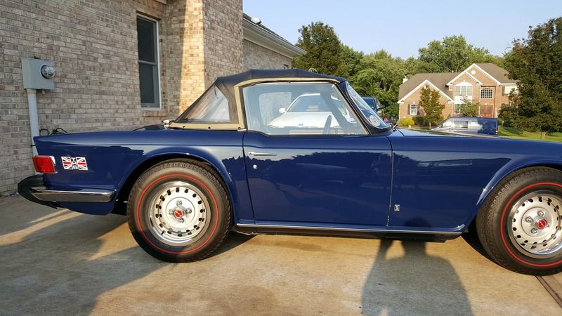

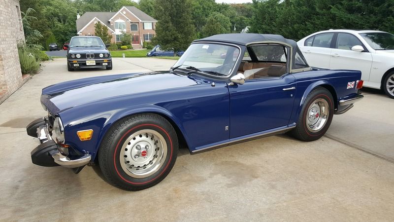

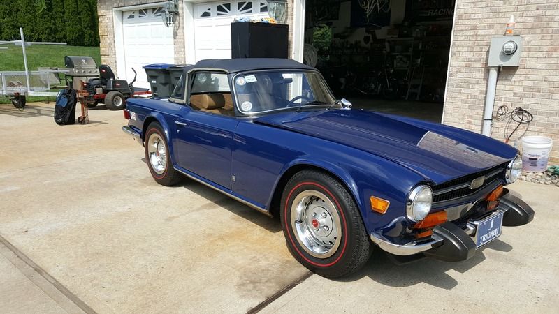

These curvy cars take forever to polish, after pics
The engine was also fully detailed by hand with Megs APC and microfiber towels. Painted areas were sealed with Opti-Seal. No pics, though.
Hope you enjoyed!
