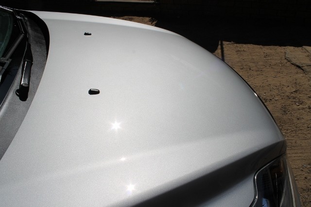

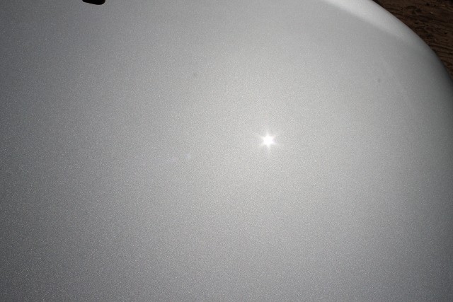

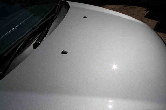

Certain areas of hood does have clear coat failure but i will post picture later as vehicle is not mine.

The only honest repair for a car with clearcoat failure is to repaint the car or the affected panel.
Be careful when detailing cars for money and a customer brings you a car with clearcoat failure. If some areas are failing it's just a matter of time before the rest of the paint goes bad. At least on the horizontal panels.
IF this if for a friend that's one thing, if this is for a customer next time consider explaining to the customer the paint job is too far gone to safe and turn down the job.
I cover paint condition categories in my how-to book and also in this article
Paint Condition Categories
You're working on paint in categories #10 and #11
:dunno:
You don't have a problem with your rotary and wool pad, that paint is beyond what any product or process can do, short of refinishing.
Bringing that paint back to life with polishes is the equivalent of fixing a spun rod bearing with an oil additive.
Chalk this one up as a learning experience.
