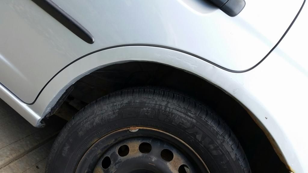

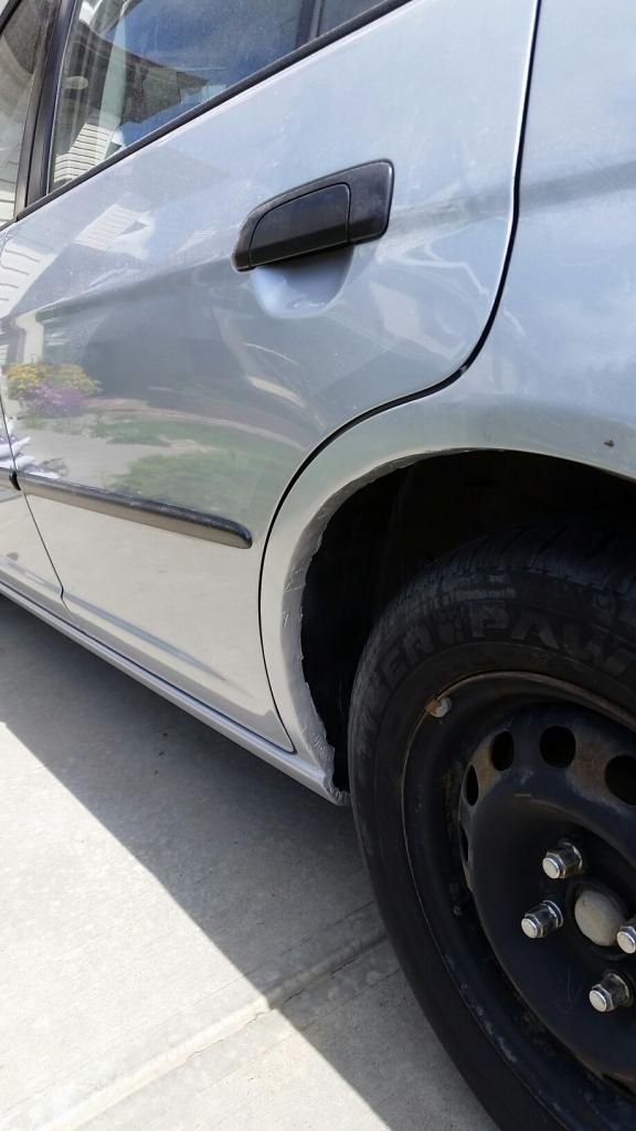

Hey all, this is my 2001 Honda Civic. This is my first time ever fixing rust and using Bondo. Rust was at wheel well area. So let me know how I did.

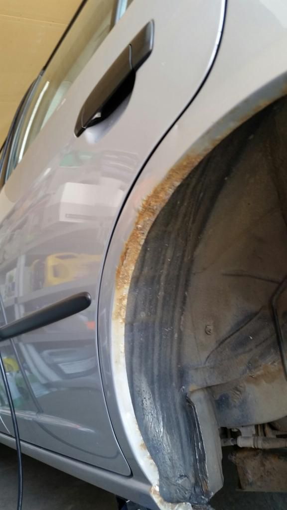

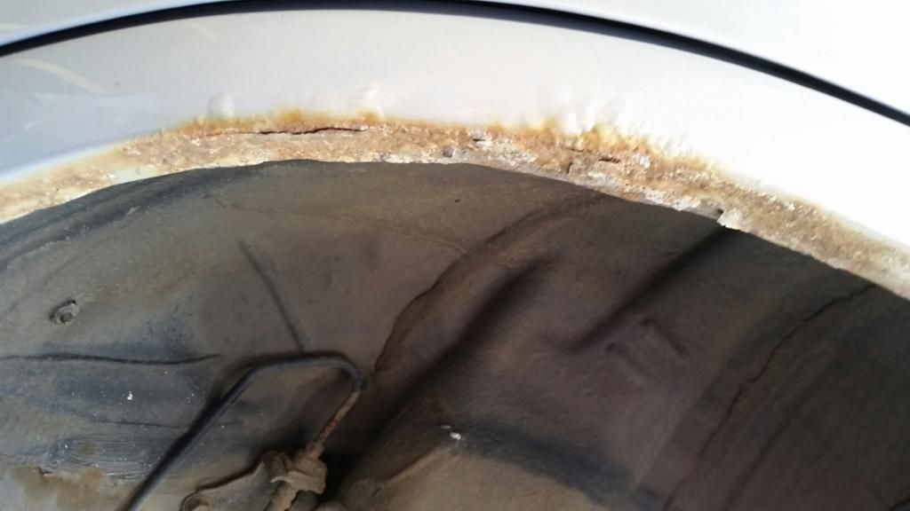

First step is to use sand disc to sand off the rust back to bare metal.

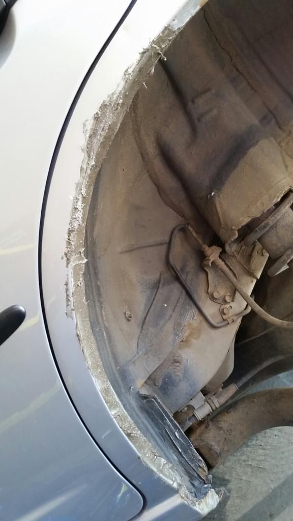

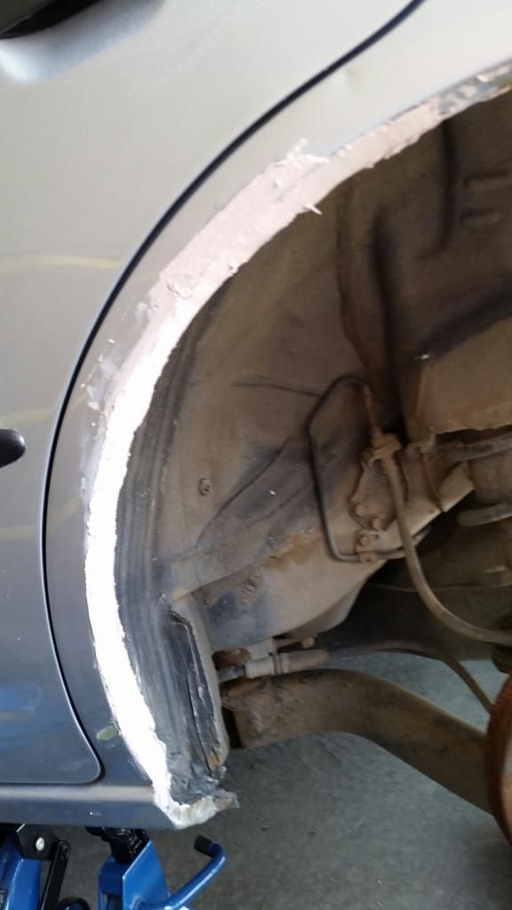

Second steps, using Bondo Glass Filler to fill in, then Bondo Body Filler.

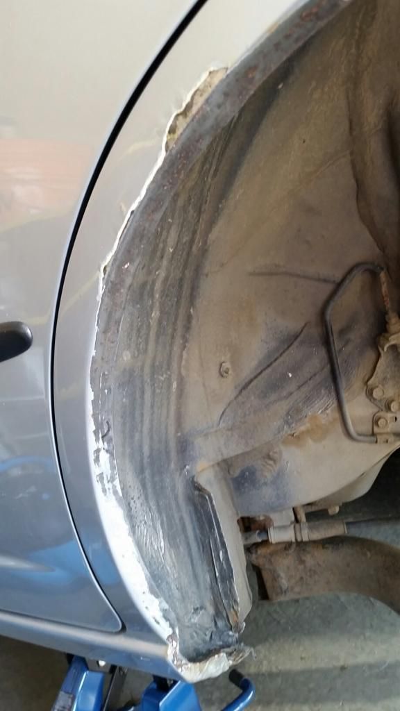

Third steps is to sand off everything and try my best level it out.
Fourth steps is use Primer then paint-matched.
I am not going to lie, I think I could have do a better job sanding it and smoothing everything out.
I will most likely redo it
check it out. And let me know what you guys think
