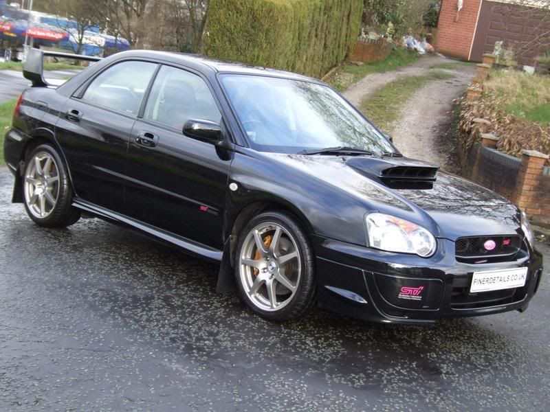

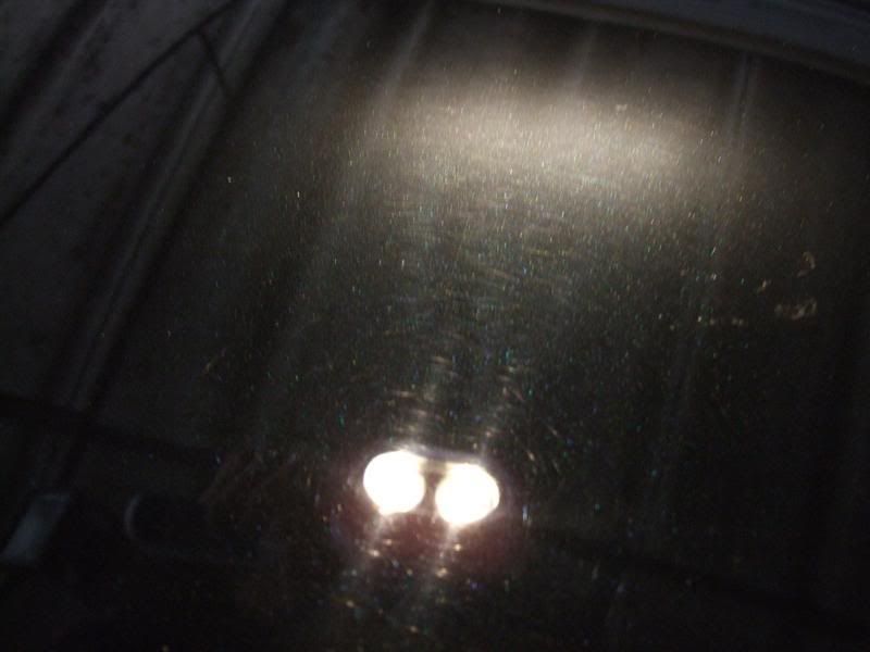

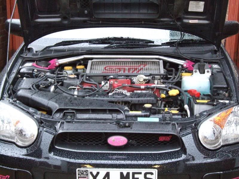

No before pics I'm afraid as it was absolutely teaming it down, so only before pic is the engine shot, with me hiding under the cover of the garage door to take this:
First job was the pre-soak with DP Xtreme Foam, a rinse, then a second soak. This was then followed with a one bucket rinse wash, including alloys inside and fronts.
Next was Optimum Poly Clay, to remove the surface contamination. Another soak and rinse before drying with a Cobra Guzzler. The car was then moved into the garage, taped with 3m, and the Paint Depth Readings taken. The car was showing a good average of 120 mcrons, with the occasional drop to 90 in specific areas.

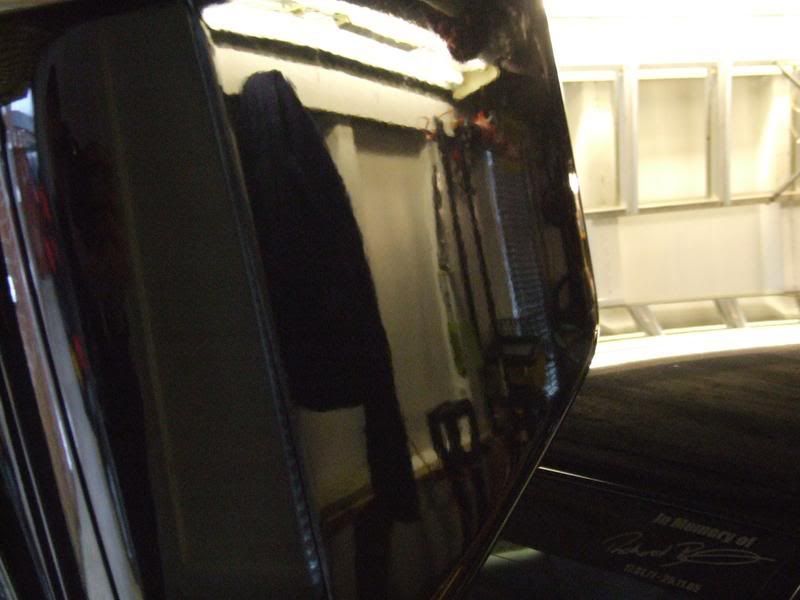

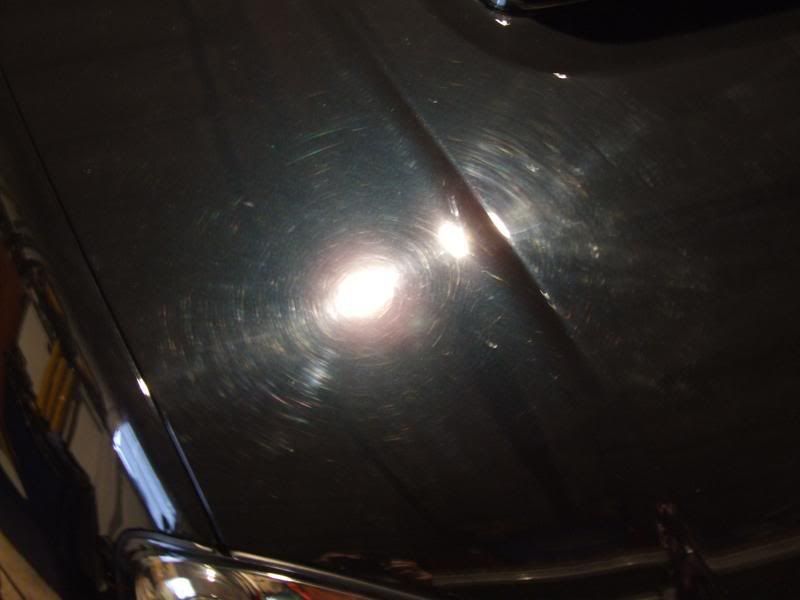

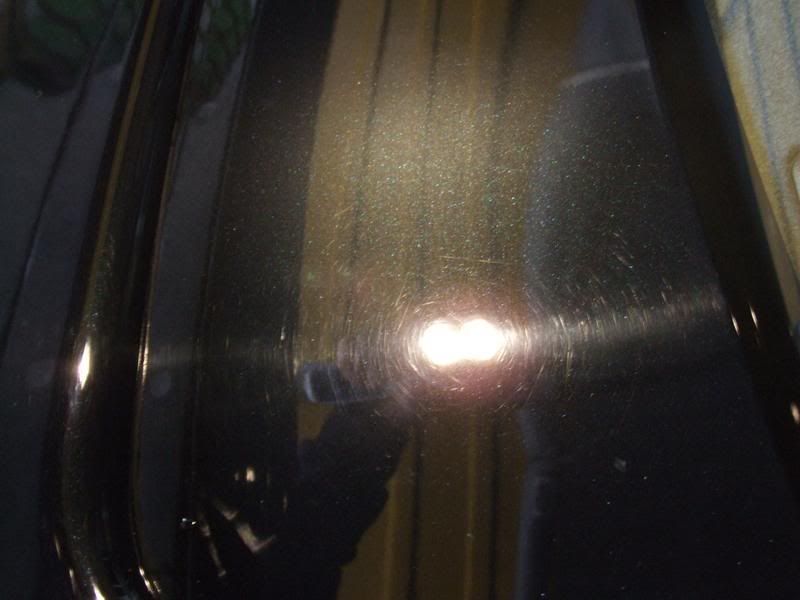

Next was the swirl assessing:
First p[art of the de-swirling, the porter cable, four inch pads:

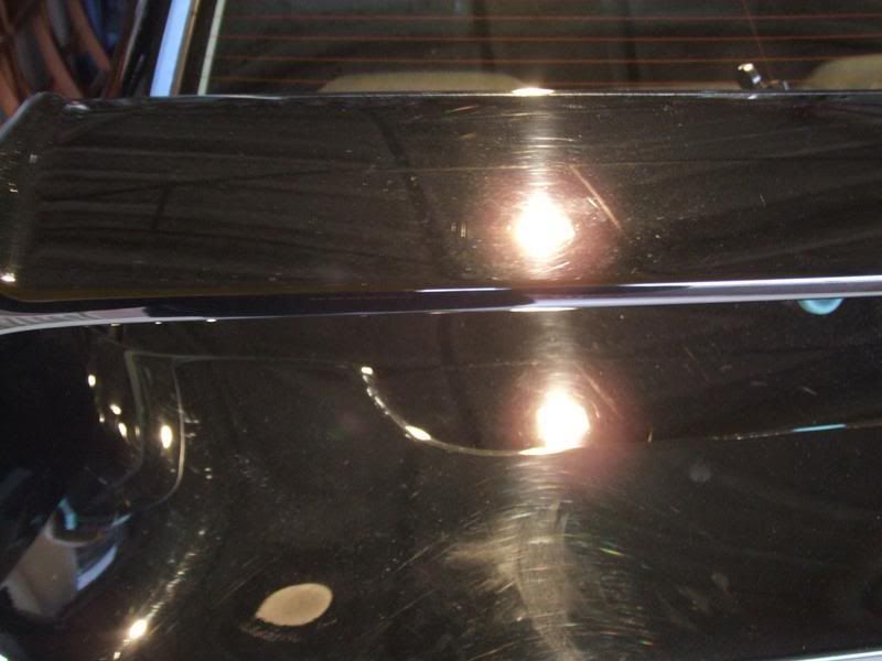

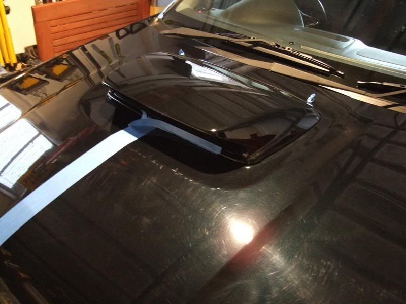

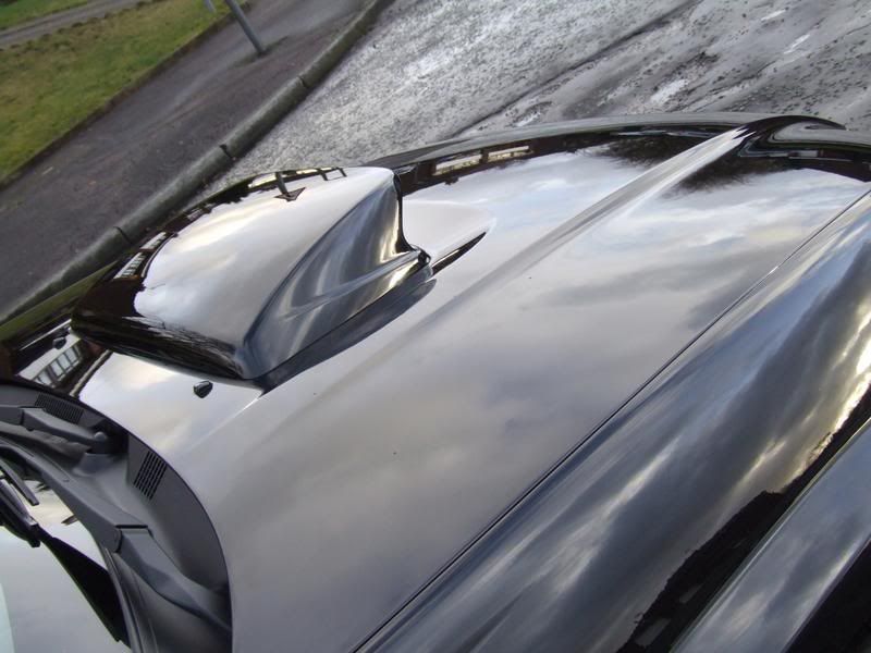

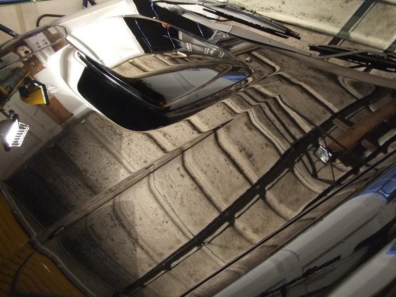

After completing the three stages on the plastics heres what the scoop looked like aginst the untouched bonnet

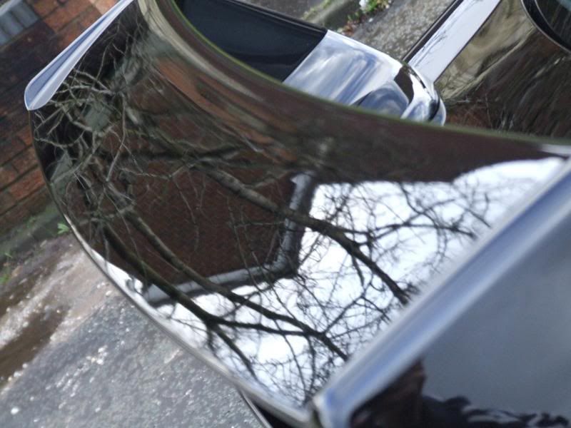

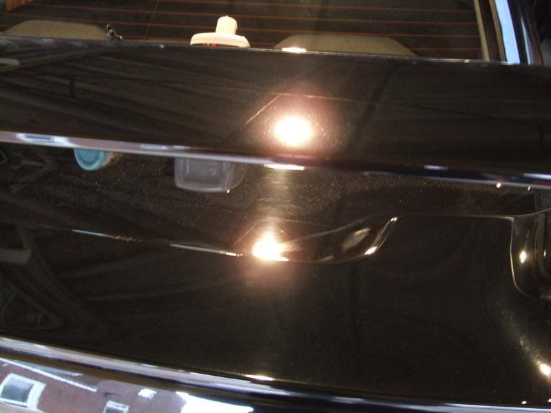

before on the rear spoiler:
and after:

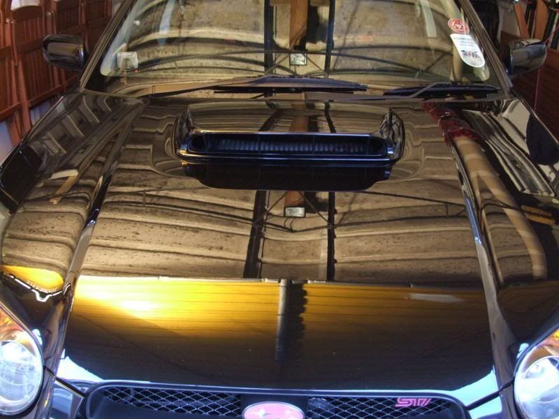

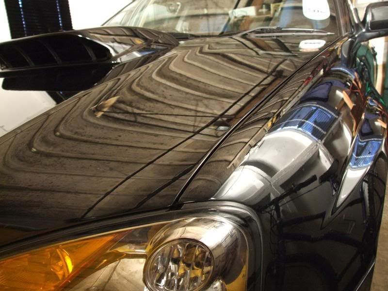

The main panels were all done using the rotary, a polishing pad and Pinnacle Advanced Finishing polish.

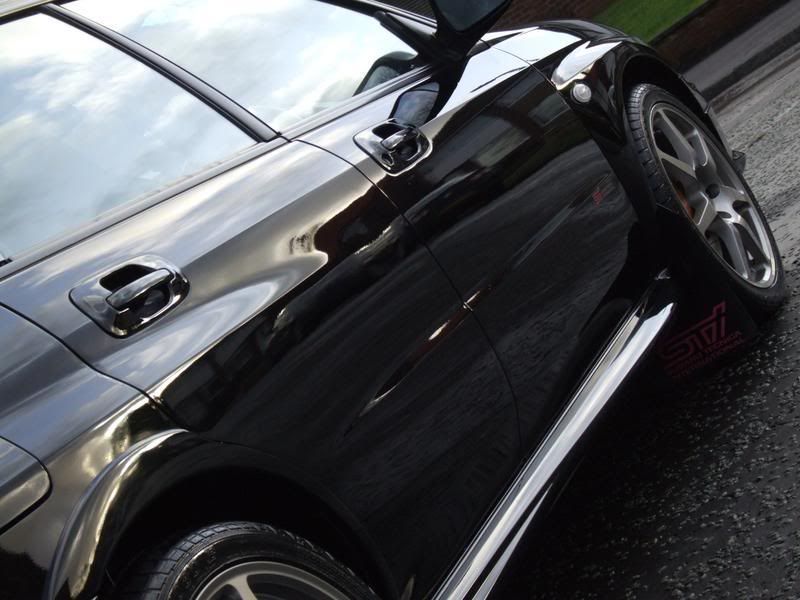

This was followed with the PC, a finishing pad and Klasse AIO. The Klasse was then topped with Swissol Best of Show Wax.

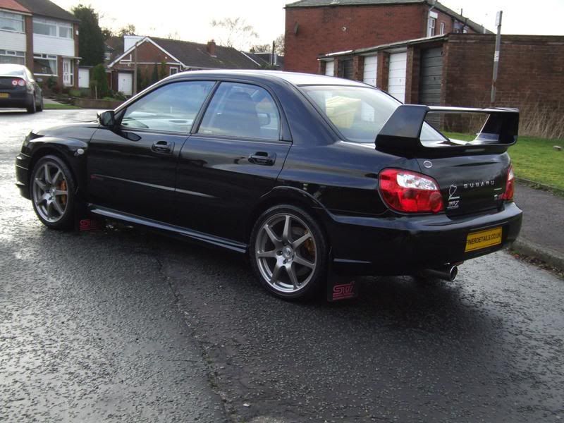

Alloys layered with Poli Seal, tyres with Pinnacle Black Onyx tire Gel, Arches-Engine Bay and Mud flaps with Poorboys Bold N Brite. Exhaust with Autosol, and glass with Stoners Invisible Glass.

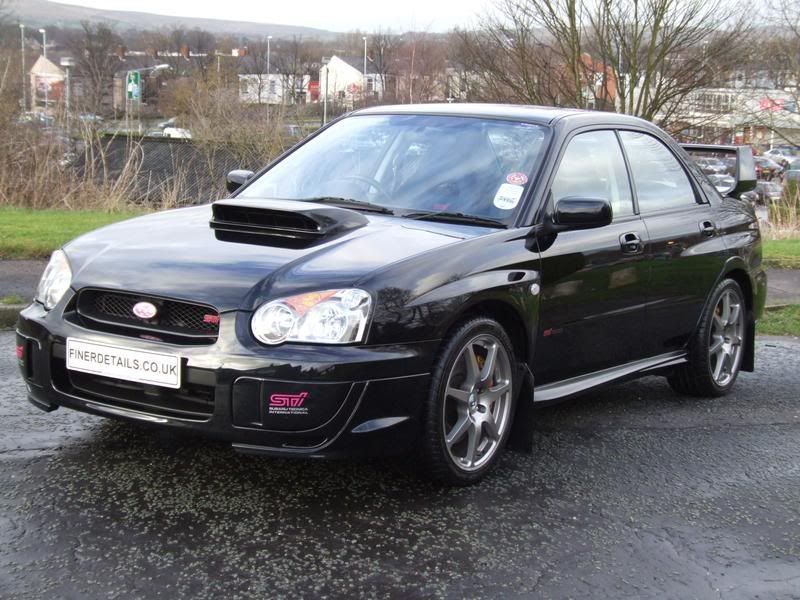

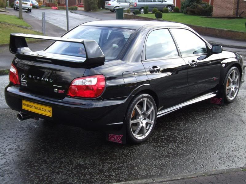

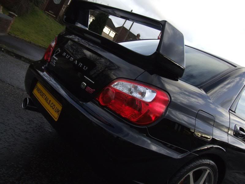

Just made it in time for some late afternoon daylight:

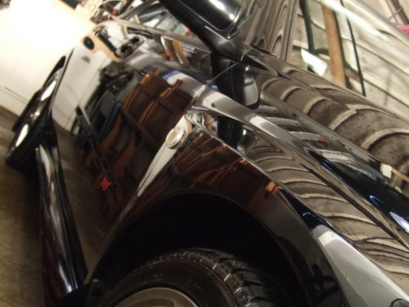

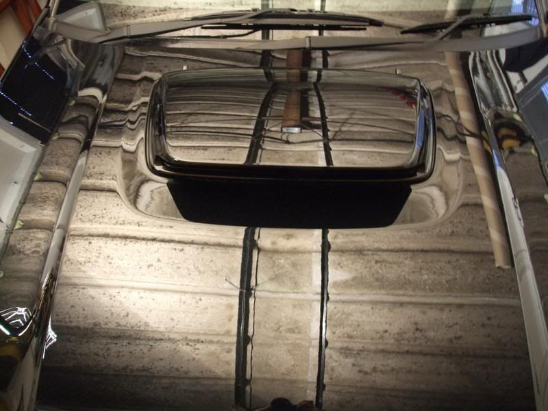

and back in the garage some arty shots:
