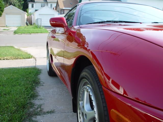

wait a minute here. are you saying the least aggressive combo was orange pad and Optimum Hyper Compound? that is a pretty aggressive combo then you add the Flex. you maybe going to aggressive and start alot lighter. and was this done on the Supra or the Acura? my step dad has a 94 TT and it was easy to remove his swirls. even if it was a repaint and the shop is as good as you said they are then they should have used used the same paint and procedures as the original paint
these results with 3M ultra fina se Dewalt rotary and 3M grey finishing pad

The pics you posted of your dad's Supra looks awesome.
