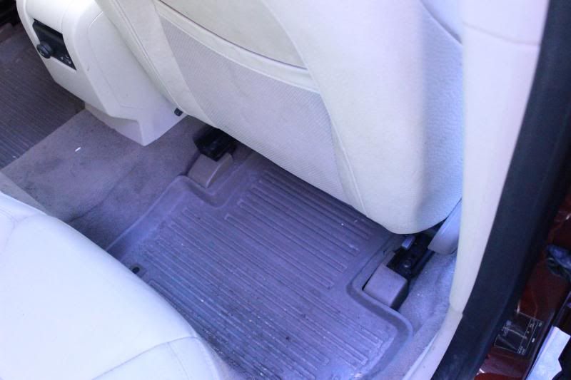

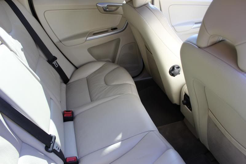

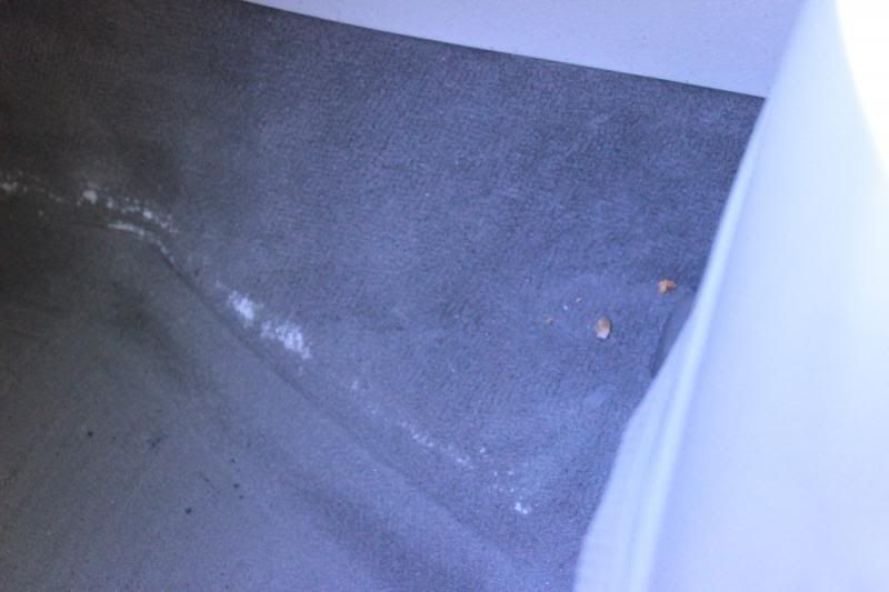

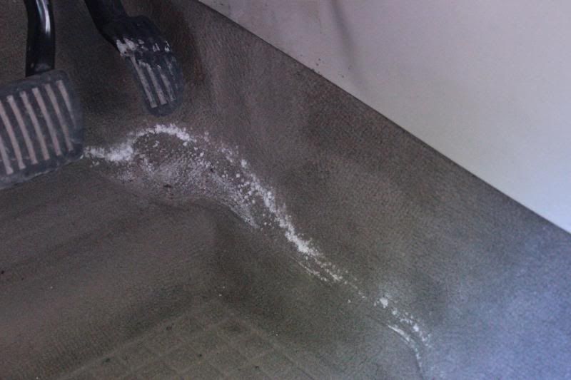

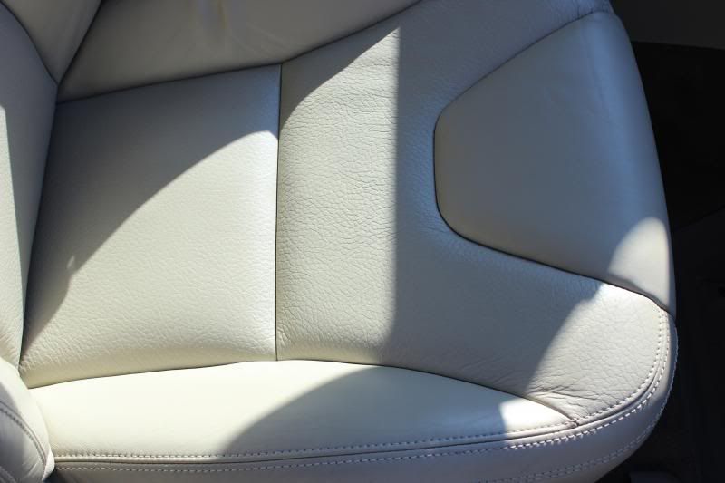

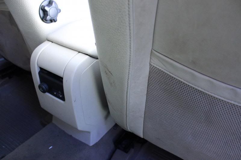

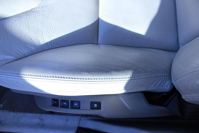

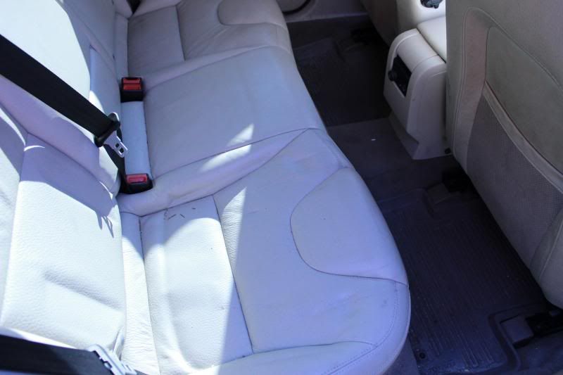

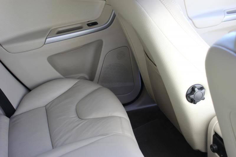

Owner contacted me and we discussed possible options and ended up deciding on a complete interior restoration plus a single step exterior polish. I polished one of these last year in the exact same colour so I pretty much knew what to expect when it came to paint correction.

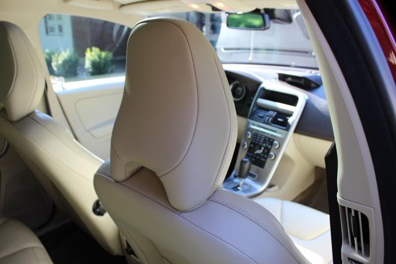

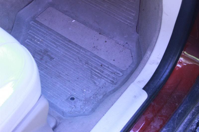

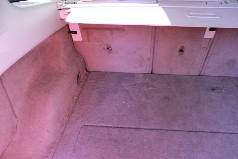

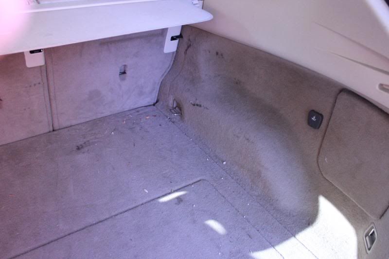

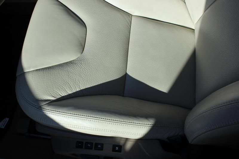

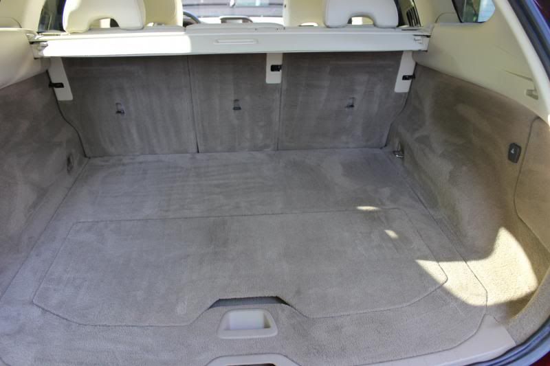

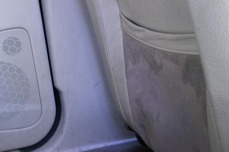

Interior

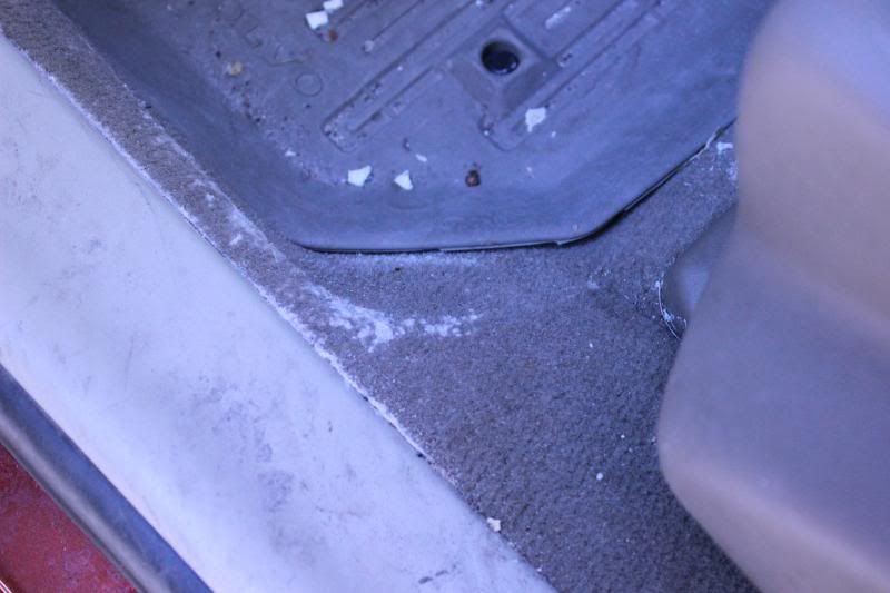

I love tan/white coloured interiors but I'm not sure I'd ever own one in a vehicle that's driven year round. You can see from the pics that not one surface escaped from getting dirty however I was really surprised on how easily every stain came out even the bicycle grease stains in the back. Volvo does you some real quality material in their interiors.
Products used
Dupray Hill Injection Steamer
Folex
Poor boys Natural Look Dressing
Stoners Glass and KD Cloth
OPC
Optimum Leather Protectant
Before
After

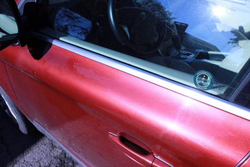

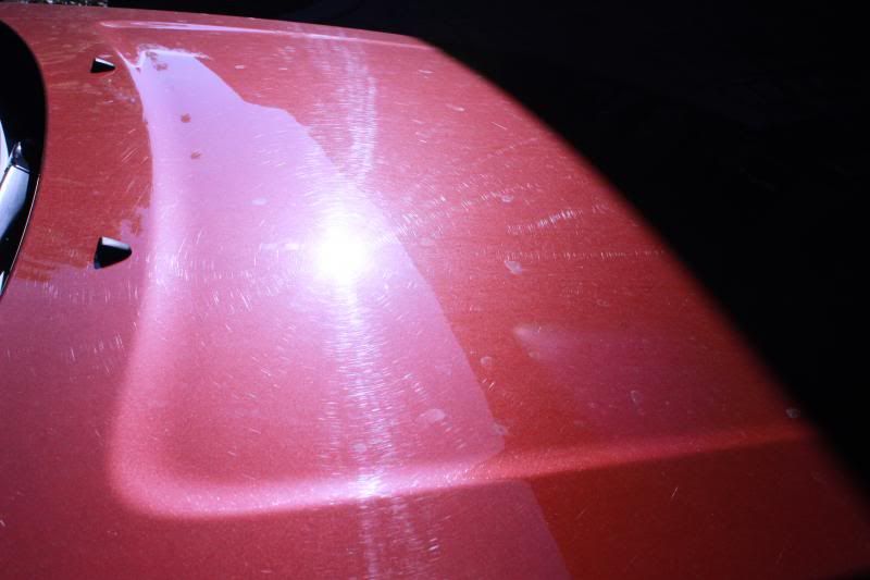

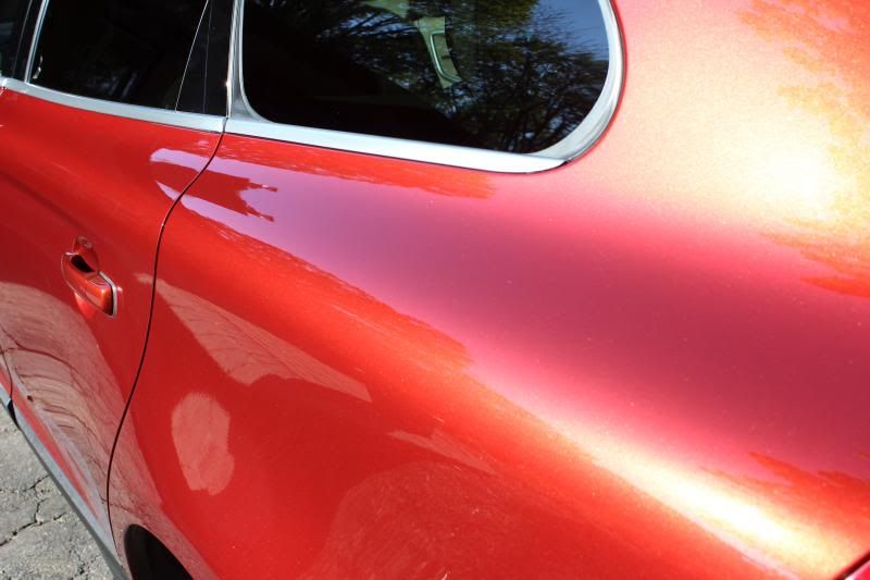

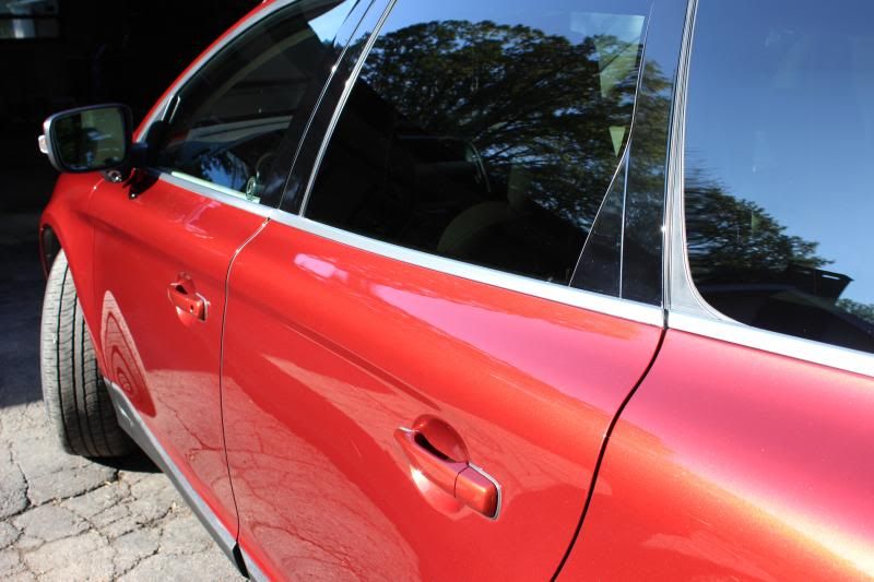

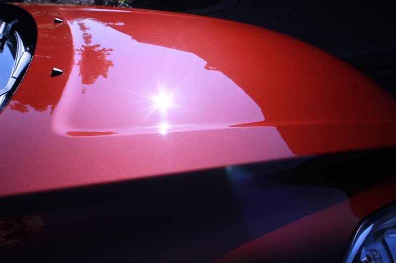

Exterior
This is where the surprise came, even though I had done the exact same model and colour last year the clear on this one was not giving up anything. Even with tuff buff wool pads and M101 I was barely making any progress, I decided to wet sand many panels and while it certainly took care of the issue I did go over in time. (out of my pocket) but there was no way I would let him pick it up without having done so.
Products used
Flex 3401
Tuff Buff black wool pads
M101
SF4500
Collinite 845
I wish I had taken more photos during the process but I knew I was already going over in time right from the first panel.
Before
After

He picked it up with his pedal bike and I could tell he cringed putting it back in there after he saw that all the grease stains were removed lol.
