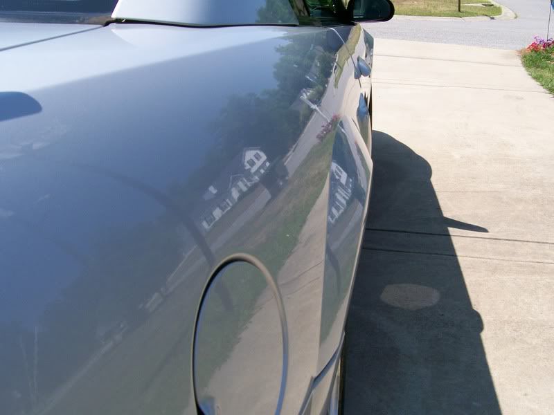

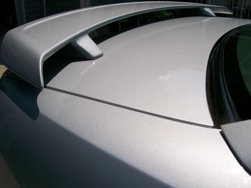

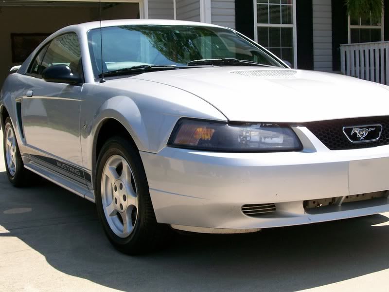

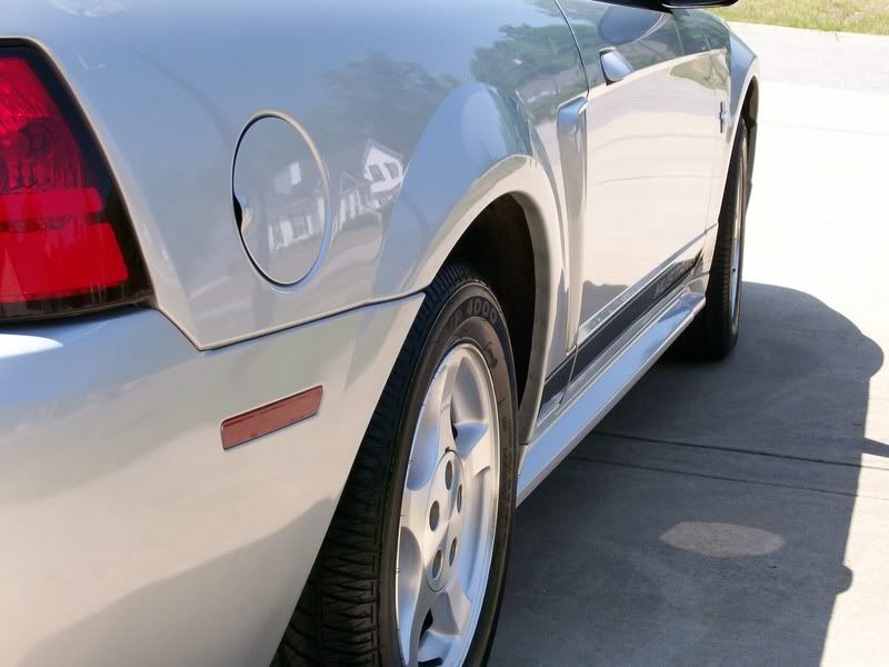

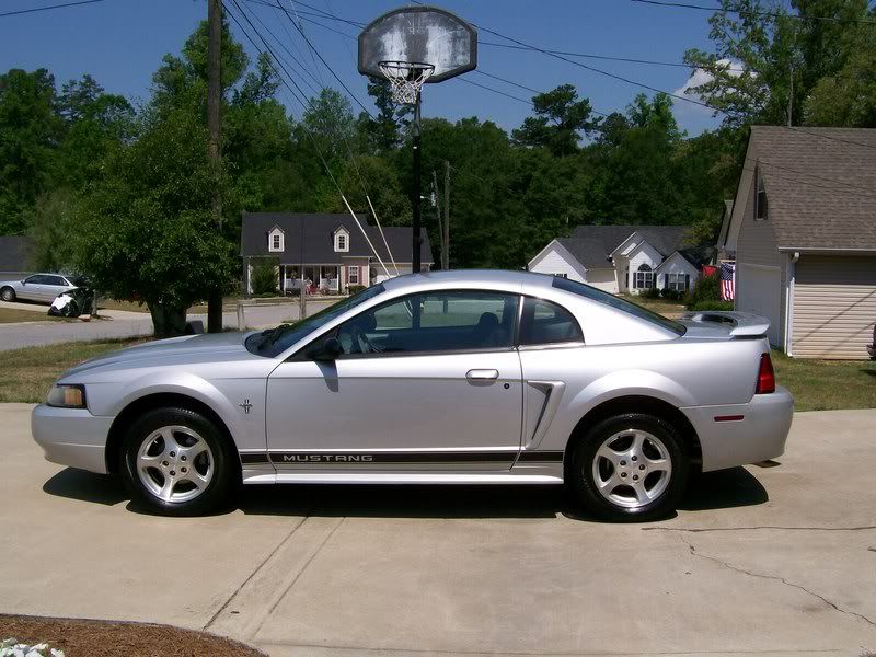

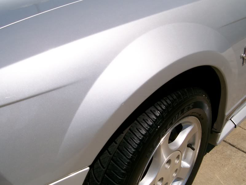

Today was suppose to be a 2 car day with the first being a 07 Nissan Sentra (Black).. With a cancellation and this car on the waiting list I decided to give them a quick call.
We have a watering ban state wide and I've already recieved a warning, so I'm pretty much taking it easy and have developed a decent plan.
9:00am
Picked up vehicle and drove straight to the in-bay spray wash and hit the wheels, wells, and tires with "the brown stuff" and then quickly degreased the rocker panels, bumpers, and windshield with PB Bugsquash and AWESOME CD.
9:30am
I roll into the driveway and already had my DP 4in1 Rinseless setup. I took the top and sides and worked my way around the car in the garage. I then dried with QD and a MF towel.
9:50am
I cranked up the PC with a orange 5.5 cutting pad w/ XMT360. I worked my way from top to bottom and around the vehicle before finally closing out @ the rear bumper. I then sprayed the entire car with QD and wipe any residue that remained.
10:30
I pulled the car outside to check it for any missed spots and then pulled it back in to OPTI-SEAL it. I applied this with a WG Applicator on the gray side. 1-2 spritzes per side and I was done. There was no residue nor blotchiness or over application.
10:45
I backed the car outside and dressed the wells with AA Tire Foam and tires with MEGS HE Gel.
11:00
I had one last step "The Windows." I went inside washed my hands and pulled out some SIG and went to town with a WW MF.
11:10
Double checked my work and off back to the customer.
$85.00
No Befores, sorry it wasn't to bad but the headlights are going to be swapped in 3 days so no flaming for not fixing
