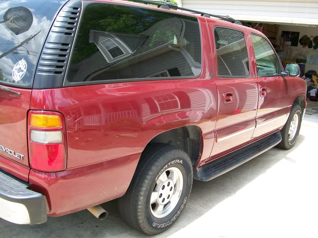

BEFORES

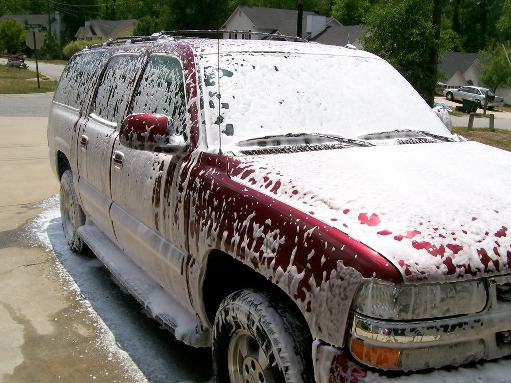

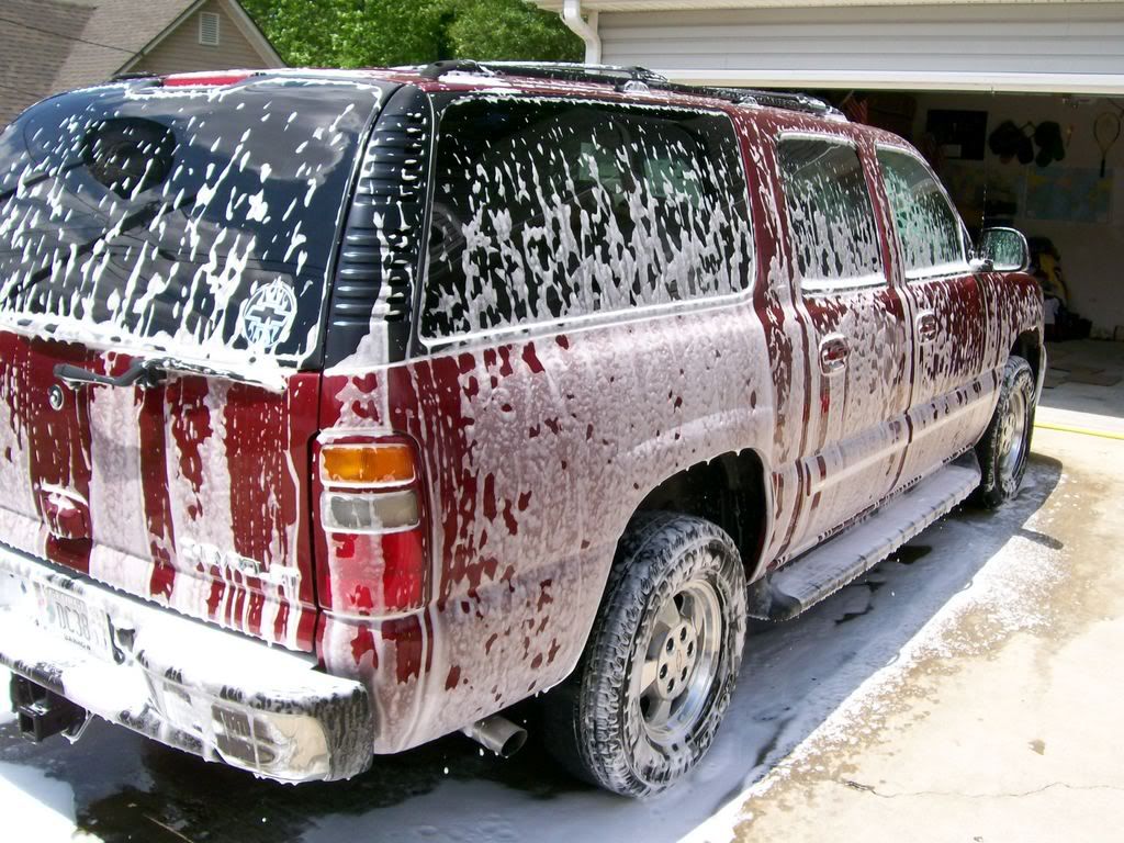

DURING
Notice the drying agent working. Sure is helping me out :)

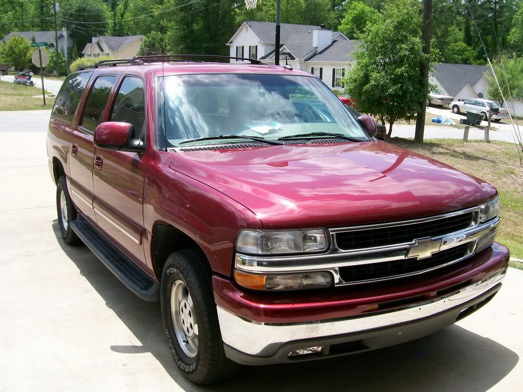

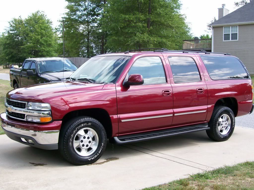

AFTERS
It's all over and off to get some supper :)

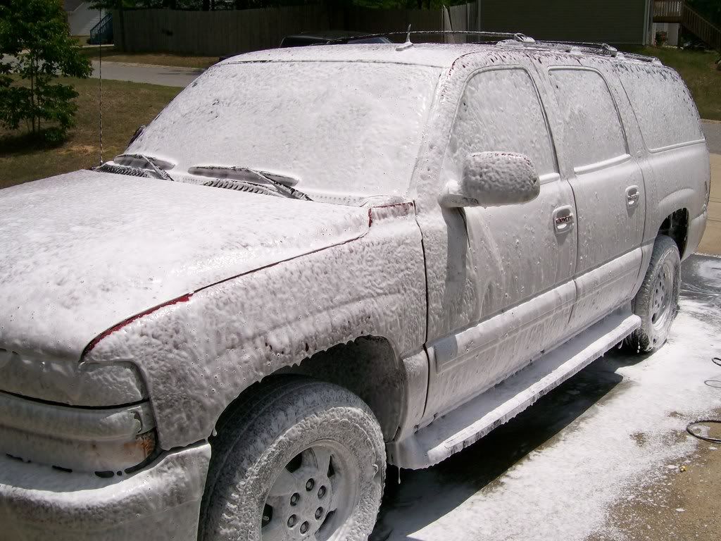

So are you seriously not even washing these cars? Does the extreme SNOWSTORM of foam just "wash" the car for you?
Yeah im lost on the washing, there is no way its clean without actually touching it.
Yea me three, please explain becuase that just sounds to good to be true...but if it is true man I'm getting one...sweet.

Same principals as a rinseless wash. Chemicals do the work and then the final drying takes care of the rest. I've been doing it for weeks now. My clients love it and so do I.
This is just after foaming and then rinsing..........nothing has touched the surface other than water and chemicals.
