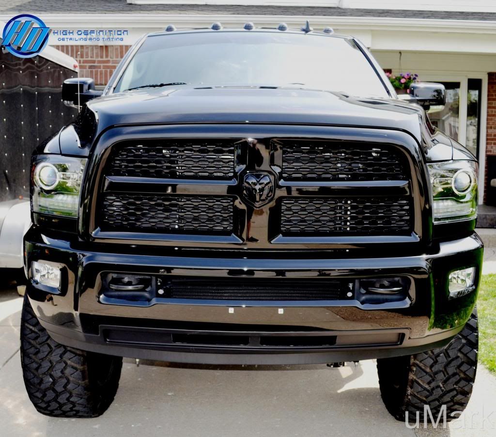

I have a customer that has the biggest truck I.ve ever worked on and black.
He loves my detailing and calls me every 2 weeks to wash this beast, pays very well too!
I recently buffed this a truck and applied 22ple VX1 Pro. I find when washing this particular vehicle that No rinse on the roof and hood work best and then traditional wash and dry sections around the truck. The tonneau cover his huge too, haha. I start washing between 630-7am as to beet the sun.
I have to stand on a ladder very top and stretch to try and reach the middle of the roof. I'm about 6 feet tall and my head is shorter than the hood of this thing.
I also bring my own water as his water is hard. I cannot keep the entire truck wet at all times while washing. Which is why sections work best.
Pics

That is a massive truck, we don't have anything that big here in the UK!!
And that's a good thing too considering gas prices in Europe are so high. This thing must drink a lot of gas ;)
That's 'cause this is 'Merica, you friggen Redcoat! We colonials like it that way!
(Obviously I'm biased about what environmental impact our cars have, but that truck as a detailed automobile does look very cool.)
