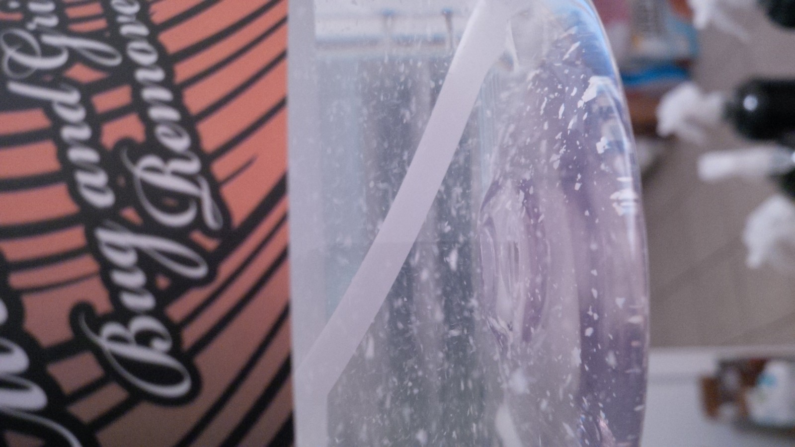

View attachment 55469View attachment 55470View attachment 55471View attachment 55472View attachment 55473View attachment 55474View attachment 55475View attachment 55476View attachment 55477View attachment 55478
Sorry pictures aren't that great and products sideways ��
I have used so far on the transparent top for my 2014 Corvette Coupe: carpro Iron X LS, Optimum MDR, CarPro Eraser Intensive Oil and Polish Cleaner, Glass cleaning Clay from Griots with Stoner Invisible Glass - glass cleaner. None of these products have made a difference on the hard water etched deposits on the transparent top. I have ordered additional products to try to solve this problem and when they come in, I will use them next on this transparent top.
View attachment 55481View attachment 55482I found this product outside with my other detailing supplies so I tried it also on the etching spots on my transparent top. Word to the wise ..don't spray Plexus Plastic cleaner Protectant and Polish in your house, like I did. My dogs and I started coughing and choking from breathing in the fumes from the aerosol spray. This product didn't work either on the hard water mineral deposits/etchings on my transparent top either.
View attachment 55484View attachment 55485View attachment 55487
Well also found CarPro spotless in garage and tried it to..nothing changed 😞 Also used Driven glass cleaner and made things worse imo. Now I really will have to wait on new order of products from Autogeek to see if the new products can correct this etching problem even a little bit, as everything else I have tried thus far has failed.
